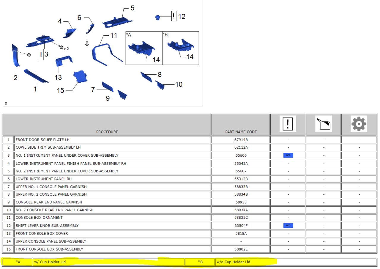

    the repair manual shows them both, but doesn't give a part # for them, i want to say there is like maybe 2 pieces that need to be changed if switching between the 2 different cup holders
    i think the best bet would to be ask @Roman the parts master, i looked on the parts.toyota site, but it has broken images and can't see those pieces in the image that is viewable

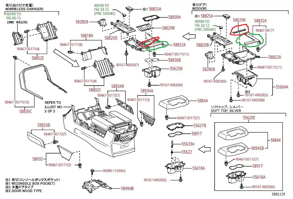

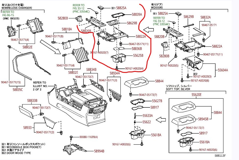

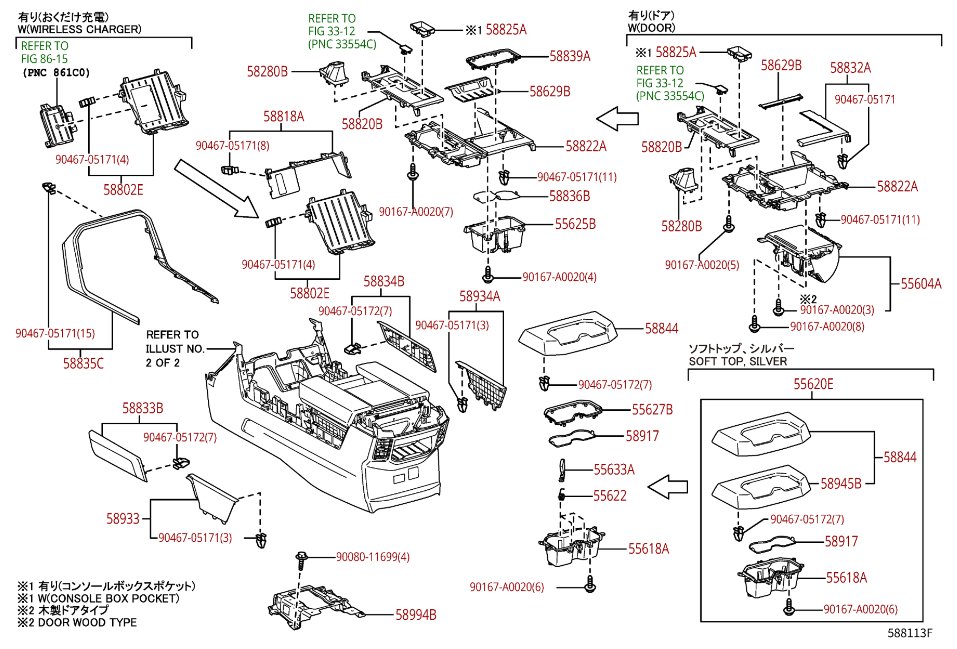

    Here's a little better image of the differences:
    I would think almost everything there would have to be changed out, and even then I'm not sure it would work.

    Man, that sucks. I can't really make heads nor tails from the diagram, but I'll take your word for it - thanks!

    I think this what we need to switch out to make the cup holder a side by side.It look likes it just need a few parts. Next question is how to get the parts and how hard would it be to swap out is the next question

    @Roman,
    Are you able to see pricing on the pieces that are needed for the swap?
    looks like the following pieces are needed, and the bolts and clip could be reused from the one being taken out, with 1 bolt left over
    58839A
    58629B
    58822A
    58836B
    55625B

    from what i can tell you need :
    58280b
    58820b
    33554c
    58825a
    58839a
    58629b
    58822a
    58836b
    55625b
    90467-05171 (11 pieces)
    90167-a0020 (11 pieces)
    edit : the above pieces i am not sure what is not needed since you dont actually need all those listed above
    and the side by side section parts from 55620E (side by side parts breakout)
    58844
    58945b
    58917
    55618a
    90467-05171 (7 pieces)
    90167-a0020 (6 pieces)
    from that listing i dont think thats going to be around $175
    edit :
    yeah this is confusing as heck on what is needed and what existing stuff is re-use or adjusted.

    58280B, 33554C, 58825A and the clips/screws are all the same between the different models. 58820B is a maybe, though they appear to be the same size/shape in the image. 55620E is the back of the console.

    after walking away and coming back...
    58822A is a re-use item so i dont think you need to order a new one. its in the break out of the top/bottom break out and the side by side break out next to it. (the bottom pics are for those that already have the side by side and if you need to order new parts)
    on the A0020 inserts, you go from 13 down to 11
    on the 05171 inserts, you go from 12 down to 11
  19. Jun 15, 2022 at 10:14 AM
    Brums
    Brums New Member
    Apr 24, 2022
    #77540
    415
    Bethel, OH
    22 Tundra DC TRD Sport
    58280b - shifter boot -swap over
    58820b - gear selector cover -swap over
    33554c - i dont see this part # on that picture roman sent
    58825a - if you have anything other than an SR, you will have the mode switch there
    58839a - needed
    58629b - needed
    58822a - needed
    58836b - needed
    55625b - needed
    you shouldnt need the screws/bolts, just remove/reuse from the one coming out
    SR Trim - has the coin holder
    SR5 Trim
    SR5 2wd

    JR
    i dont think you need 58822a since its already exists in the top/bottom parts break out.
  22. Jun 15, 2022 at 10:27 AM
    Brums
    Brums New Member
    Apr 24, 2022
    #77540
    415
    Bethel, OH

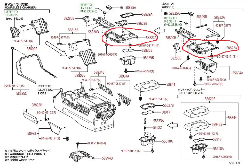

    im about 95% sure that 58822A is different for the cup holders
    this one has the bar going across
    this one does not
    @Roman can you verify there are 2 different part #'s for 58822A ?

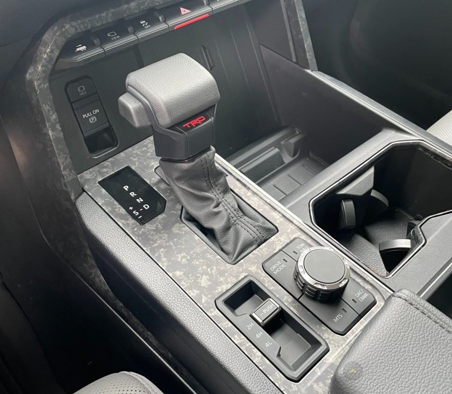

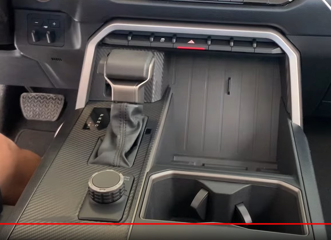

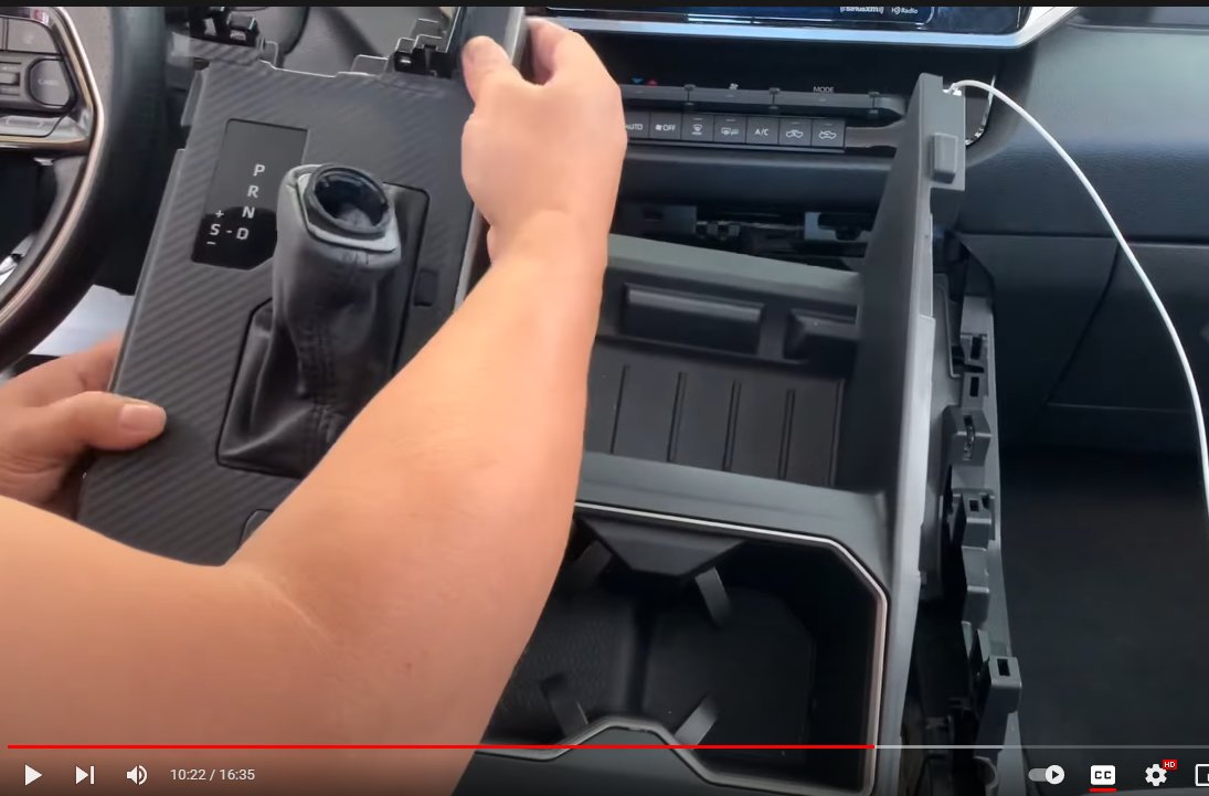

    Can someone post a picture of the front back version? I have the side to side version and I am interested to see the difference. I have a 2022 limited, I might be open to a swap

    My wife's XT5 has a cover that covers the cupholders..
    You 2022 guys really have it rough man..:(

    Is the color on that black?

    i think you are confusing the break out views. i think the angle of the picture is throwing you off and it looks like a flat piece is there on the right side vs the left side pic and not showing the full depth of the cup
    the green piece is shown as break out on right side pic and installed on left side break out

    i don't think that i am, the SR5 doesn't have that huge L shaped trim piece, you can see it in the photos above
    look at the edges between the 2, the side by side has a right side finished edge, where as the front back has the edge for snapping down that L shaped trim

    we can see for sure, if you feel like yanking the L shaped trim off your truck?
    does the edge look like this?
