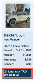

    funny was just going to DM you and ask. Found the photos, any chance you remember what fuses they were? My Seqouia fuse bank looks very different from my 19 tundra and wondering what if there are differences between your tundra and the Seqouia- I have lots of blank spots for air ride and other crap.
    weird, just updated my sig again. Have done it a few times and it keeps reverting back

    your sig was right, but your vehicle badge was goofy.
    Looks right now though
