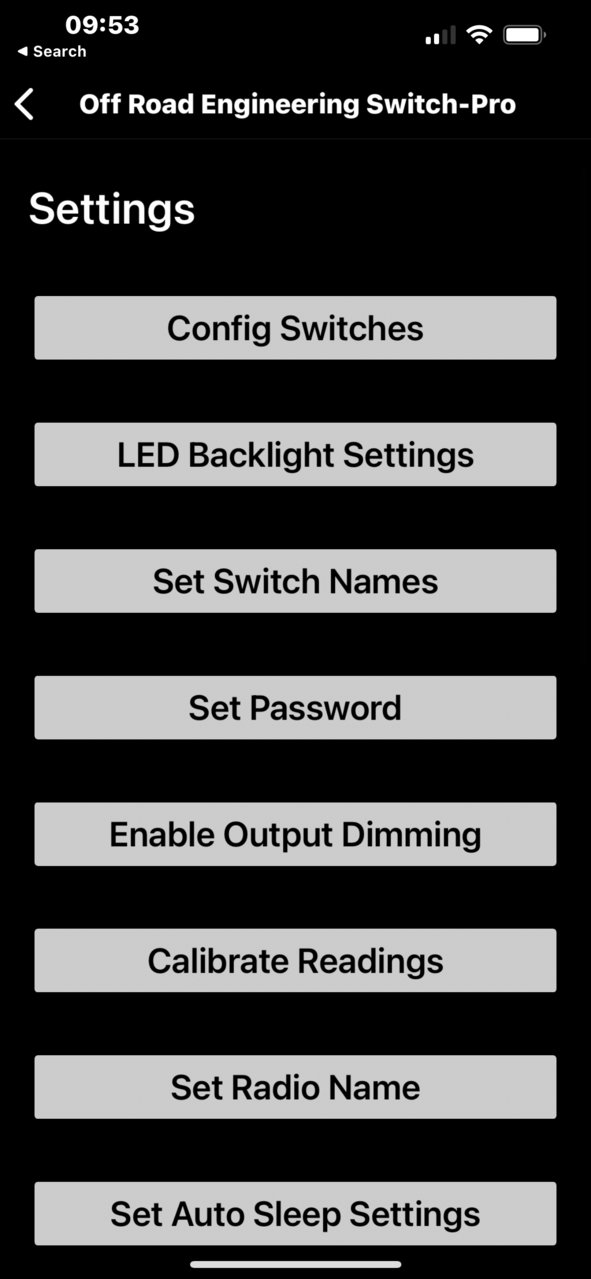

    Tried that lol and it’s odd ever since I’ve had it never asked me to input it until the time I actually wanted to make a change lol

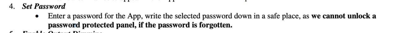

    You’d have to explicitly set password:
    And I think there isn’t a published way to reset/recover the password. Effectively pausing any app control or configuration via app. You’re still able to program via the controller (keypad), the majority of the functions though…
    maybe SP will swap out the kit for you?

    @reywcms - let us know if this works!
    from the manual:
    ominous....

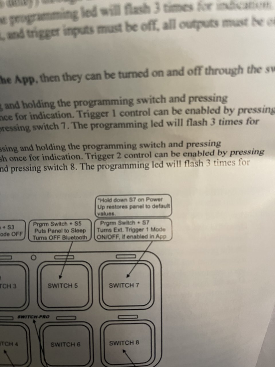

    I’ve unplugged the control panel no dice. Nothing in the 9100 manual about pushing 4 times quickly but I did see this on the S7 button. Do we think resetting to default includes passcode lol?

    No dice on the following-
    Press and hold s7
    Press program switch quickly
    Negative battery disconnect

    Lol. Holding 7 while booting didn’t do a damn thing on my 9100…
