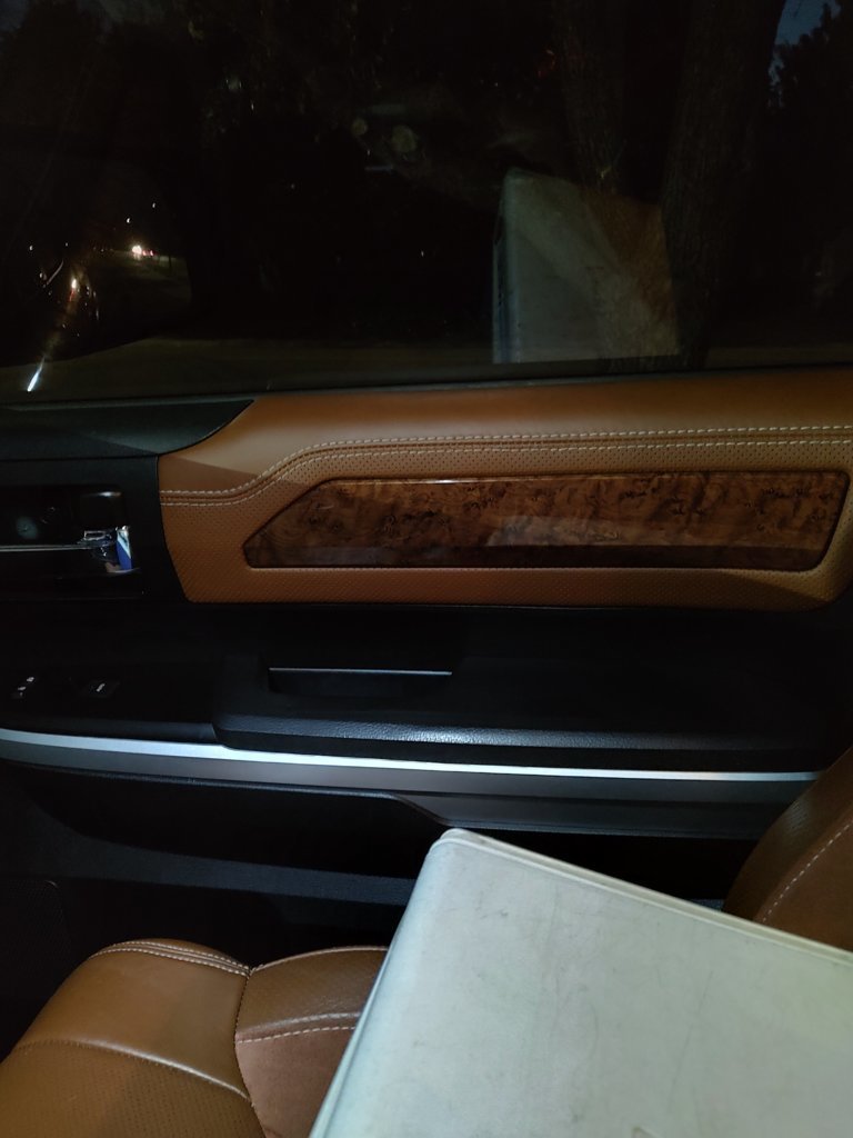

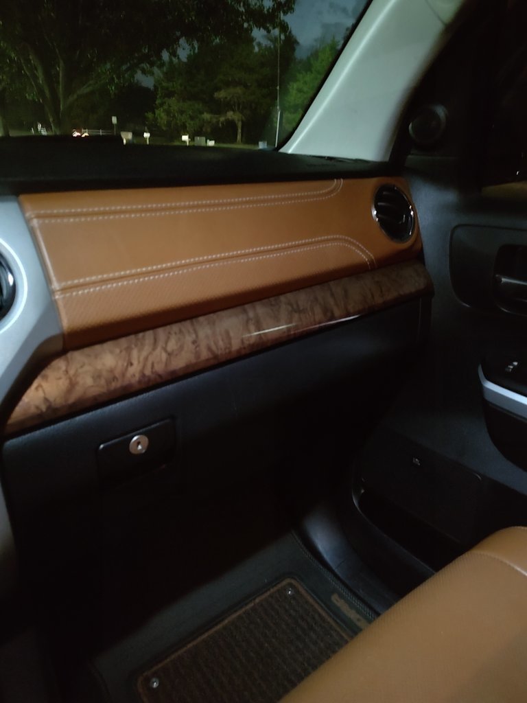

  3. Oct 10, 2024 at 9:13 PM
    clark_tesky
    clark_tesky [OP] New Member
    Oct 10, 2024
    #124090
    3
    Clark
    2017 tundra
  4. Oct 10, 2024 at 9:14 PM
    clark_tesky
    Oct 10, 2024
    #124090
    3
    Clark
    2017 tundra

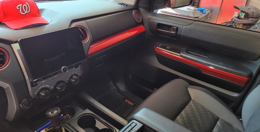

    The door panel pieces are plastic welds. You will have to chisel them off and then apoxy the painted trim piece back on.
    Get a wide screw with washers cause they don't always sit flush when reattaching. So some tabs will need to be screwed in to hold the whole piece tight to the door. Then apoxy the non screwed tabs and then if you want remove the screws at that point and apoxy those tabs as well.
    If your just looking to remove that horizontal trim, you actually don't have to remove everything. You can pop off the trim pieces above and pop the tops of the panels below and get those pieces out.
    Just did mine. Patience is key. The video posted above is a great reference.

    Just changed door panel trim from black to 1794 and the plastic welding and a few screws with washer worked well.
