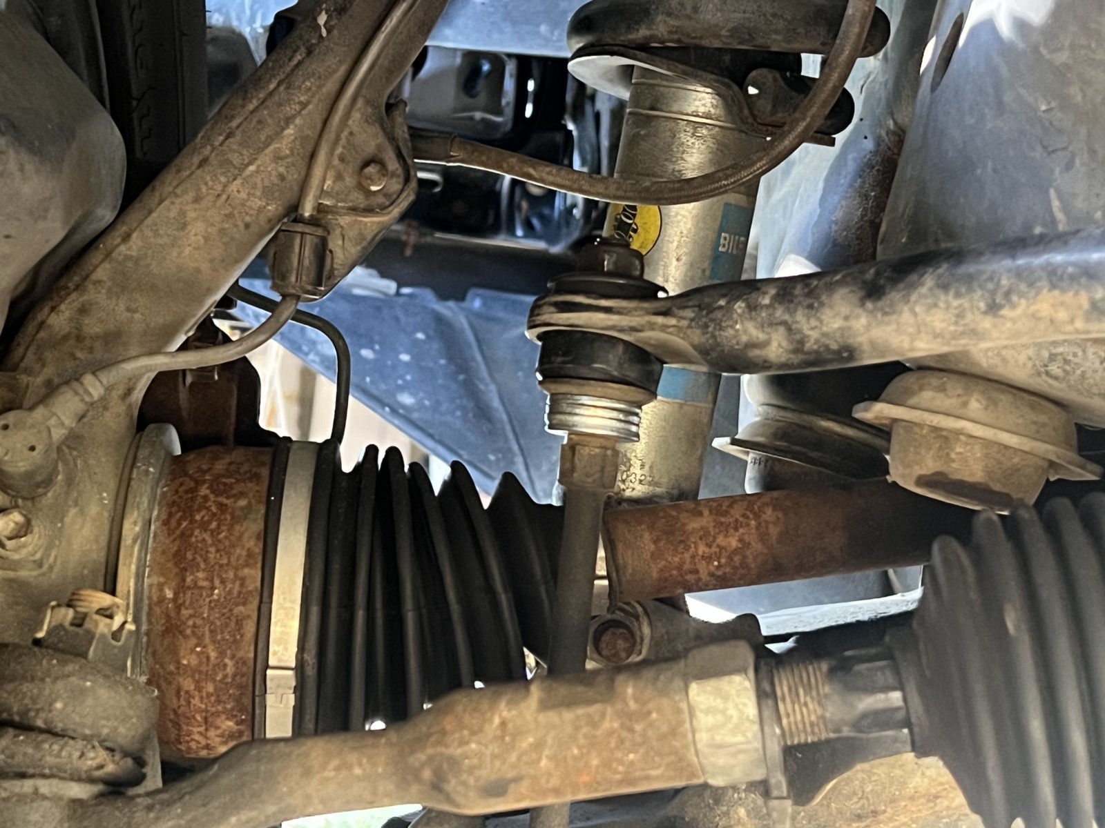

    Factory angle with front lift. Note the angle causing the bushings to smush out.

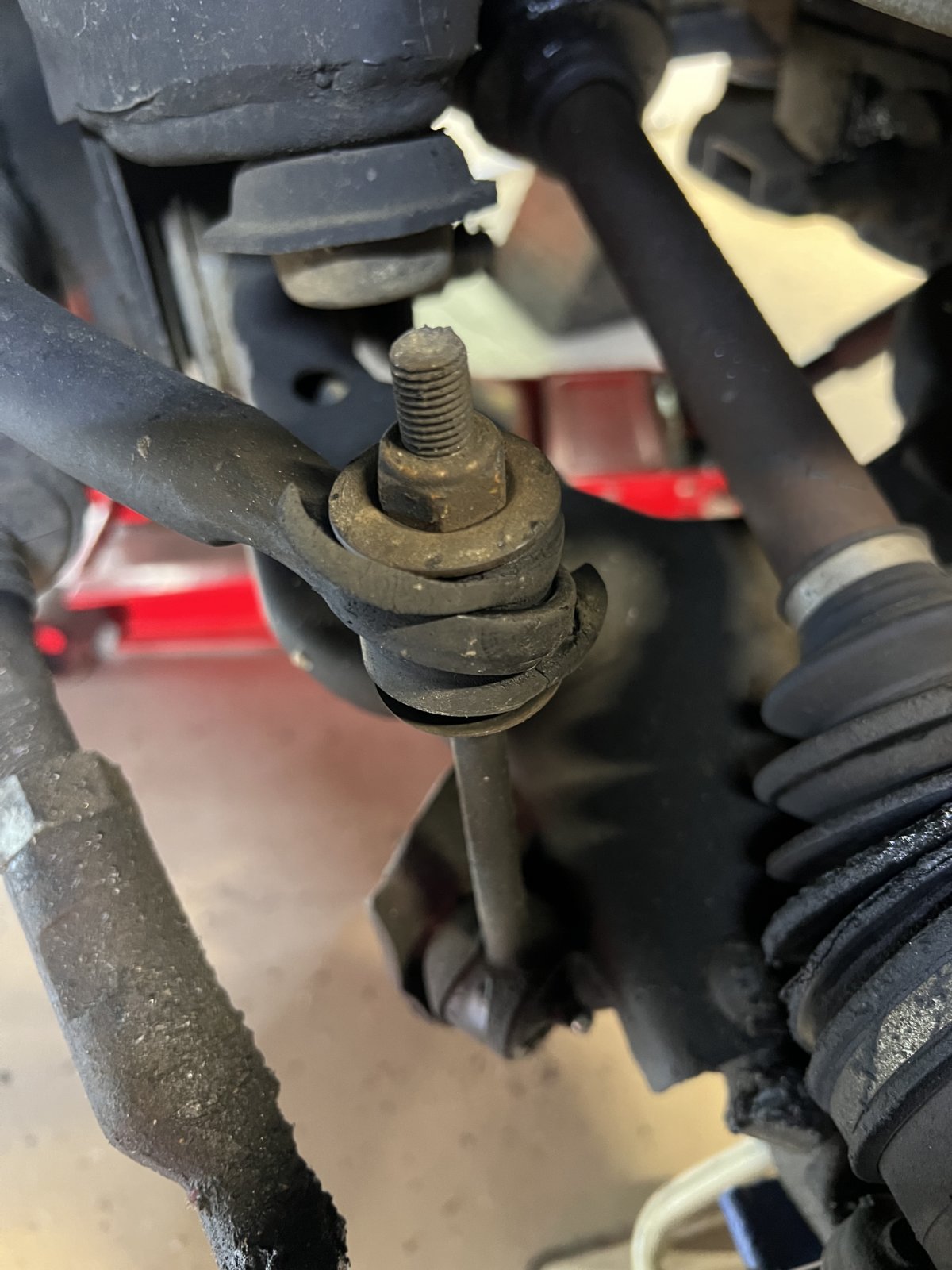

    New bushings and my home brewed washer mod to correct the angles

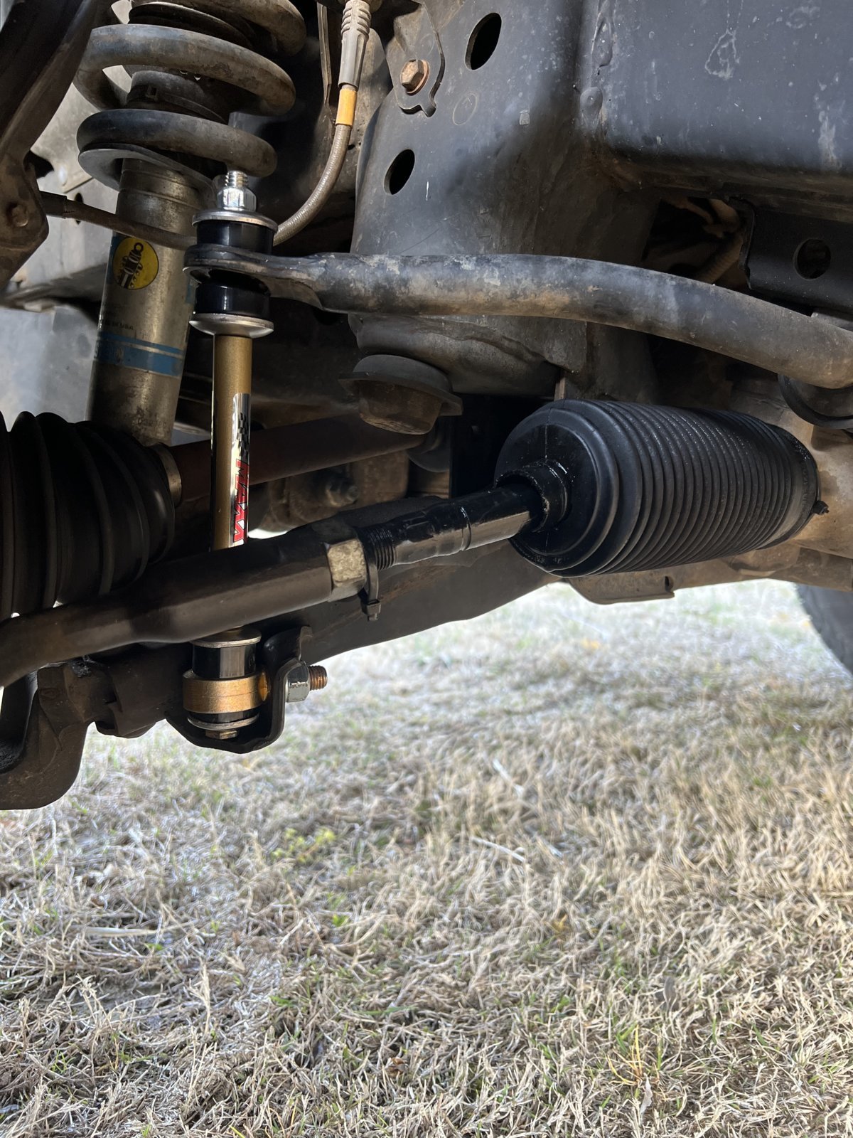

    SM links. Super boss in gold
