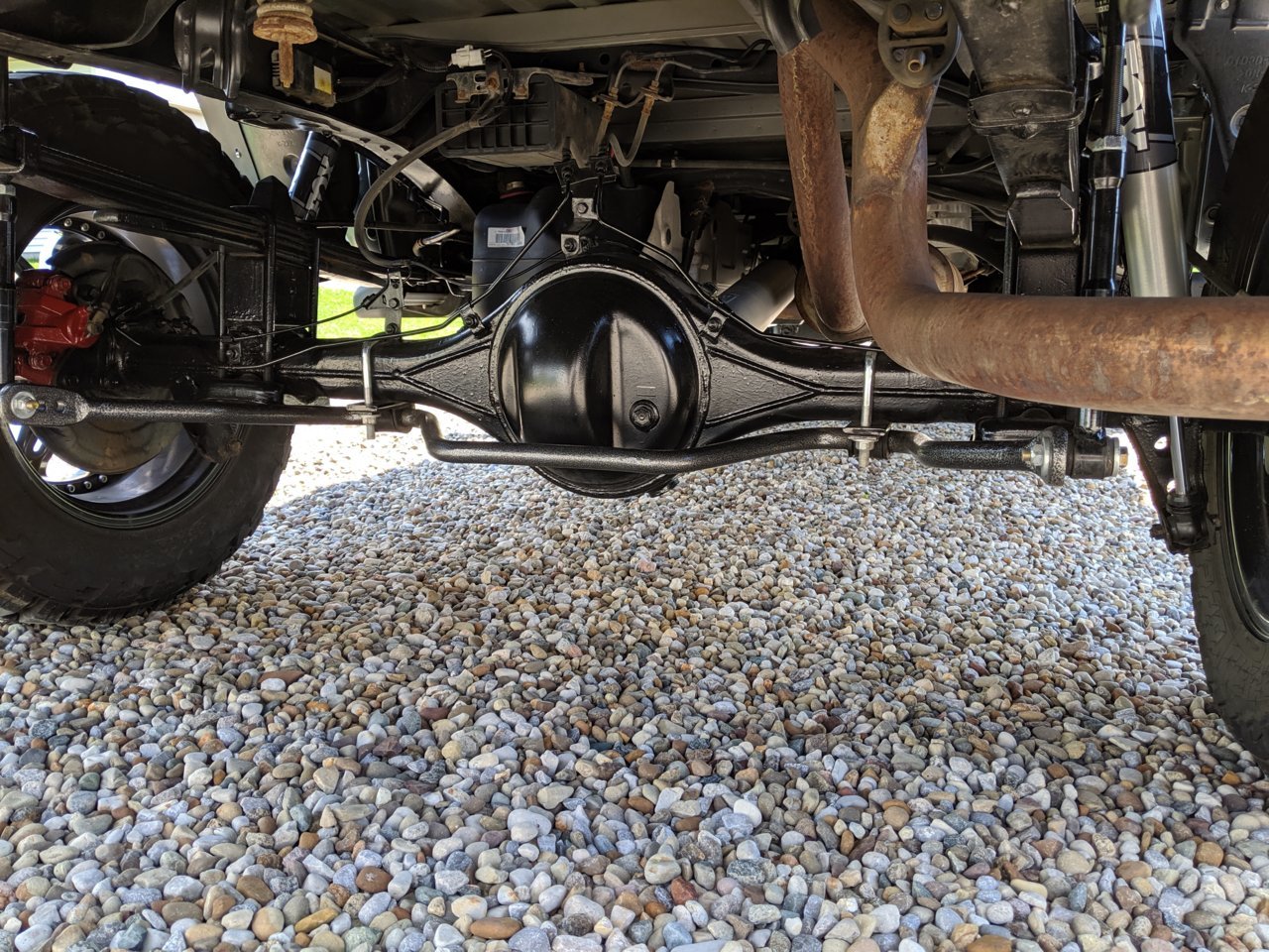

    75,688
    I think they are a great addition. I really like my Hellwig and it's already grey like @Black Wolf said.IMG_20190630_114135.jpg

    Damn, now I'm gonna order the hellwig links so I can play with the pre-load. Looks goood
