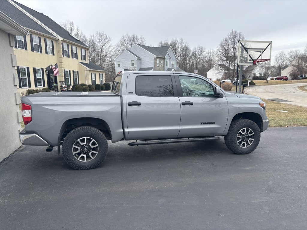

    Hi all
    I finally got new tires and now get rub on my swaybar at full look
    Below is the set up of my truck
    21 Tundra Crew Max
    Westcott preload collars with shims
    Driver side ship to fix lean
    Bilstein 5100s on all 4 corners
    Coachbuilder +3 stackels
    Wildpeak 275/85/18 tires
    is there anything i can do to stop the swaybar rub at a full turn?

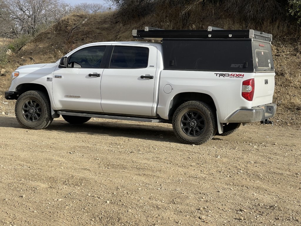

    I have same issue after doing 6112 and going to 295/70/18 tires Kumho's. Had to trim the passenger side skid plate but still rubbed sway bar. Got 1.25" spidertrax on all four, then started rubbing driver side mud flap (I have aftermarket bumper so no issue there). I had to trim mud flap but it has about 1/2" clearance on body mount, so no BMC yet
  13. Feb 5, 2025 at 3:06 PM
    kevine0001
    kevine0001 New Member
    Jun 17, 2019
    #32042
    742
    Kevin
    pic for reference
