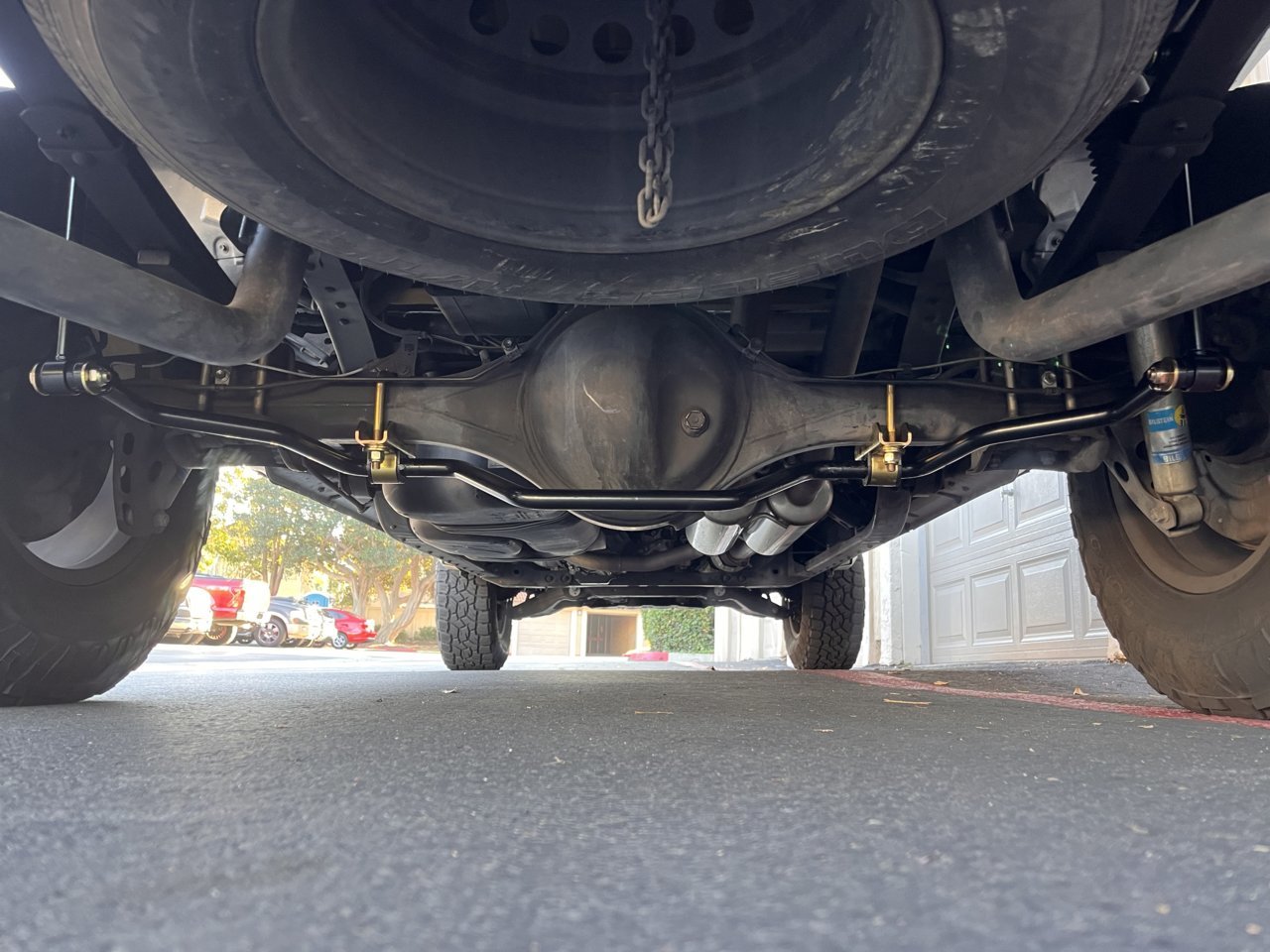

    TRD RSB looks puny, IMO. Much prefer the Hellwig, which is quite beefier. Is also available with longer end links for lifted rear ends.

    I agree didn’t like the look at me red. So had mine powder coated.
    AggiePhil[QUOTED] likes this.
  10. Dec 28, 2021 at 8:23 AM
    76,030

    Now that looks GOOD! How much was it to have it powdercoated and was it a hassle? Also, I wonder if maybe the Hellwig is a bit stiffer than the TRD?

    Thanks it was $75. I was able to push out the new bushings with hand tools and brought just the 3 bars in for PC. Easy to push the bushings back in by hand as well.
    The hellwig has 3 different holes to mount the end links to for more “stiffness”. At over $500 I couldn’t bring myself to spring for it.
