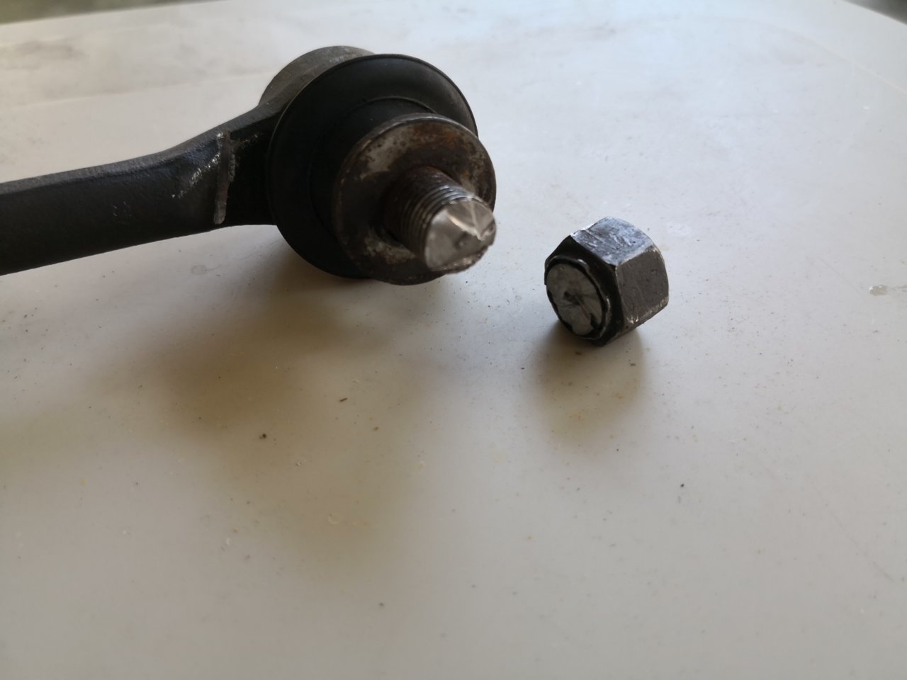

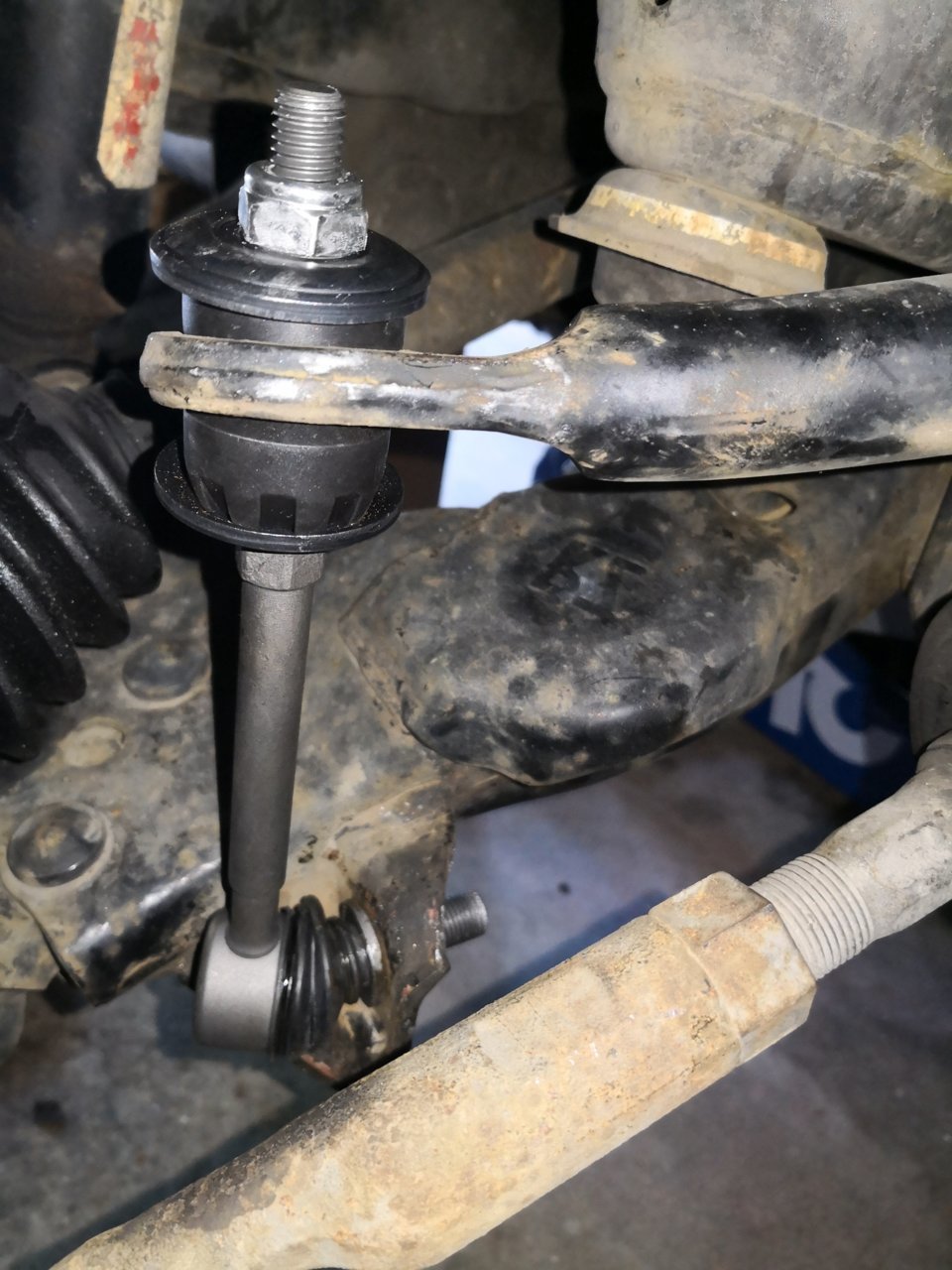

    Chopped this fucking thing off with a dremel. What a pain in the ass.

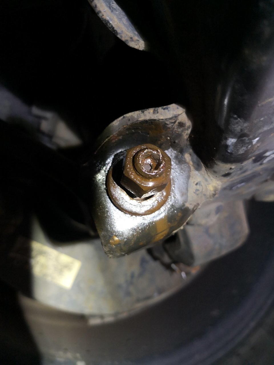

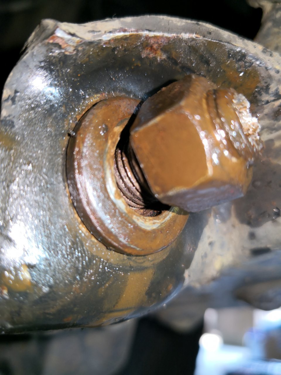

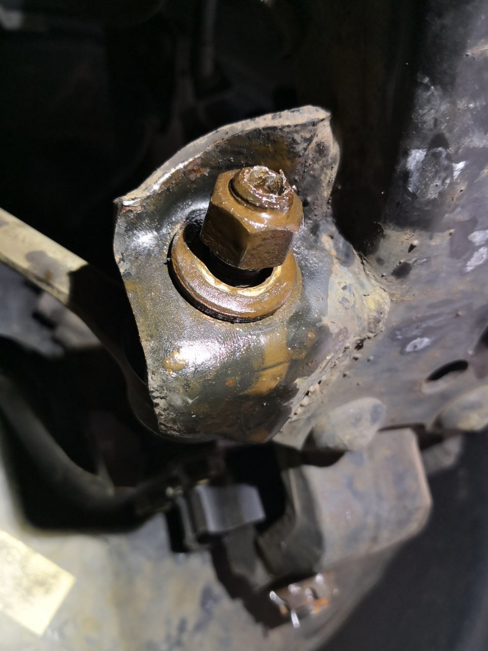

    BTW same thing happened on the other side when I wanted to replace it with a new link. Big mistake, should've just left it alone. For all my efforts trying to prevent the Allen key hole from stripping, it stripped super fucking easily. I have it mostly unscrewed but now it's stuck with a stripped Allen hole and I'm just gonna drive it like this for now. Technically the sway bar is attached on both sides.
    Pics of chopped one and new install.

    If you have a good set of pliers you can grab the round 'seat' area that is tightened against the sway bar. Or rip the boot off and grab the ball joint directly with pliers. Then impact the nut the rest of the way off.
    Only a good idea since your replacing it anyways.
