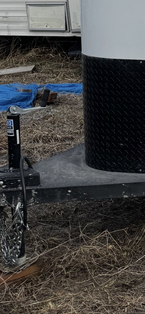

    IMG_0451.png Hello All - Needing some help finding a recommended weight distribution hitch with sway control for my horse trailer.
    The original I purchased will not work due to the platform on the trailer attached to the coupler (it needs bracketed arms to set the distribution attach points on/tighten up).
    Any recommendations for anyone who has towed a trailer with something similar such as this and needing a weight distribution hitch with sway control? Ideally one piece.

    Cut through the platform. I've had to do it on a couple trailers. I just drilled two 1/2" holes and then used an angle grinder to take out the center. Brackets went in like a glove.

    Great ideas - thought about looking for one to drill through the bracket, was curious to any that folks have used with good success.
    Thanks for the ideas and sending over some links!
