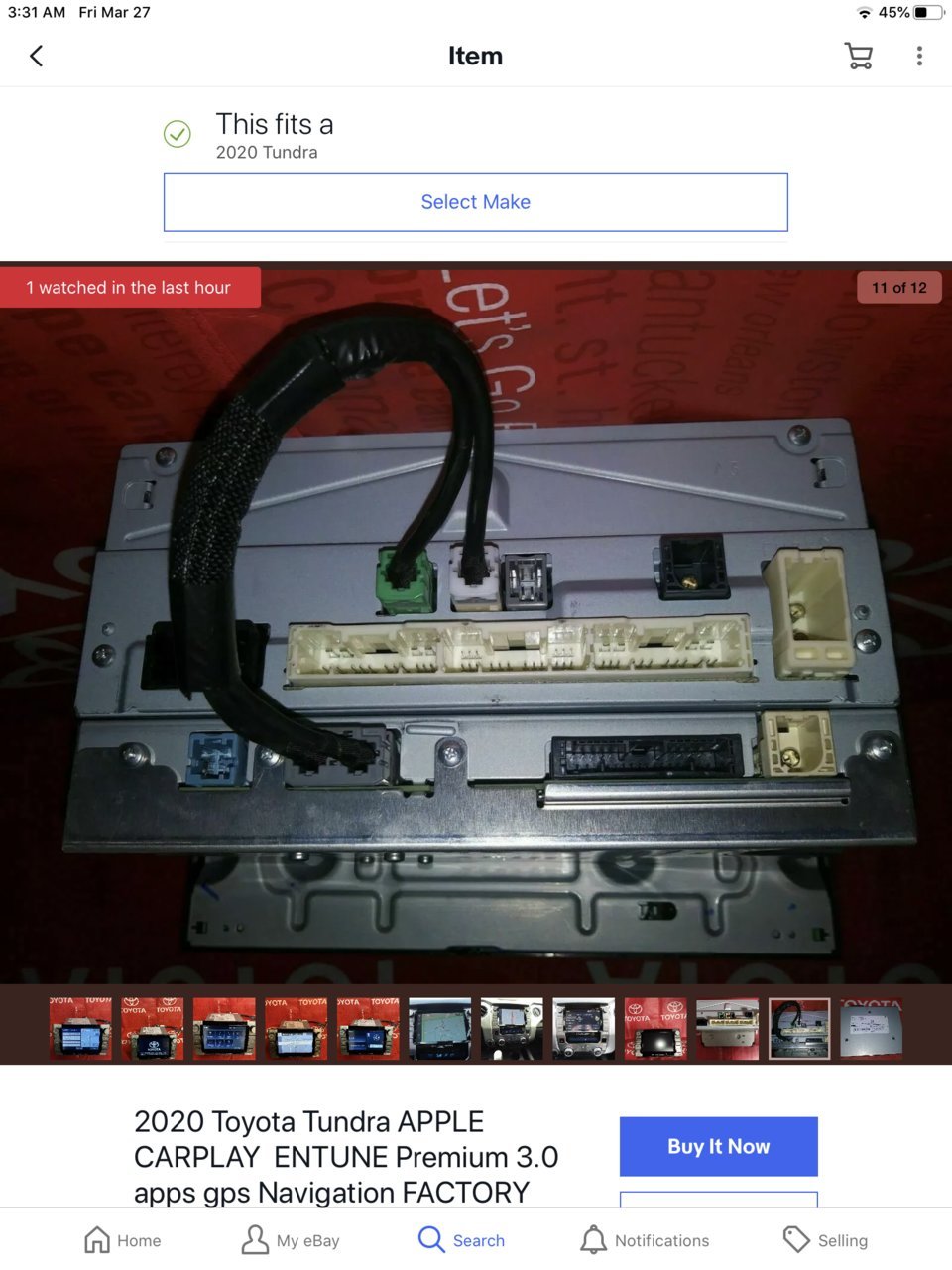

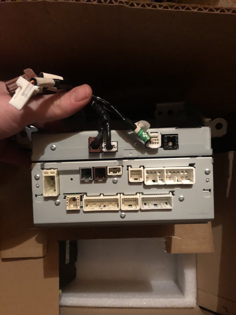

    Negative...the wiring and connectors on the 20 and 21's are different than the 2019 and older. Some of the guys with 2018 and 2019's wanted the radios out of our 2020s for Apple carplay and AA until they found out that the connectors are different. I'll see if I can find the post showing the 2.

    Top pic is from a 2014-2019. Bottom is a 2020.
    E05CB499-7AAE-478B-A3DA-7C6C43DC9EC4.jpg A74493AA-6810-4B3B-A9D3-61C98D6A5C19.jpg

    I beleive the pin-outs and wiring are all different. It would be one hell of a project and headache to try and chase it all down.
