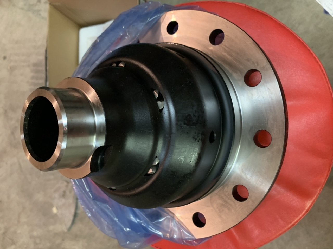

    Santa showed up today. Waiting to hear back from my installer to get it done. My guess is it will be a few weeks. Looks smaller than the auburn if I remember it correctly.
