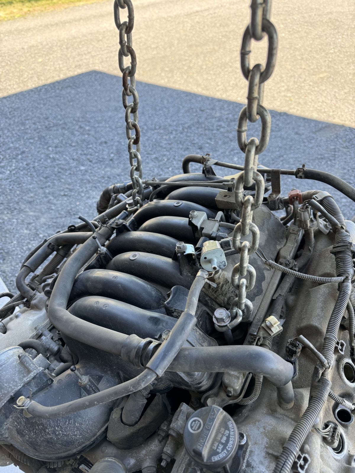

    A little off topic but @Mythalas did you use a cherry picker to remove the engine? If so, where were your mount points? I’m trying to figure out how to hoist my engine.

    We used 2 bolts that screw into the top of the engine and ran them through chain and used that to lift the engine out of the truck.
