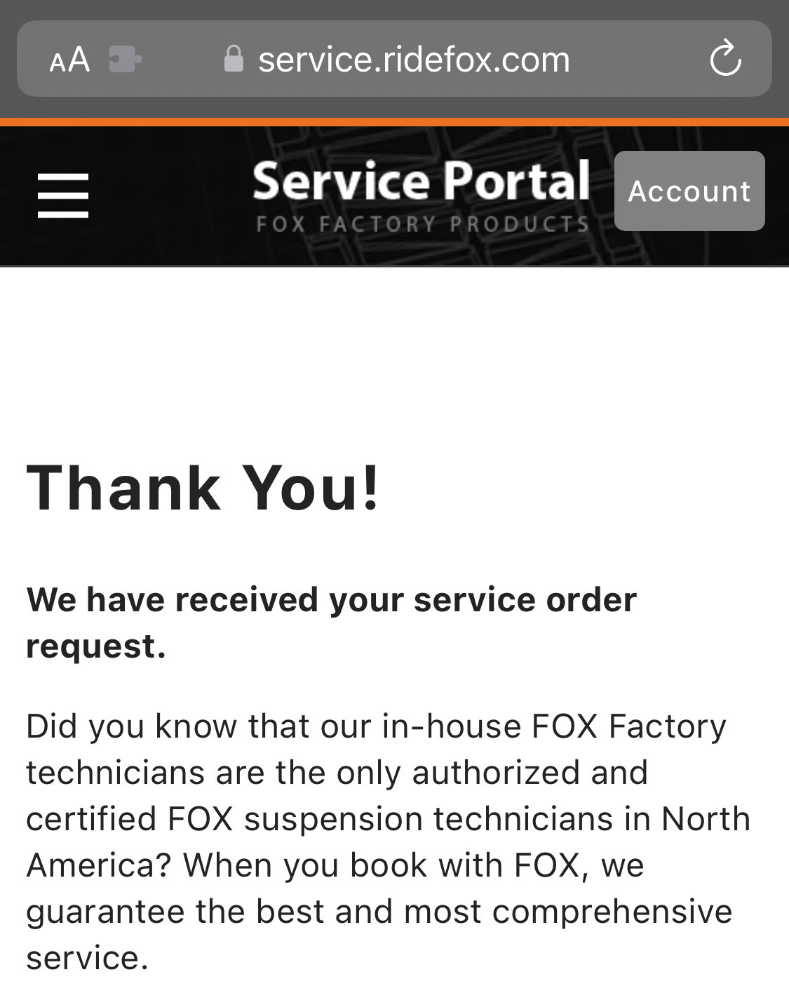

    Accutune can if I remember correctly or Fox themselves.

    Done! Thanks
