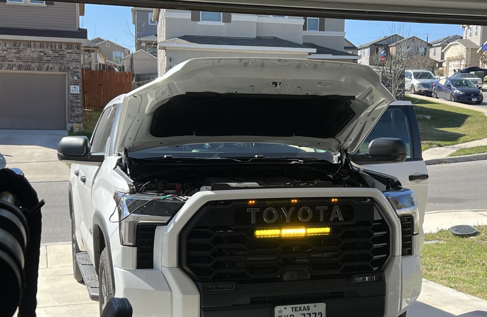

    I just completed this last weekend. Added heritage grille with marker lights. I used the rave harness for this. Lights come on when the truck is on. DD light bar is ran to a OEM style switch that I purchased from caliLED. The light bar comes with 2 new supports (pictured above)

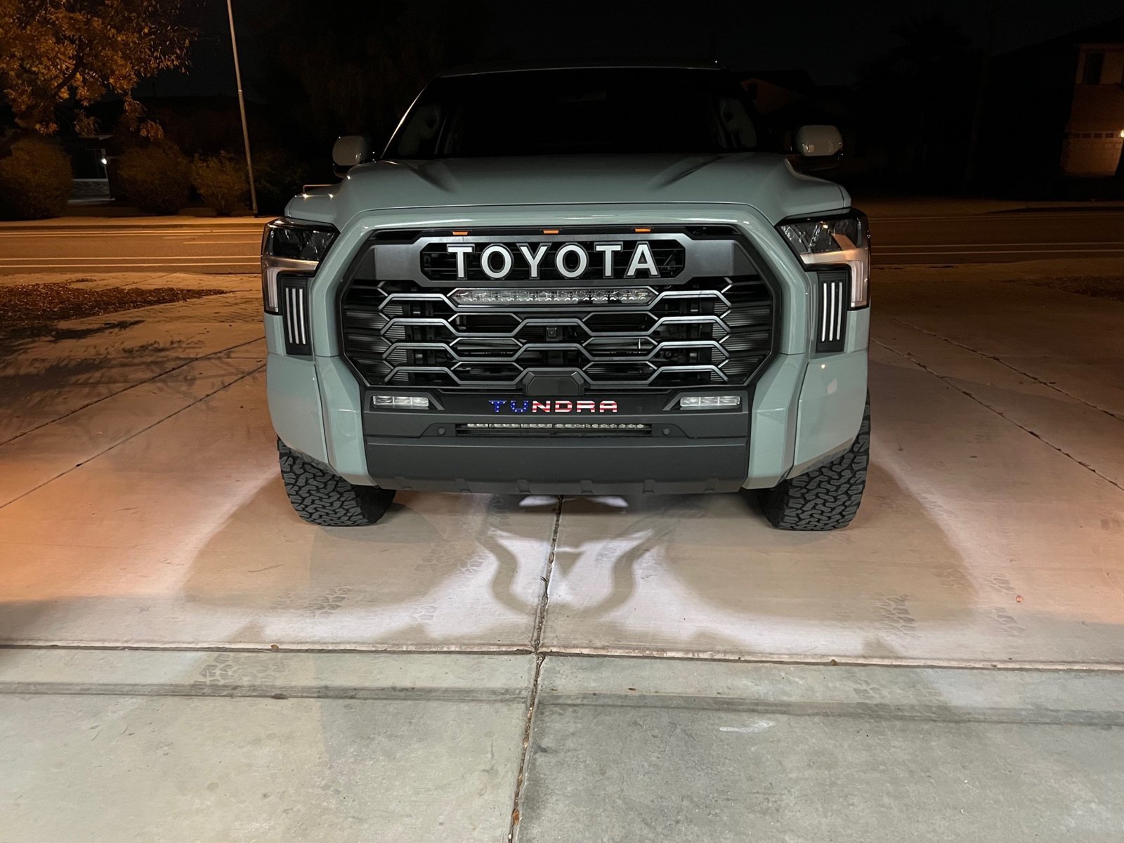

  10. Mar 2, 2024 at 12:00 PM
    ghunter321
    ghunter321 Trail Hunter
    Dec 5, 2022
    #87939
    179
    NC
    2022 Blueprint Limited Tundra
    Retrax Pro XR bed cover, UpTop Overland mid truss system with Baja Designs rock lighting X6, GGOffroad rearview camera relocation kit, Pelican cargo BX90 case, Maxtrax recovery traction boards, OEM bed step, OEM dash and door trim/cubby/footwell lighting, Slee Offroad dual wireless Qi phone charger upgrade, CBI covert front bumper with air dam delete module, TRD Pro heritage grille replace with amber OEM marker lights, Diode Dynamics 18" white lightbar kit and OEM marker lighting, Diode Dynamics covert 18" amber lightbar, Rough Country bed mat, Rough Country defender series fender flares, TRD camo tailgate spoiler and OEM marker lights, TRD camo rear bumper arms, Screen Protech for interior surfaces, OEM badge blackout
    This is awesome news. I’ve noticed the profile is pretty deep on my other one. Do you have the automatic grille shutters? Does everything clear them without further modding?

    Yes I do. They do clear just have to slid the light bar all the way forward
