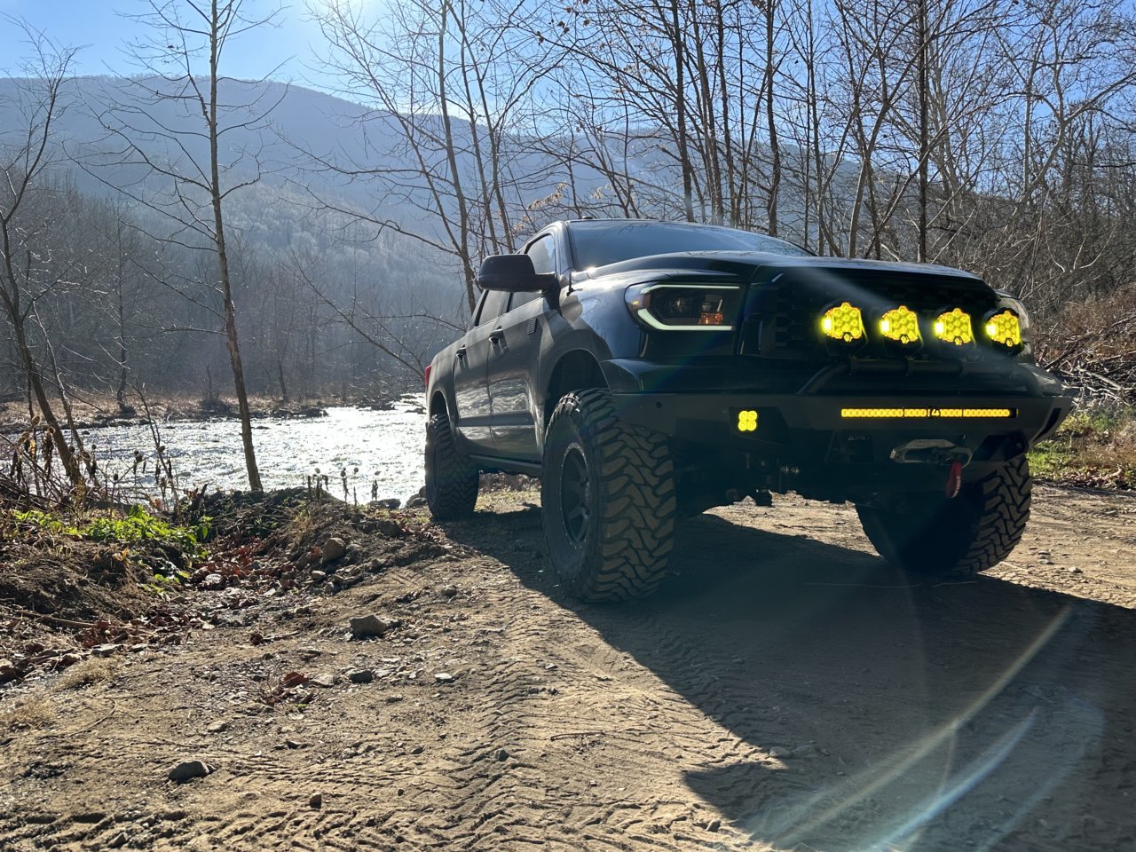

    Currently have a 2012 crewmax tundra on 37" tires, with a 3" lift using Toytecs 2.5" coil over kit. I also have JBA UCA, Icon wheels, BMC, high clearance front bumper, and front sway delete.
    Im thinking about going with a 4" or 6" lift though. Would like to keep the current coil overs if possible but have no idea if they can be used on either of the lifts. I see kits with spacers and coil overs offered with the lifts but they dont really specify what the length on the coilers are, that I can find anyway.IMG_0971.jpg
