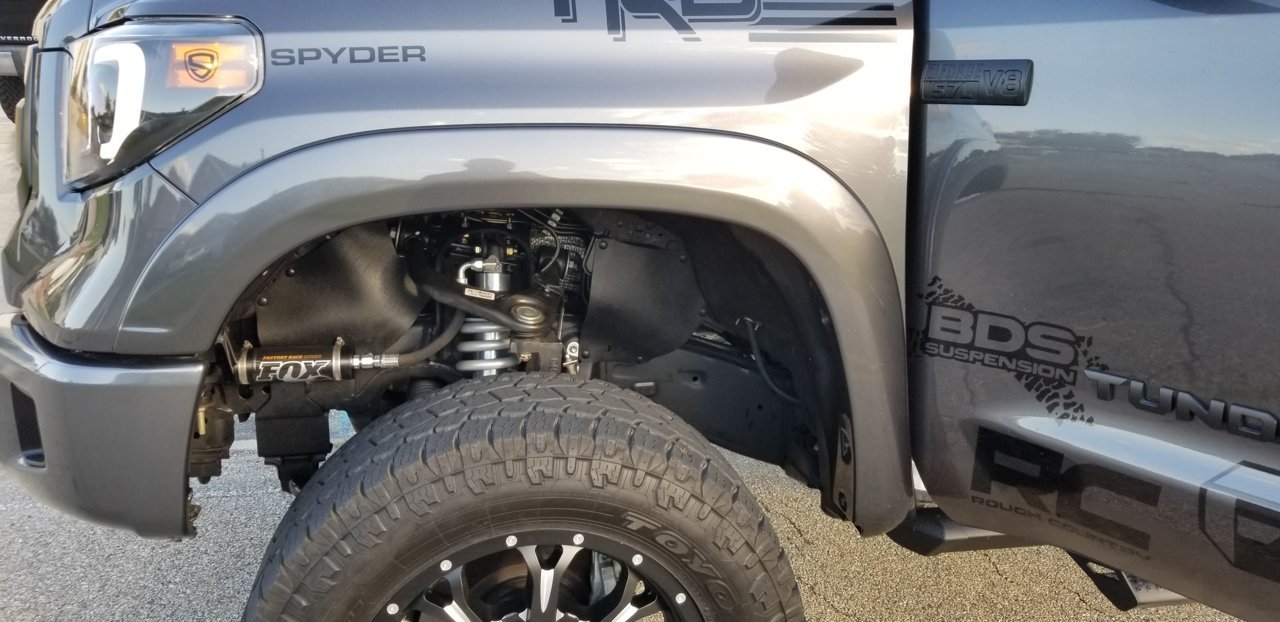

    Anyone tried to put 2.5 fox coilovers for a 7" BDS lift 20180424_165506.jpg on a 6" rough country lift , they're saying they can't get my alignment right

    Any ideas on this ?

    with your lift, you need aftermarket upper control arms to get the alignment correct.

    My thoughts exactly !

    Have you ran across this before ?
