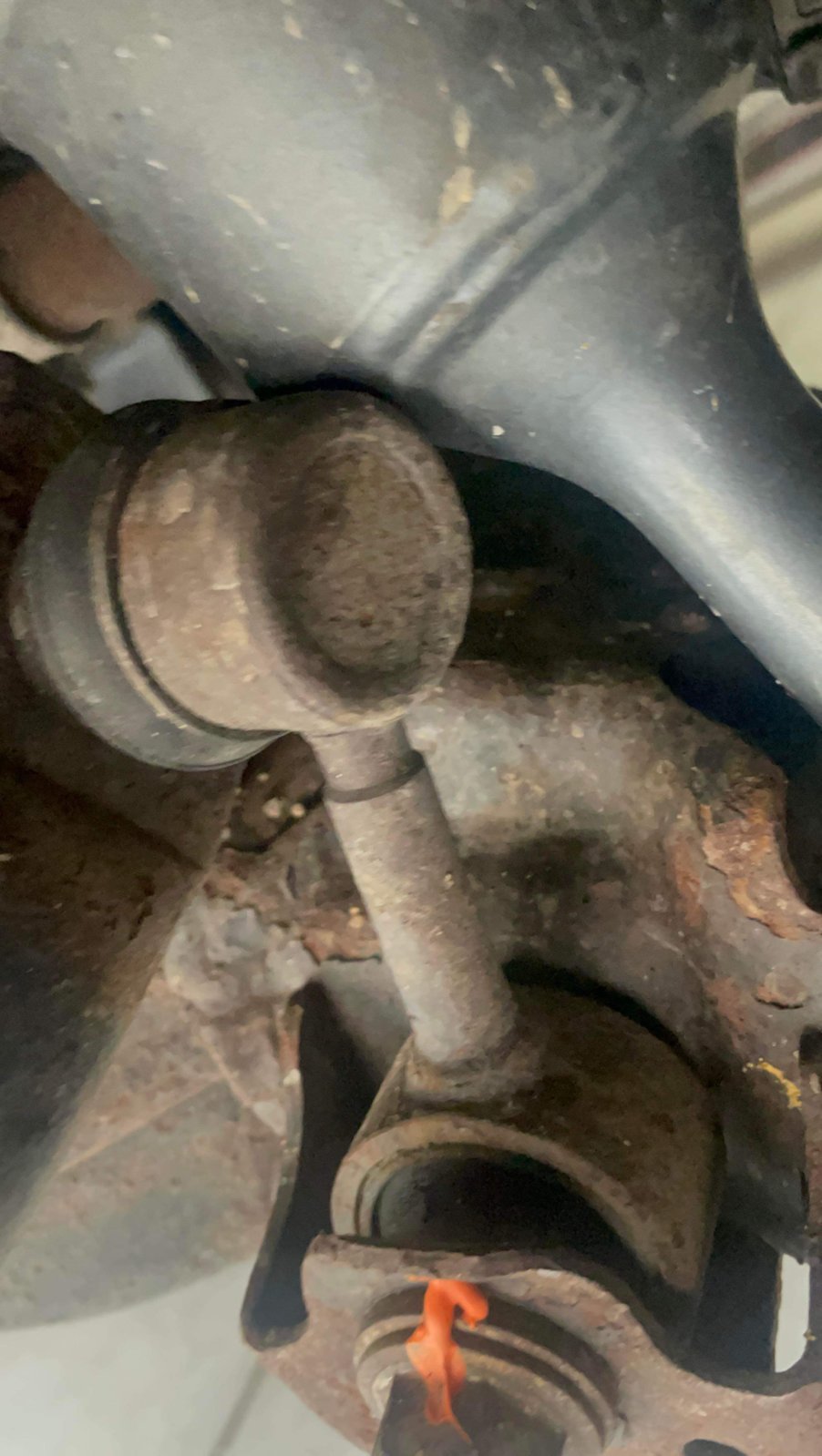

    Hello tundra owner. Im new to this site. Please i need help if anyone to fix it. I just recently installed the ironman lift kit to my tundra. 3.5. on the passenger side i found out that the link of the front sway bar is touching the suspension. Do i need to change my link or do i need to replaced the sway bar. Thank you..

    The easiest way to fix this would be to install a sway bar drop. Should give you enough clearance. I can get you one for like $40.

    Thank you. Please send me the link so that i can order it.
