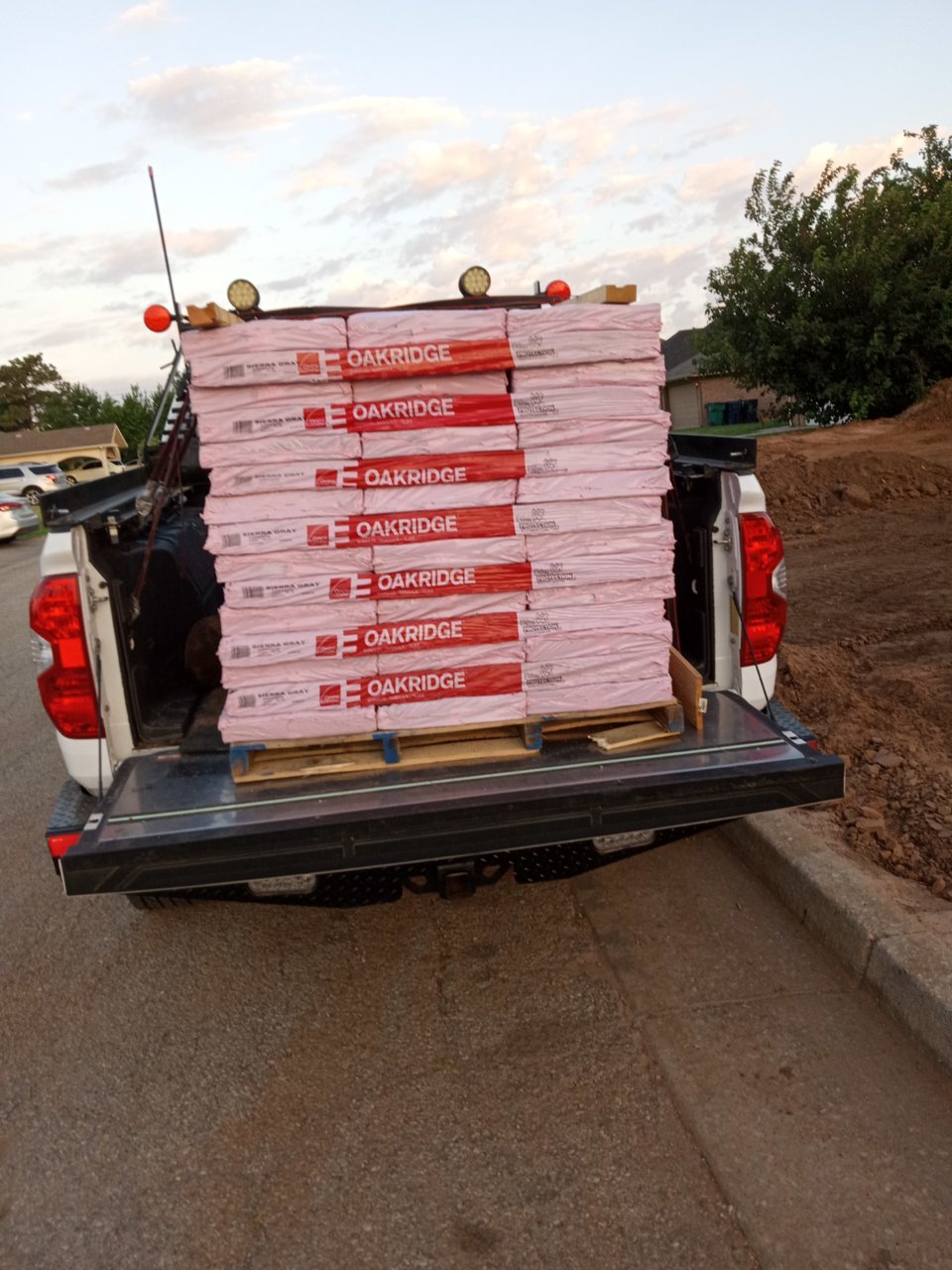

    There is no substitute for replacement HD leaf packs. That said I have a RAS HD kit and yellow Sumo springs in conjunction with HD leaf packs on my truck because I have been known to load a bit heavy at times and don't want to flatten the high dollar leaf packs that provide the rear lift on my truck. So far, it's working out well when I need it. When I don't, it corners as if on rails.IMG_20220706_063643_01.jpg

    What kind of squat do you get with a load like that? Are you using Deaver springs?

    Dobinson's 5+2 HD springs, bout 2.5" drop maybe if you include tire ovality. That's a bit over 3k over and behind the axle, mostly behind.

    Damn that is some crazy weight. Any drive ability issues?

    I wouldn't drive it like normal to compare. Only short slow distances, maybe ten miles at 40 or 45. No issues. BDS traction bars prevent any possible axle wrap during take off.
