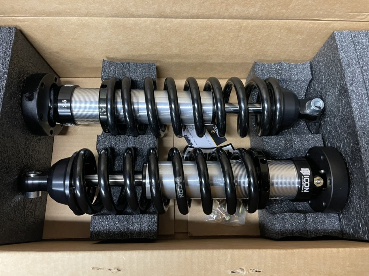

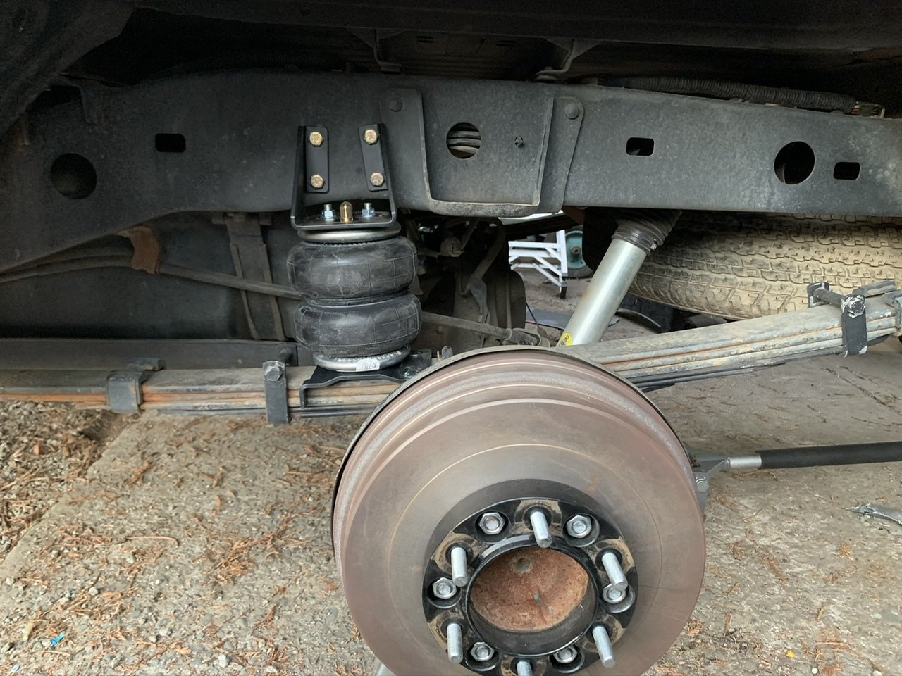

    2” Lift, Bilstein 5100’s and 885’s second notch, Rear 5100’s Icon 3 Leaf Pack and Firestone Air Bags w/Daystar Cradles. Spider Trax 1.25” Wheel Spacers, 4Runner Pro Wheels, Falken AT3W 285/75r17 (34x11).
    Pretty sure everyone is out of stock on the 6112’s right now. Because of that I went with Icons on the Sequoia, and they ride awesome.
    Rear on the Tundra I’m running Icon 3 leaf add a leaf pack, over load removed, with Firestone air bags. I have a nice street ride and just add air to the bags when I tow. Total investment <$500.
