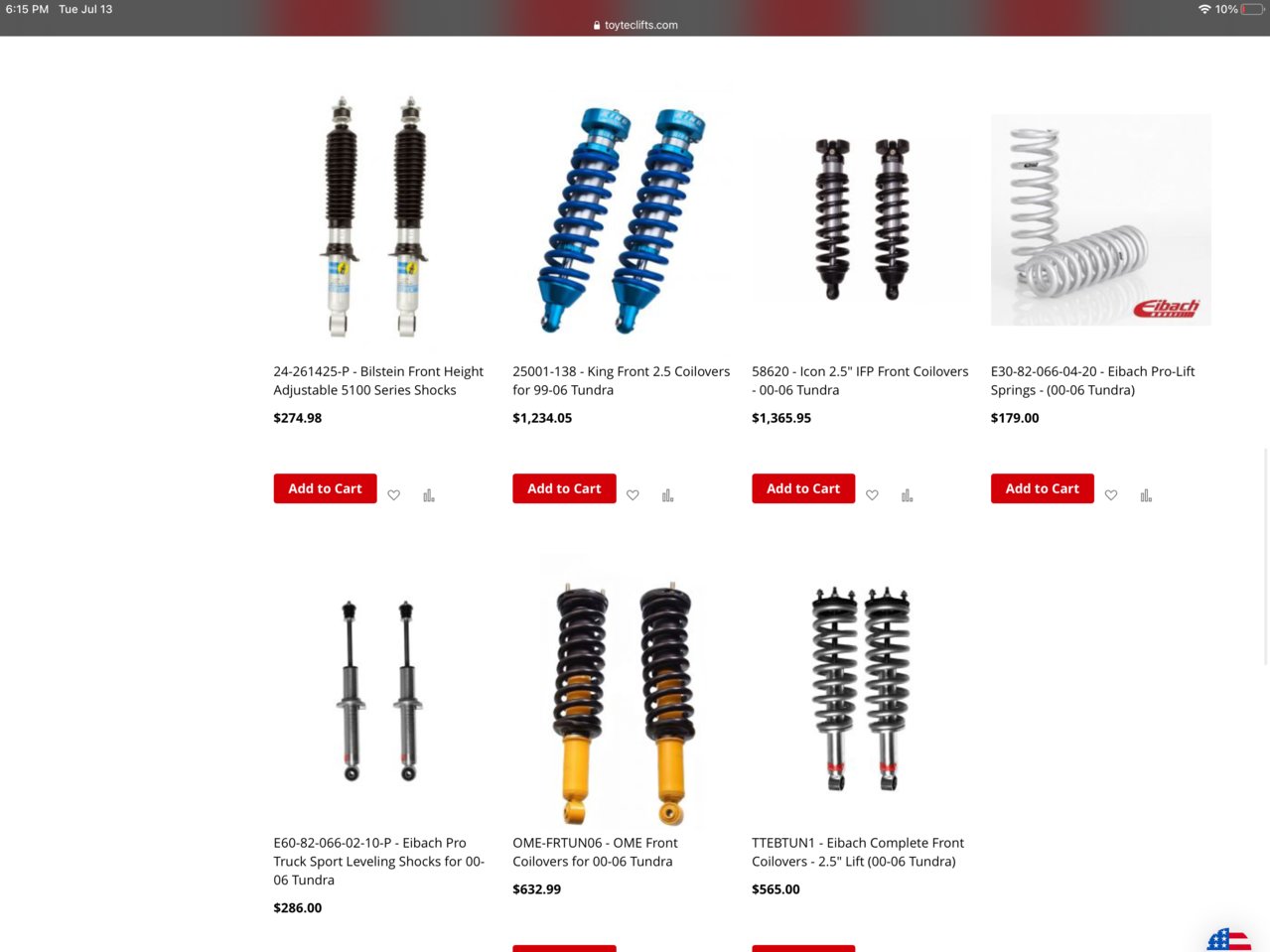

    Looking into upgrading all shocks/springs from my aged OGs
    Originally thinking about going w/ 5100s/OE springs lifted to the highest setting to level front then getting 4600s for rear
    Recently looking into adding the lift through some Eibach springs instead of maxing out the 5100s as they’re half the price as OE & have solid reputation
    Also looking into OME shocks/spring complete kits as I know they have a also have good reputation just not sure how they ride on tundras
    Also like the price point on the Eibach shocks just have the same question as I do w/ the old man emus especially in comparison to 5100s
    Also not sure if it’s worth it to just go w/ 5100 instead of 4600 in the rear

    Considering all besides the icons/kings unfortunately

    5100's are designed to handle heavier unsprung weight. If you are running stock or stock-type/weight wheels and street/passenger tires I would not recommend them, especially above the 3rd setting. They are a great product when used on the correct applications but disappointing if misapplied. I know this doesn't answer your question but it helps narrow it down and hopefully gives some understanding.

    I've had the OME and Eibach. I prefer the OME it's firmer and more planted but by no means harsh. The eibach is more cadillacy and a bit too wallowy for my taste.
    The rear 4600 don't work with any kind of lift, 5100 are good up to 1 inch so just depends if you are lifting the rear.

    Just did this one with Eibach all around — kept the stock springs being they only have 70000 miles on them — tire size 265 75 16 falken at3w 10 ply — rides just perfect
    Front shocks installed with spring perch at 2nd notch from bottom

    5100’s front and rear. Cheap and good quality and ride decent.
    No need for control arms. Upper ball joints are only $54 from Toyota.
    if you want to get fancy add some 885’s and Icon 3 leaf pack in the rear.

    After settle the 885’s are about 2” lift. I wouldn’t mind and extra 1/2” I may move up one notch on the 5100’s.
    They ride pretty well. I would of just run the factory springs, but I didn’t have the factory ones unfortunately.
    Just remember the 885’s are Tacoma springs and will require, all though not 100% necessary, new conversion coil seats for the upper spring seat as they are slightly different diameter than the tundras. I used a Monroe Tundra seat not knowing this. It doesn’t fit all that well, but it’s been fine for over 50k miles.

    For what it is worth, I am running 5100s front and rear, have 885 springs, and did a 3/8 spacer. Without running out to my truck to double check, I believe I am just over 2.5" of lift. I have a double cab and the ride felt a bit firm at first, but feels more like a truck should at this point (my previous suspension was waaayyyy bad, like late 80s Caddy bad.)
    I pieced mine altogether. I didn't realize I did not have OEM springs when I tried to mount my shocks, but if I did it all again, I would probably just go with a kit like from 1st gen off road .

    So if I wanted to keep my stock UCAs,
    What’s the highest spring I could go on low setting of 5100s if I’m looking to run KO2s @ 265/75/16?
    would OME 884s work?

    2884 should be about 1.5 lift which should be fine with stock UCA and that tire size.
