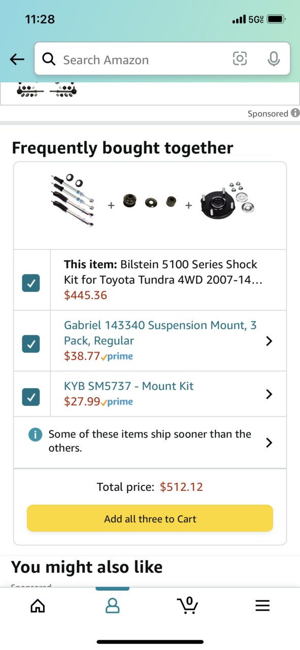

    Bilstein 4600 only cost $370, and 5100 cost $500. No idea why you would go for the black factory shocks
