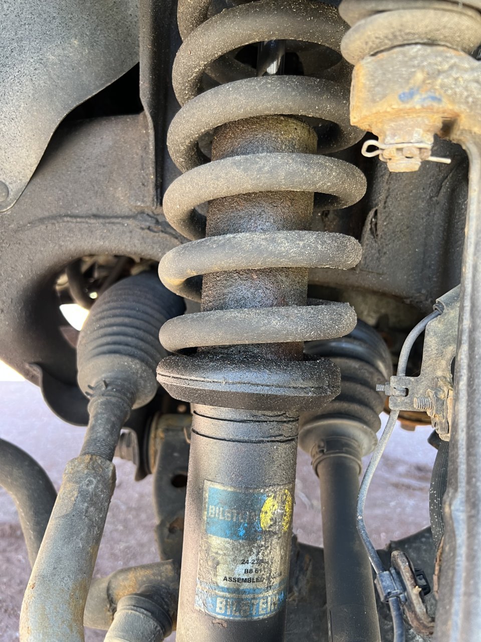

    My bilstein 6112/5160 setup is toasted after 28k miles and I’m looking to upgrade.
    my road is very bad, reasoning for my bilsteins to have bit the dust so quickly. Also my lower control arm camber bolts are seized (no suprise, thanks New England) and my leaf pack is flattening.
    I’m looking at oem new LCA drenched in anti seize, camburg uniball UCA, KING 2.5 front and rear without adjusters, deaver leaf packs and coach builder rear shackles. Looking for a 2.5-3” lift out front and 2.5 in the back. Basically some rake when no rack and level when loaded up.
    my bed all summer has a UPtop overland rack, tent, awning, two bikes, bike rack and camp gear most weekends and ranges from 500-750 lbs.
    I’ve contacted deaver for leaf spring options and haven’t heard back from them. Any recommendations on packs?
    also kings seem to have two, 2.5 options. One has a black finned resi and one has the classic smooth silver. Any difference between the two internal wise other than possibly better cooling capabilities? I’m gonna be ordering all these parts during the winter for a lovely spring time install, just want all my ducks in a row and part numbers so I’m ready to go. Any help is appreciated !

    I don't necessarily think they're toasted after 28k, but what I do think is that the suspension may no longer work for you since it seems like you're carrying quite a bit of gear.
    It does seem like you've already done some research on your own on wanting a set of Kings front/rears with no adjusters. The difference between smooth body and finned is most likely heat dissipation. Most likely geared more towards racing as when the suspension cycles, the oil will heat up - the finned reservoirs will allow the oil to cool much quicker to reduce shock fade.
    You state that you also live in New England and being in New England with salted roads, I would probably not recommend going uniballs unless if you can do the maintenance after every drive; sealed ball bearings (such as JBA or SPC) might be more practical unless if you're willing to take the gamble.
    Look into swapping your coils to higher rates to compensate for weight? Deaver / Alcans may be the way to go with adding some bumpstops such as superbumps or timbrens?

    Their toasted lol all the fluid leaked out with the duro bump stops.

    Dang, how do you think it even got to that point at just 28k?

    the road we live on is atrocious. My neighbor broke broke his leaf springs and I’ve had to replace the suspension in my car already once and that was in 6k. Honestly need coils strictly for my road
