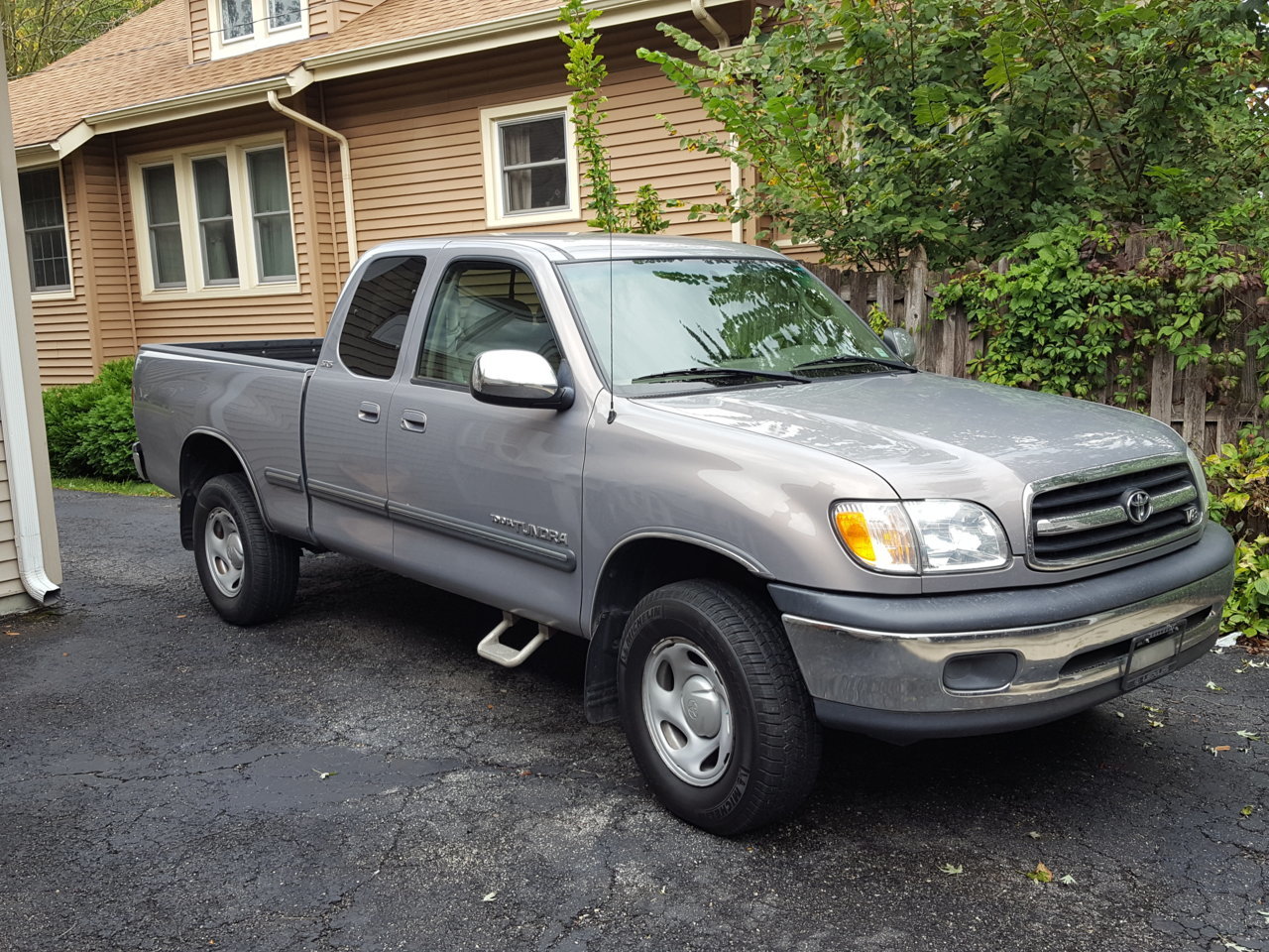

    Hi all, I want to level my front suspension on my 2002. Is it 1" or 2"? Are spacers ok? Truck just sees commuter duty, and is all stock. -Thx!20160921_112738.jpg

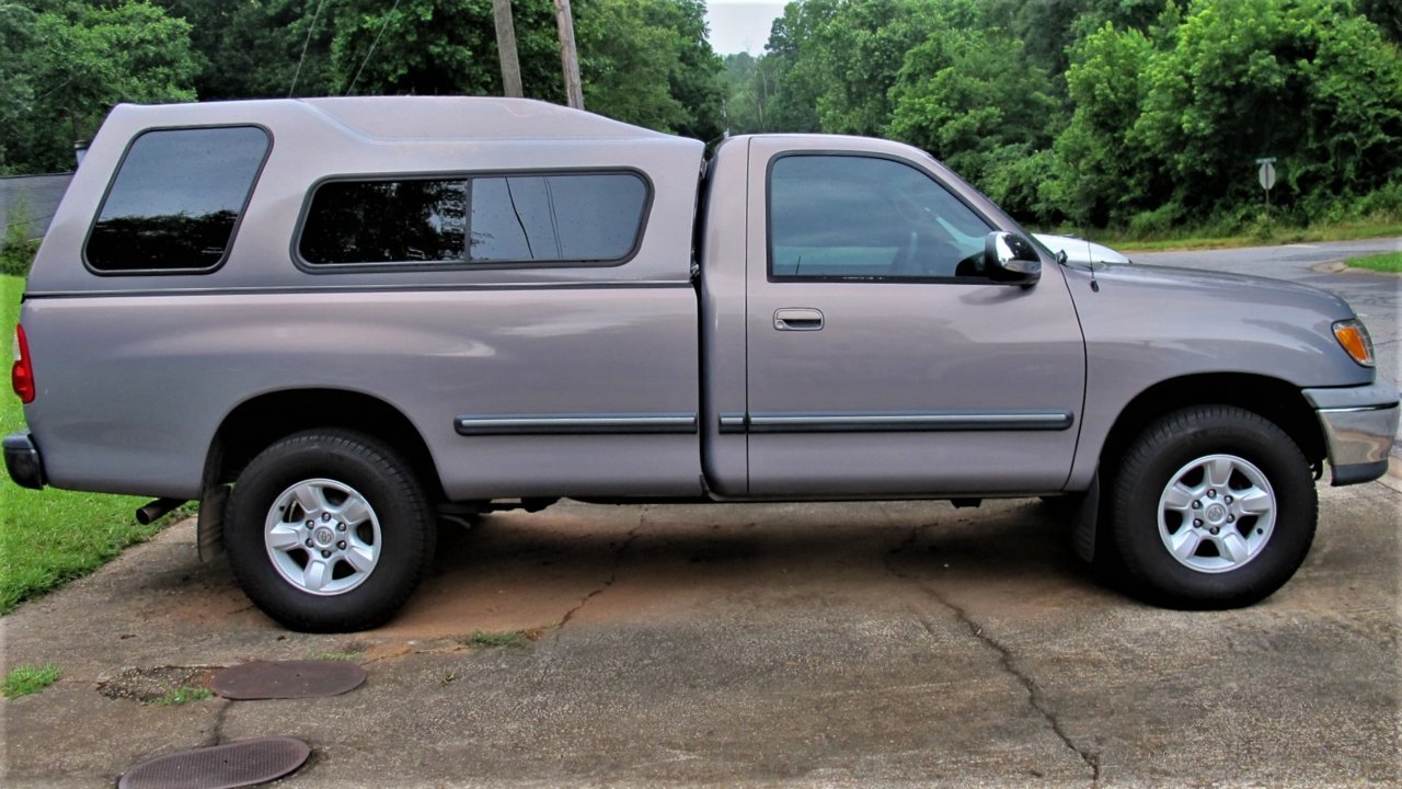

    I came close to leveling my '02 by swapping out the original coil springs with TRD 4x4 coils.IMG_1210.jpg IMG_6507.jpg

    I had heard there was a difference in these coils amongst the various options. This confirms why the TRD 4x4 sits differently.
