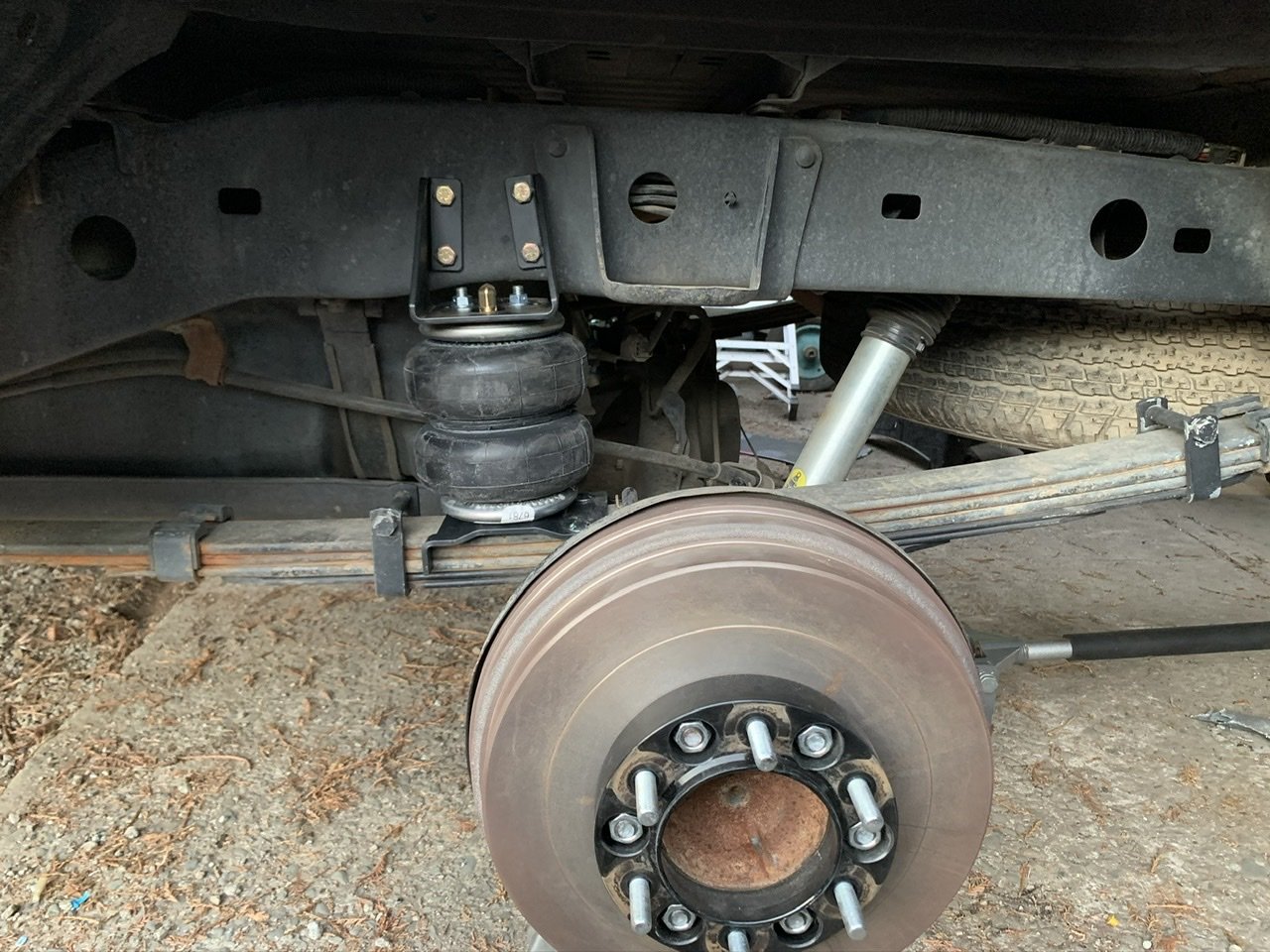

    Thanks for all the info and suggestions. I cheezed out and just stuck with the 265/75's. Not as beefy as a 285/75 for sure, but I get absolutely no rubbing. I did decide to get a little frisky and went with an MT instead of an AT this time - Yokohama Geolandar MT G003's. Surprisingly, they have very tolerable hum at freeway speeds.
    I still plan on making some changes to improve ride quality and I'm looking into airbags to help with the sag when towing.

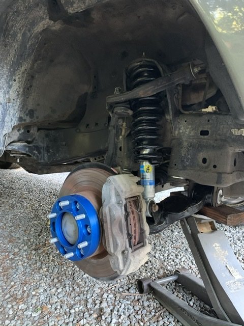

    What size spacer would be recommended to gain just a little clearance from the frame? I'm only seeing 1" or larger spacers in 6 X 5.5. Do I need that much? Anyone know of a .5" spacer?

    You can get spacers custom made in whatever size you want from this site: https://www.motorsport-tech.com/index.html
    You can get them made in steel or aluminum, with custom hub bore sizes, custom lug sizes, any option you can think of.
    If you want a .5in spacer though, you will have to select the "type 2" spacer when it asks.

    You can get pre-made spacers also, in sizes as small as 1/4in.. https://www.motorsport-tech.com/4DCGI/clickedRADIOBUTTONonPre_truck

    Thinner spacers will not have studs, as they are slip on. If running slip on spacers you will most likely need extended studs installed.

    Those BORA spacers look like they are going to be the ticket. Seems like they are saying the maximum thickness would be 0.25" before extended studs would be required. How difficult is it to get extended studs pressed in?

    Not hard, usually you can slip them in from behind after hammering the old ones out.
    Lisle makes a stud install tool that makes it easier.
