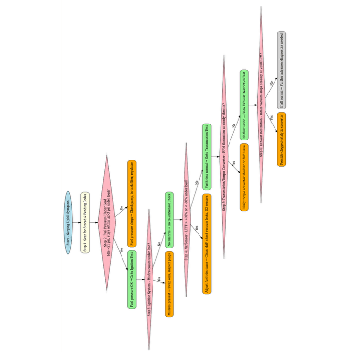

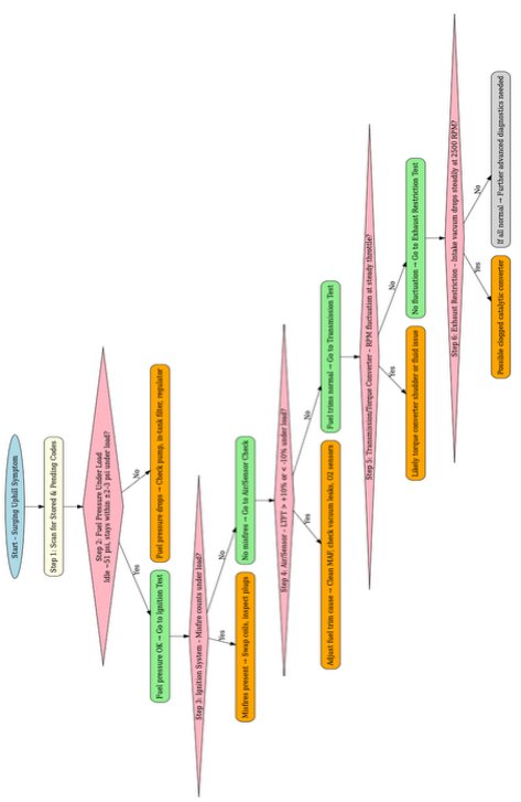

    I've been playing with chatgpt, so I put together a plan from that as to how to troubleshoot this.
    If you have any other ideas that are better please let me know. I'd rather hear from mechanics and Tundra owners from experience than have to use AI.

    Alright — here’s a step-by-step load-test procedure for diagnosing uphill surging on your 2013 Tundra 4.6L without throwing parts at it.
    Step 1 – Pull Codes (Including Pending)
    • Use an OBD-II scanner.
    • Check for both stored and pending codes.
    • Even if no check engine light is on, pending codes (like P030X misfires or fuel trim codes) can give clues.
    Step 2 – Fuel Delivery Load Test
    Option A – Using OBD-II Live Data
    1. Monitor Fuel Rail Pressure (FRP) while driving uphill.
    2. Idle should be around ~51 psi (Toyota spec).
    3. Under load, pressure should stay within 2–3 psi of spec.
      • If pressure drops → suspect pump, filter, or regulator.
    Option B – Without Scanner
    • Accelerate uphill in 2nd gear at steady throttle.
    • If surging worsens as RPM rises, it’s often a fuel starvation issue.
    Step 3 – Ignition System Test
    1. With scanner, monitor misfire counts per cylinder while going uphill.
    2. Swap coils from a misfiring cylinder to another cylinder and re-test.
      • If misfire moves → bad coil.
    3. Check spark plugs for gap, fouling, or oil.
    Step 4 – Air & Sensor Check
    1. Inspect intake boot for cracks or loose clamps.
    2. Clean MAF sensor (only with MAF cleaner).
    3. Check long-term fuel trims (LTFT) under load:
      • +10% or more means lean (possible fuel delivery or vacuum leak).
      • -10% or more means rich (possible injector leak or O2 sensor issue).
    Step 5 – Transmission/Torque Converter Check
    1. Drive uphill at steady throttle around 45–55 mph.
    2. If RPM fluctuates without a gear change → torque converter shudder.
    3. Check transmission fluid:
      • Level correct?
      • Fluid still red and clean, or brown/burnt smelling?
    4. If shudder goes away when you slightly press the accelerator → torque converter lockup problem.
    Step 6 – Exhaust Restriction Test
    1. At idle, measure vacuum at intake manifold (should be ~18–22 inHg).
    2. Increase to 2500 RPM and hold:
      • If vacuum drops steadily over a few seconds → possible clogged catalytic converter.
    Step 7 – Narrow It Down
    • Fuel pressure drop + lean trims → Fuel delivery problem.
    • Misfire counts spike under load → Ignition issue.
    • RPM fluctuates without misfire/fuel drop → Transmission/torque converter.
    • Loss of power + rising exhaust heat → Exhaust restriction.
