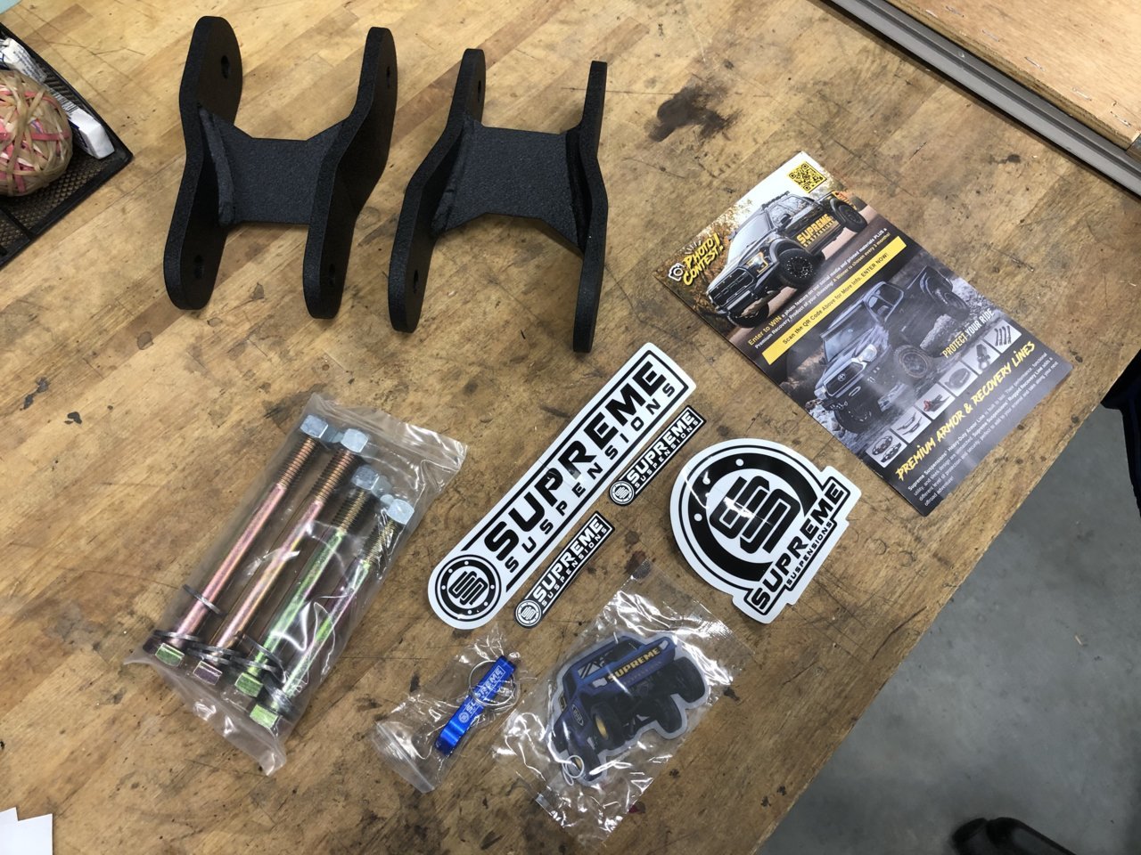

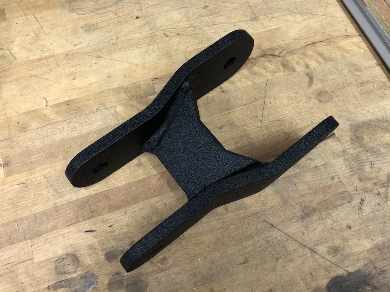

    My Supreme shackles showed up in 3 or 4 days.
    They pass my visual inspection. Welds look decent. There are a couple weld berries that weren’t removed before the cheap wrinkle coating. The parts look laser cut as opposed to plasma cut. Holes are clean, not tapered. Bends are crisp.
    The company claims US sourced steel on there website.
    Hardware is grade 10.9 with locknuts.
    I’ll update when I install.

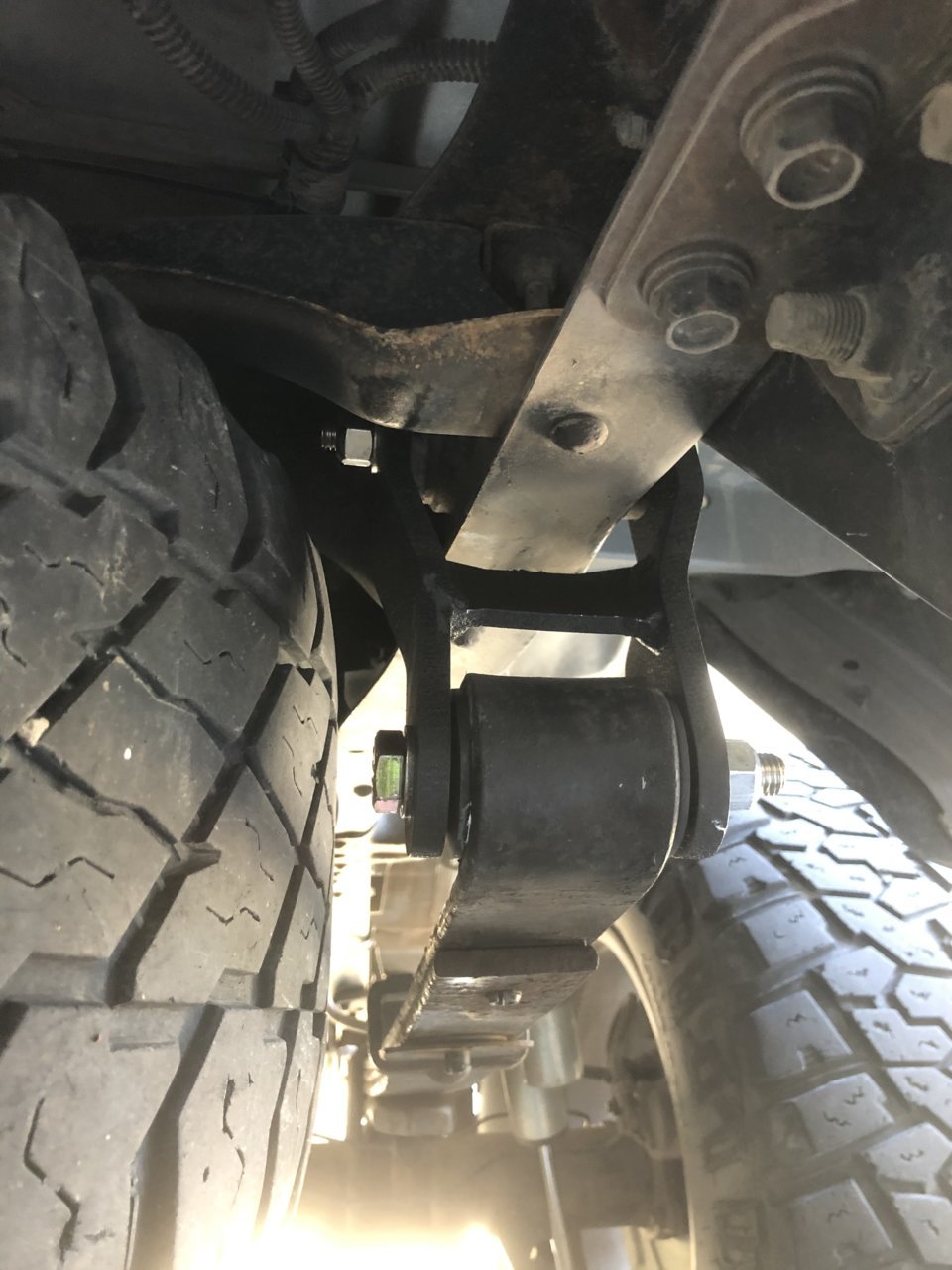

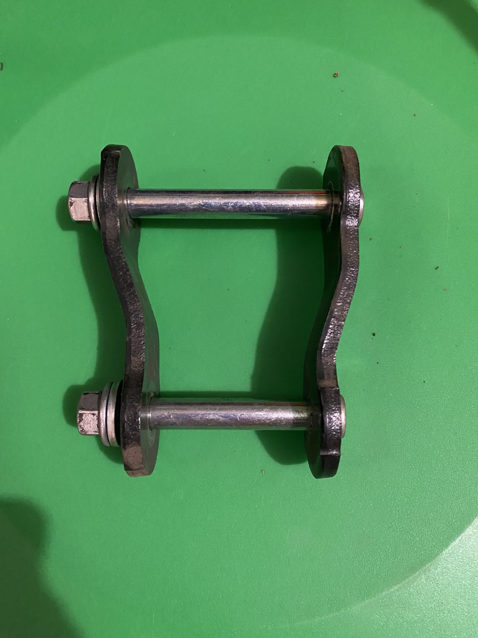

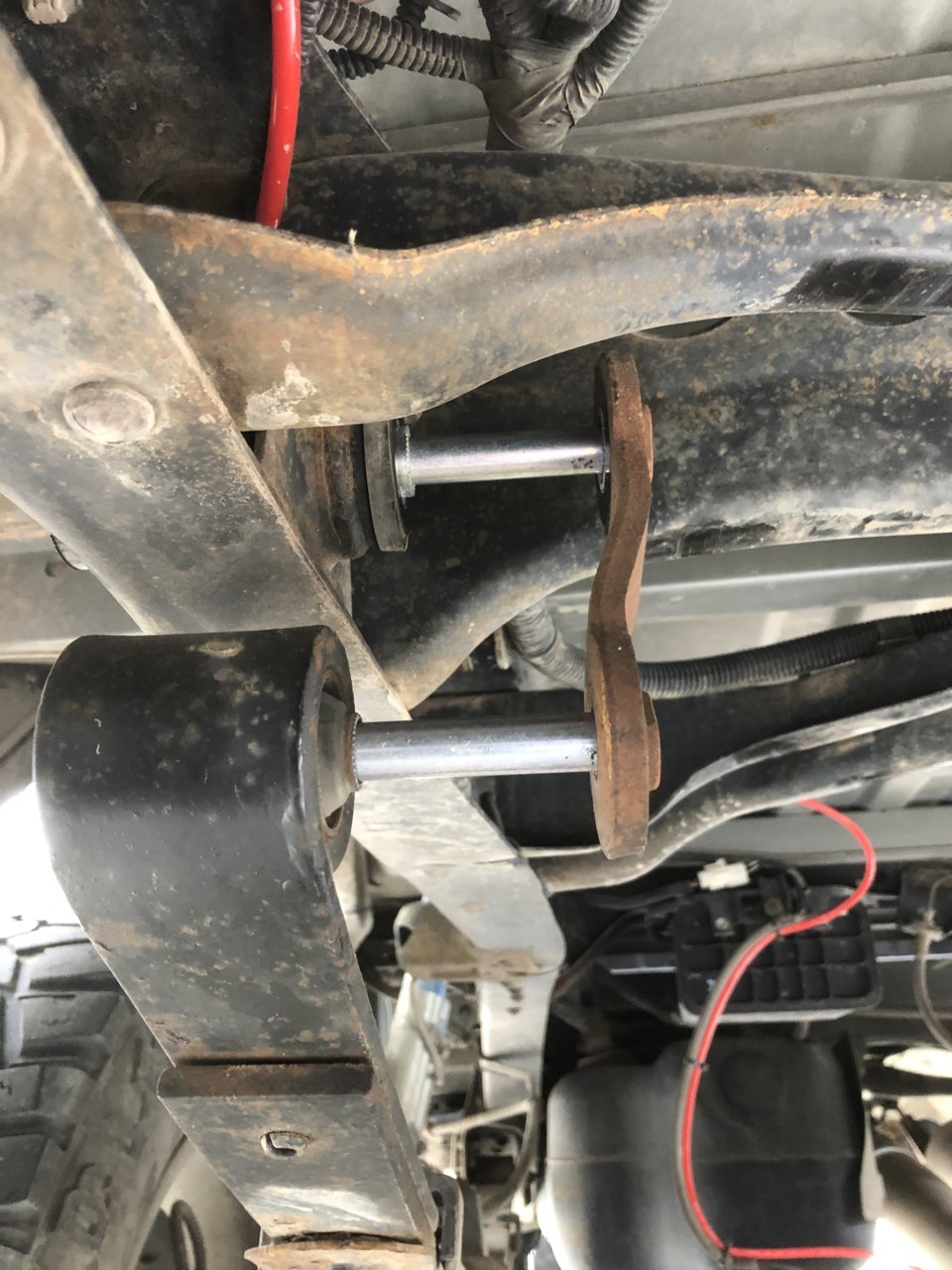

    Everything came apart clean but it looks like I will need some aftermarket poly bushings to make everything play nicely.
    Will report back.

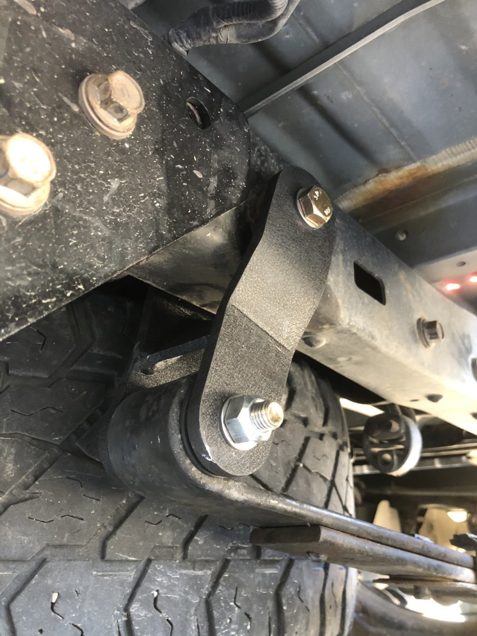

    Official Report:
    Good: The Supreme Suspensions shackles are just fine. The welds are large and wetted-in well without any undercut. Claimed US materials. Full 3/8” thick steel, large gussets, and clean holes that align correctly.
    Less Good: I did have to widen the smaller end of the shackle 1/8” to fit the Coach Builder bushings.
    In my opinion worth every penny of $120 USD. Not Gucci or fancy but I trust them. Time will tell if I’m wrong.

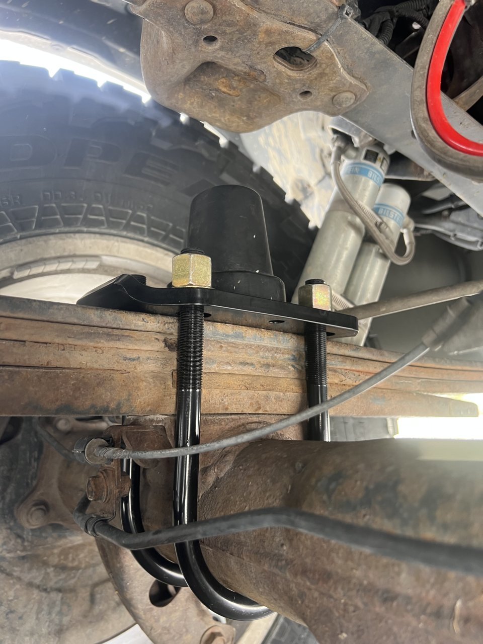

    Still look and function like new. I’m now considering Supreme’s ubolt flip kit……..or Archive.
