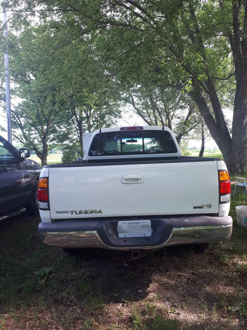

    So I just bought a 2002 Supercharged 4.7L Tundra and I just had some general questions that the Toyota Dealerships cant answer.
    1.) What kind of Supercharger oil goes the truck use and where do I change it?
    2.) Anyone know of a vendor that sells replacement parts?
    ~ Thanks for any help
    Also Gonna be making this like a story of my truck. So any improvements/upgrades or problems that I have I will post in this thread so that maybe one day another person may have a supercharger with lots of questions that can be answered here :)

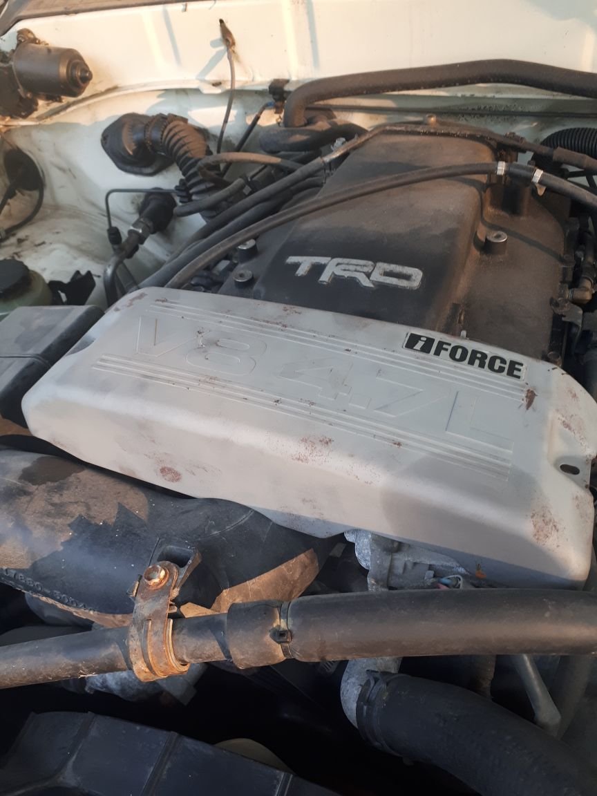

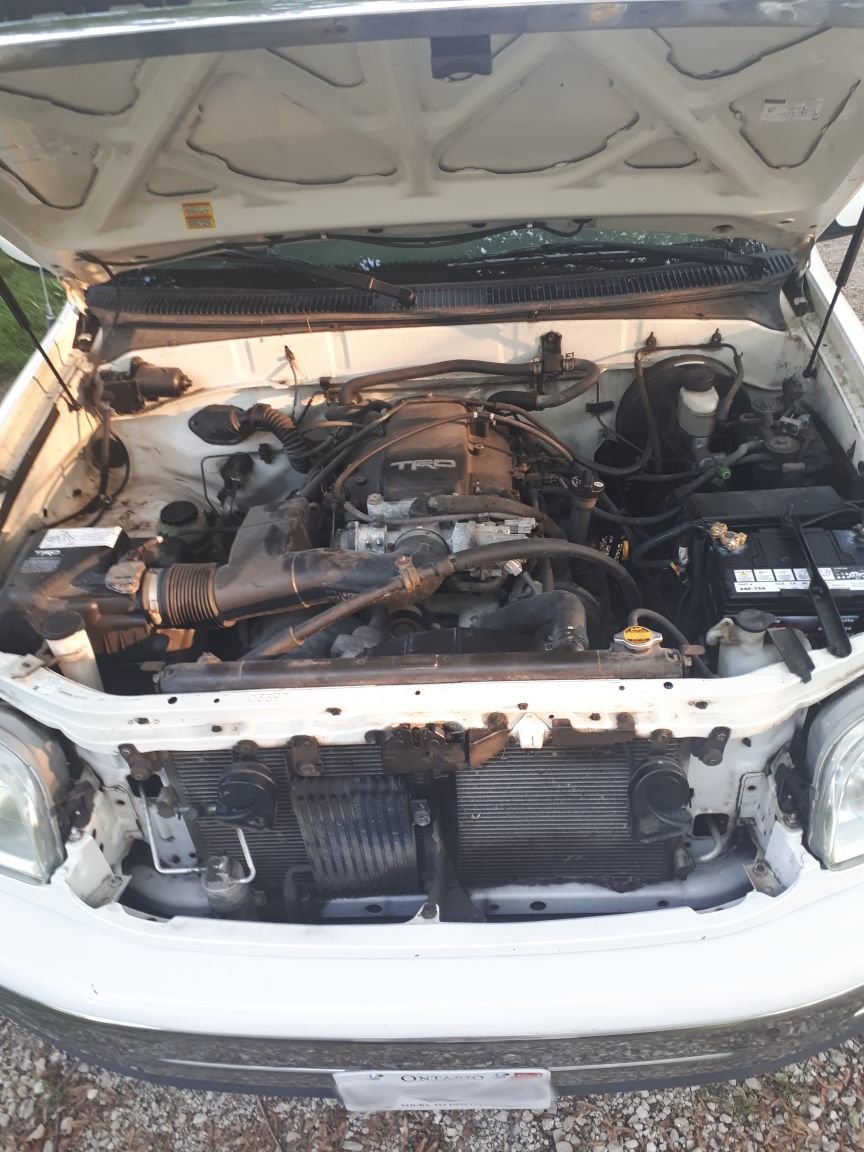

    Ive seen in the Topleft of the engine bay via the image below that some truck came with a brake booster booster? Idk it connects to the break booster was just wondering what it was.
    Also has anyone ever tried to retro fit the 4.7L cover over the ugly mess that is by the throttle ?

    Nice! With Ivan Steward Wheels no less, great find!
    Forgot to ask if its 9th or 9th and 10th injector w the computer? I'm guessing 9th with a TRD Piggyback.
    Not sure I know what you are mentioning on the brake booster booster.....top left in your image is the windshield wiper motor.
    Also, getting those rear fender "protectors' off is a royal pita, DO NOT use a heat gun like I did, my detailer told me to use steam (haven't tried the other side yet).
    Let me know what other parts you are looking for, installed mine last year and still have all PNs and places to find...
    That link I attached they rebuild the Magnusen units if you need. You should be in good shape though, how does the serpentine belt look? Easy to throw a new one on for peace of mind and start baselining all of your fluids...

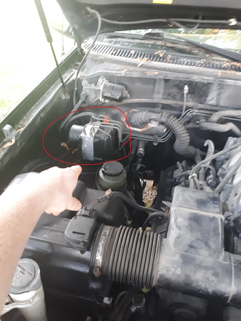

    Not sure on how to check the injectors, So I have no idea :)
    I ironically own 2 Tundras now and this one has what I was talking about
    Aha yes I have read about the belt and I dont think its ever been changed but since the truck has sat for afew years I should give it a go just for safekeeping.

    It’s an Eaton m90. GM supercharger oil works I believe.

    That’s the ABS pump. Your new truck doesn’t have ABS

    Oh, weird. Same year higher trim level and they just throw out the ABS interesting :D

    Abs was optional. All my tacomas don’t have it. But my buddies base model same year does.

    OP-that brake fluid looks like motor oil. Might be time to flush. Very nice truck though. Always cool to see a supercharged 1st gen still around. How does the frame look?

    The truck had an interior oil spray so that's why the brake fluid looks dark af :) Haven't got around to clean the bay out yet abit hesitant to just power wash an engine
