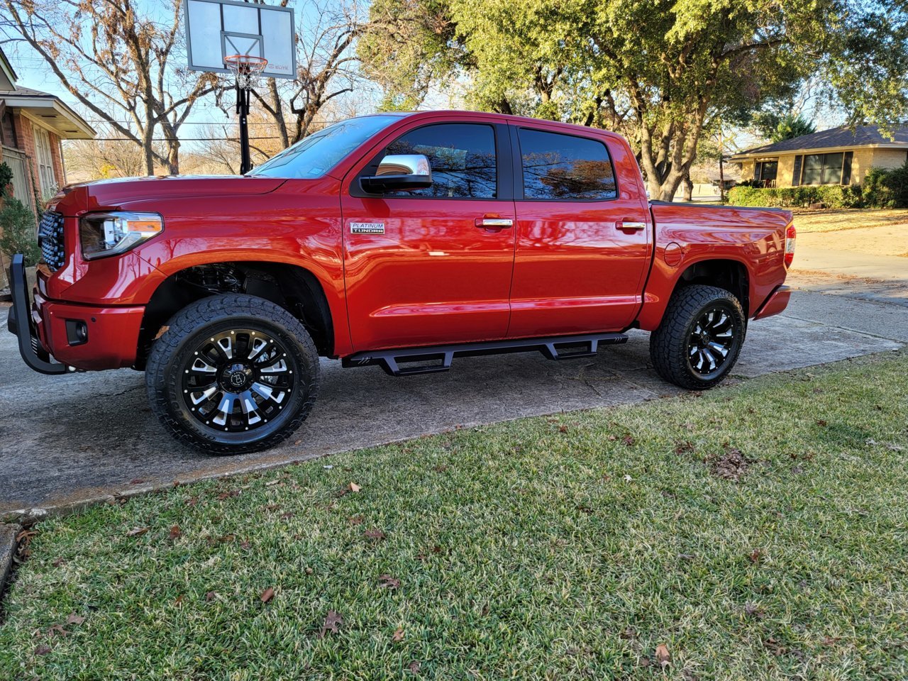

    Jeff
    2021 tundra crewmax platinum
    3"readylift suspension on 295/70 toyo A /T 2
