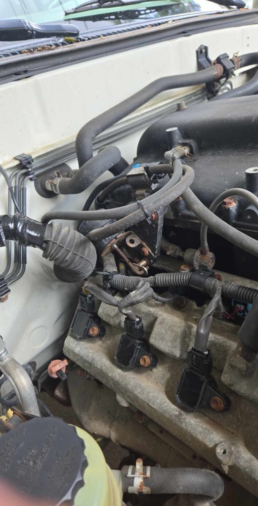

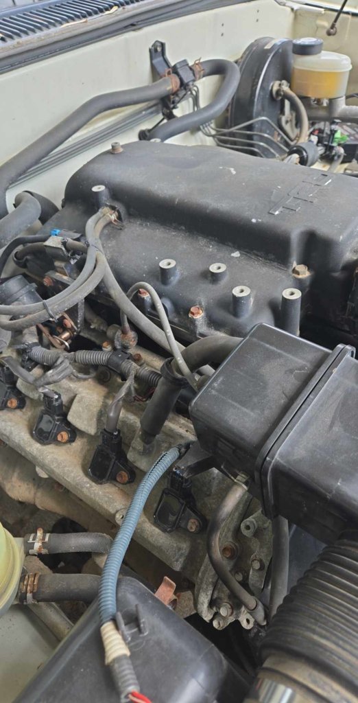

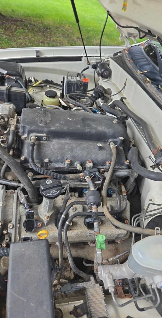

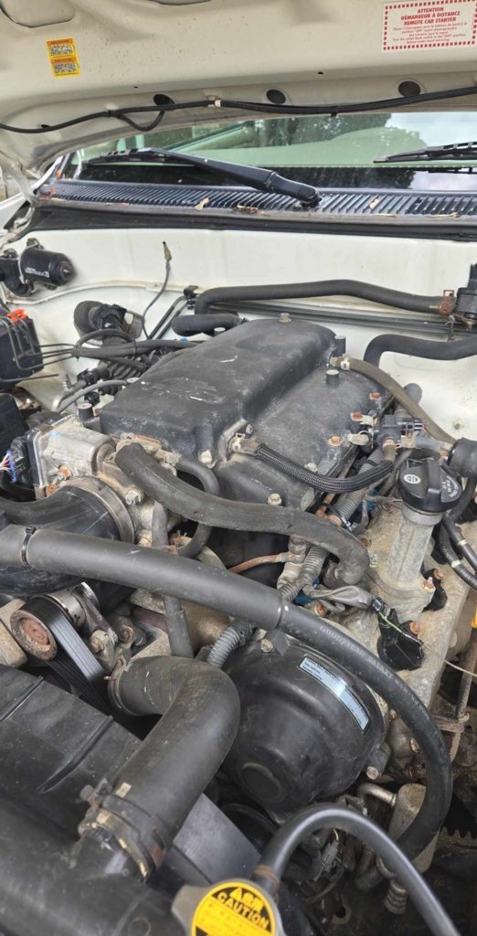

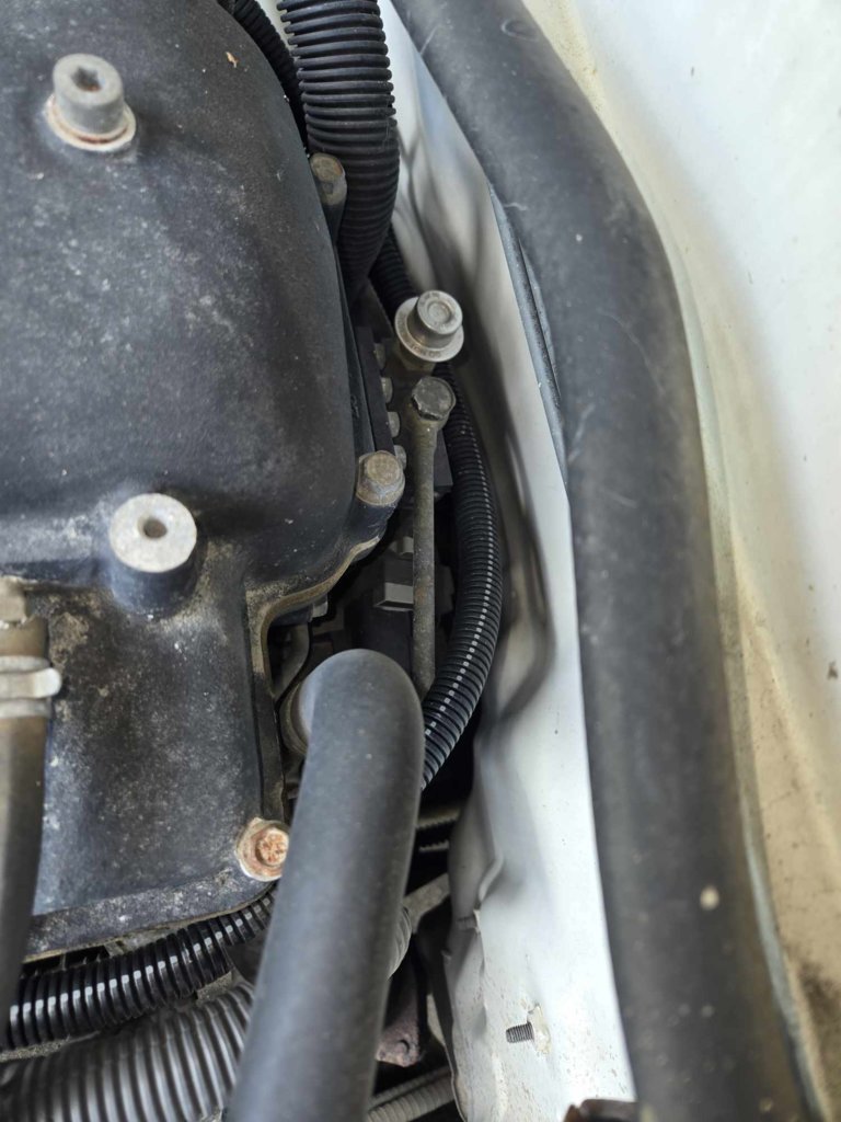

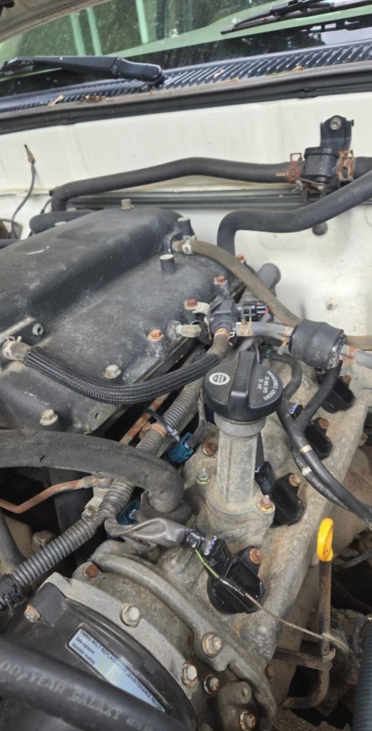

    Can any one help identify if this TRD supercharger has 9th injector or 9th & 10th injector?
    This is on a 2003 Tundra 4.7

    Doesnt appear to have a 9th or 10th injector at least from what is visible. Not sure where they put a 9th injector on that unit but i cant see one.
    How does it run?
    Where is it located?
    Is it for sale?

    Was running but the piggy back trd ecu no longer work. Toyota no longer make or sell the piggy back ecu for the supercharger, so Im trying figure if it has a 9th or 9th & 10th injector for the aftermarket ecu im looking at. Cars been down for 3 month now, searching for a fix.

    @bfunke thanks. so its 2 injector base on reading the pdf
