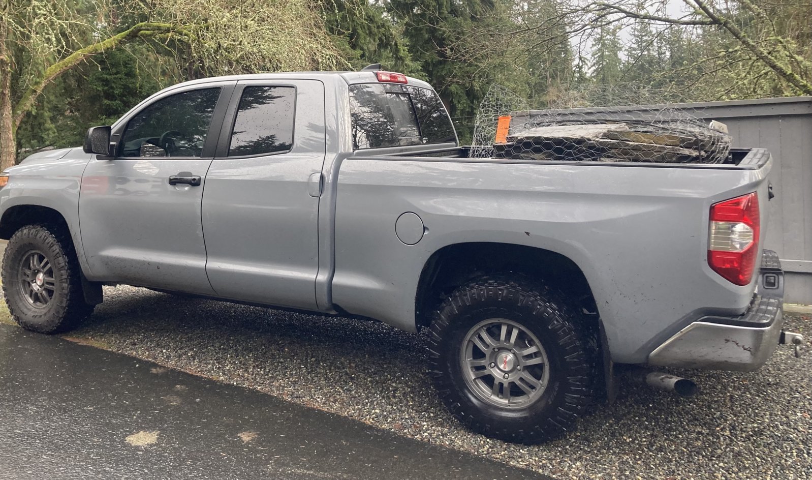

    I have had a set on two different Tundras, both the blue ones. They worked well for my application and installed myself (you are supposed to get new ubolts though). They are essentially maintenance free. Totally unloaded they can make the truck more bouncy. A benefit though is they do act like a sway bar as well and make you corner more upright. They likely would work great in your application, airbags you could set the pressure as applicable so there are pro/cons between the two.
    (In the picture stock ride height the sumos just barely touch the bump stop bracket, unloaded. Whereas this is a 3” lift so I added more sumos).

    Oh no problem. I used the Tundra specific ones on the bottom (and used them before so liked how they did), but then obviously there’s a gap with most lifts. So to fill the gap I found a version (there are many) that have a bolt on the top. I then drilled a hole through the top bump stop and cut the top sumo springs to the height I thought would work well, where they barely touch unloaded. Since they’re closed cell foam you can just cut them down and leave as is, I used a sawzall. Installing I just jacked up the body on either side and slid them into place and bolted down. The blue foam I believe is 1000lbs when compressed 50% (not sure if it’s per pair or per spring), meaning they aren’t stiff but not super soft in my experience.
    This is with 2k+ of rocks in the bed and went down about an inch or two (vs when I used to do this with stock suspension it would be on the bump stops):
