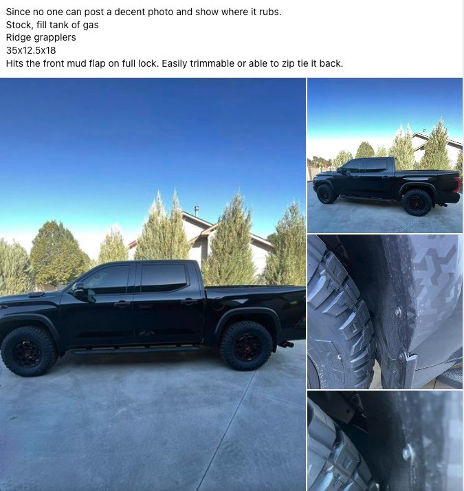

    I'm assuming some 35s are larger than others? Saw this post on a Facebook group, and someone said it rubs on a TRD PRO so thats why im hesistant on putting 35s on without a lift

  13. Nov 3, 2022 at 1:19 PM
