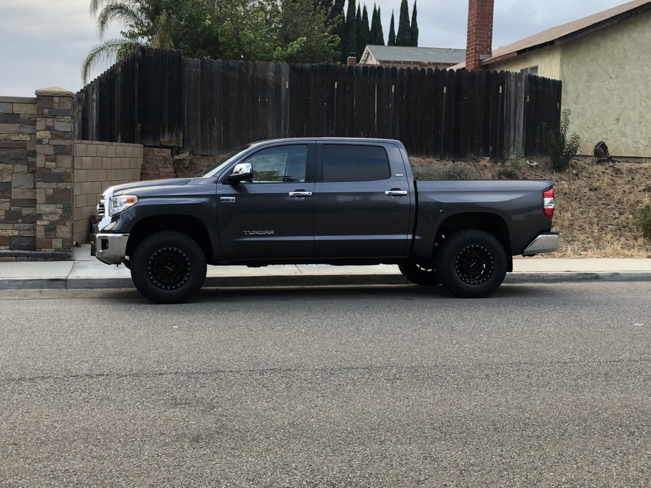

    dcsleeper408

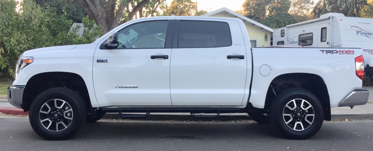

    D975E298-0598-4ED1-8596-8B1B520FC0CA.jpg Welcome! I’m running the Toytec/Eibach set up and I love it. But I’m running the 3/1 set up. I came from Kings on my last truck and although these don’t compare the same I really like them! And I highly recommend them.

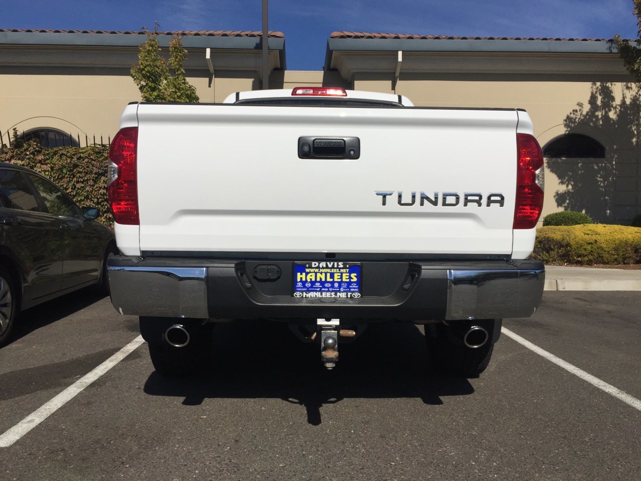

    I was considering Eibach/Toytec with rear shackles, but already ordered my Borla out the back dual exhaust, and didn't want exhaust problems that dropping the leaf springs with the shackle could cause. Like I said, my 2008 has Ready Lift leveling kit up front (metal spacer over or under the shocks, forget which), and 1 inch block in the back to maintain some rake. With the light off roading I do, the ride has been fine (seemed similar to stock), towing has been great, and I have had zero problems with that simple lift for 10 years. So this time more advanced and yet still simple seemed like the best solution for me. Plus, even though this is my personal inheritance money, I am also trying to pay off our 288K mortgage (there won't be much left, but no $2,300 payment per month ever again - thanks Mom), and I don't want too many complaints from the wife. Plus I already ordered the exhaust, and rear TRD sway bar for better handling, and next week will get Line-X bedliner, and have towing mirrors installed.
    I'll definitely share pictures when it's all done. And thanks DCSleeper for the recommendation on Stellar Built in Sac - I had already found their amazing reviews online, have talked to Dimitri (he's great), and he's installing the lift on Tuesday. Does anyone know if the sway bar needs to be installed before or after the Borla out the back dual muffler system? I was hoping to have Dimitri install that too, but the muffler system will be installed later. Tundra Dude showed a video of installing his sway bar, and the toyota directions clearly said the recommended order of installs is trailer hitch, then TRD dual side exhaust (I'm doing Borla out the back), then the sway bar. My plan is to wait on the sway bar install b/c maybe it won't even fit with the dual exhaust running through that area. And it's coming from Amazon Prime, so I can return it hassle free if necessary. Does anyone have the Borla dual out the back exhaust and the rear TRD sway bar.

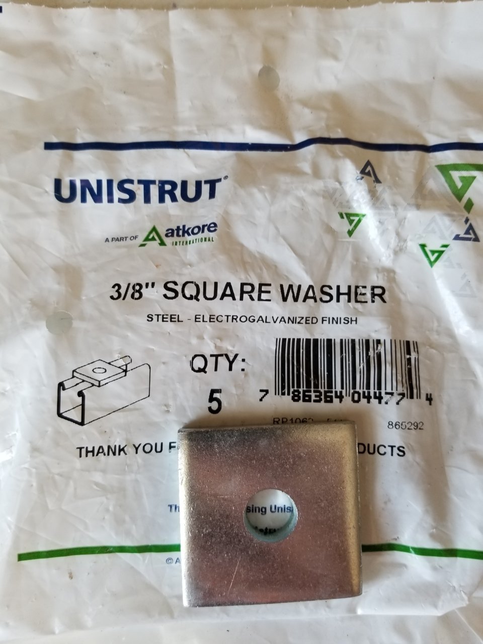

    This is what I'm using for my carrier bearing drop. Had to buy 2 packs as I stacked 3 to each side. Less than $10 at Menards.

    Here’s my truck after the install. I love it. Ride is great. Perfect amount of lift, with some rake still. TSS system working fine so far.

    For the carrier bearing drop I used the Unistruts Yoda1 showed in 1/2 inch size. Got at Home Depot. We stacked 3 for a 0.75 inch drop. Zero vibrations detected and I still need to get it aligned.
