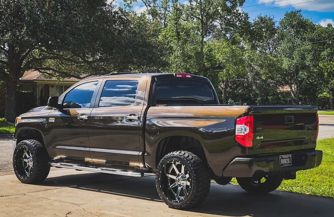

    What does this look like in your opinion? Believe guy said it was 3-4" with 22" wheelsIMG_0243.jpg

    I have no intentions of any hard-core off roading. Most mud/sand truck will ever see is at beach or on beach depending on where. Looking for a good stance and nice wheel so don't wanna go extreme with 6"+ lift
  5. Jan 29, 2021 at 7:47 PM
    Tundra_361
    Tundra_361 New Member
    May 17, 2018
    #15412
    680
    Victor
    2019 Black 1794 4x4
    Are you 4x4? I would think you’d need at least 4.5- 5 inches of lift and a body mount chop. Hopefully someone could chime in. Majority of guys on here aren’t running anything of 20’s
