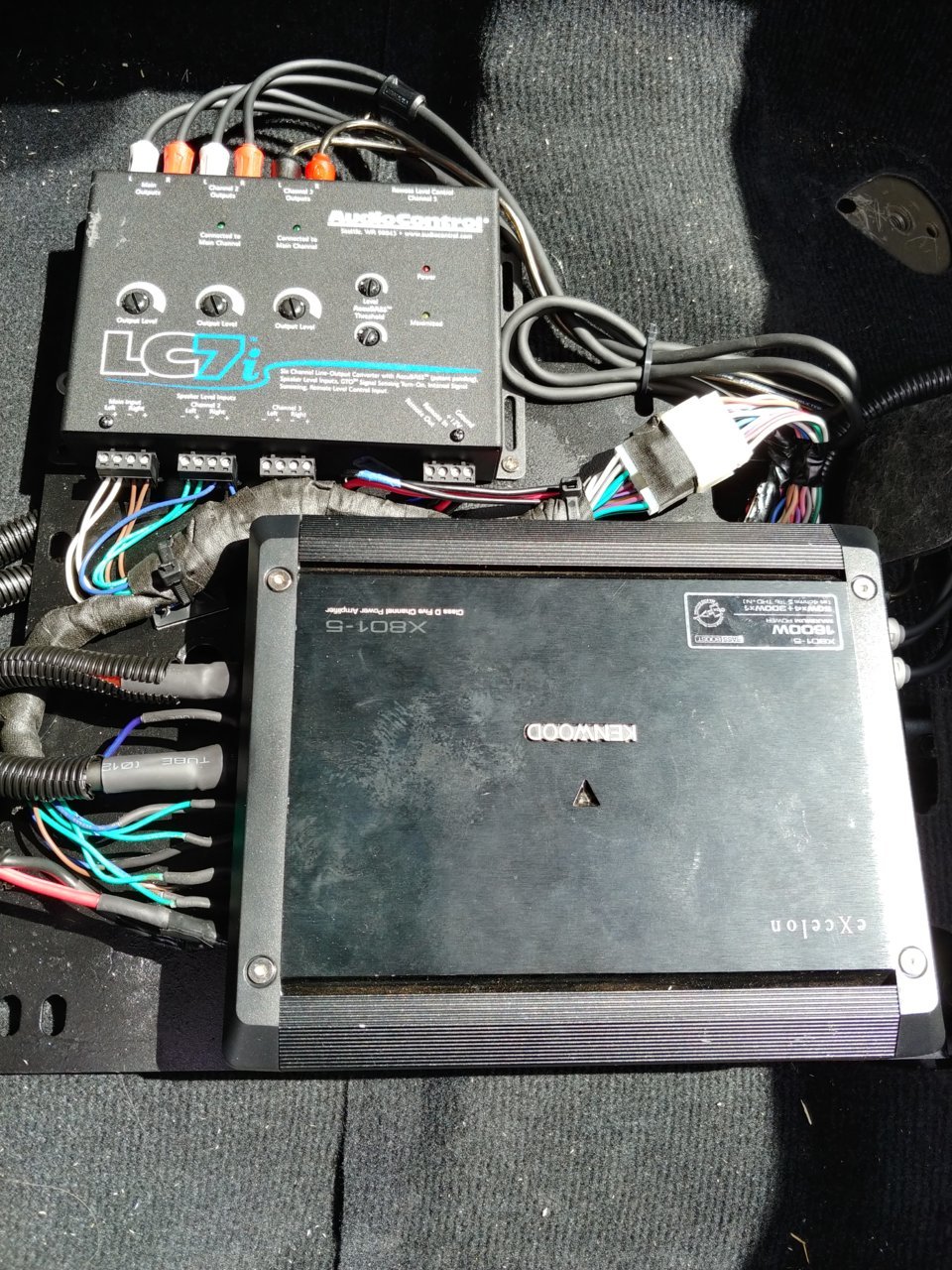

    Hey coop03 - Welcome and I will tell what I did with mine, even though its slightly different. I have a 2016 CM SR5.
    Since the factory HU does everything to suit my needs, there was no reason to change that.
    The factory speakers are not the greatest, but they arent too bad either and only rated at 2 ohms
    it wont take much to "drive" them.
    I did the work myself with the help of a fellow member who I threw every "dumb" question at - Thanks @1lowlife.
    I removed the factory amp and installed a new 5 channel amp and an AudioControl Line Out converter and a single sub behind the rear seat.
    Now the system sound amazing but I will eventually have to replace the door speakers at some point but it sounds awesome now.
    You might do yourself a favor and contact @james@tech12volts. He is the authority here when it comes to sound systems for our trucks
    and he will have something specifically for your setup and budget.
