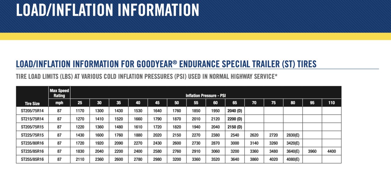

    We use a TST 507C for our trailer. I has a nice little screen that sits in the console measures temps and pressure and has alarms that you can set.
    We run our GY Endurance tires at 65 psi cold which does a good job of carrying the load. According to the chart below, we are running at a pressure to carry 5,080 lbs. with the 225/75R15 on ours.

    That's a good chart. Looks like I am actually running more than necessary on mine. 4 tires carrying maybe 7,000# total. I could be as low as 35 PSI for that load.
    I'm using a TireMinder i-10 TPMS. Probably works just like your TST. High/low pressure alarms, and high temp. I think the alarm goes off if pressure gets more than 20% above your set base, and 10% below. Temp alarm is around 130°F if I remember correctly.
