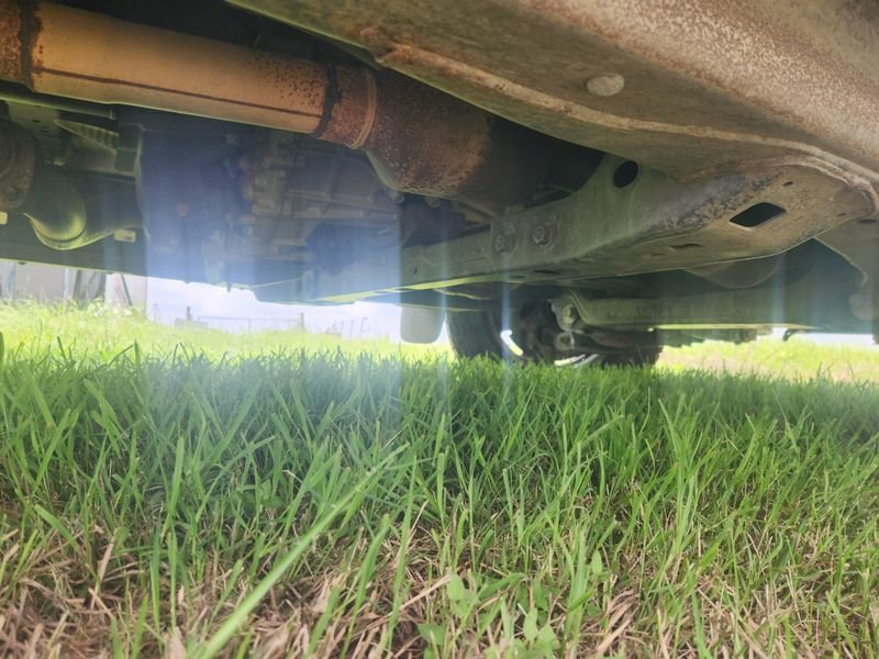

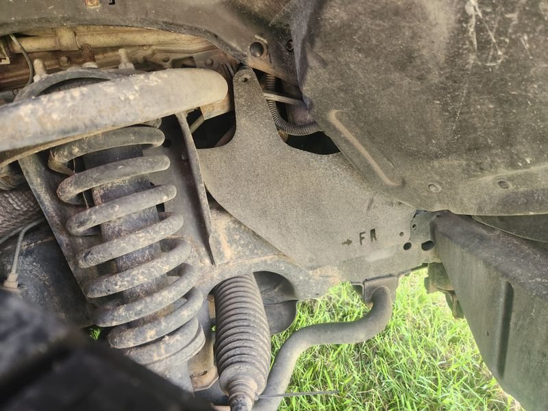

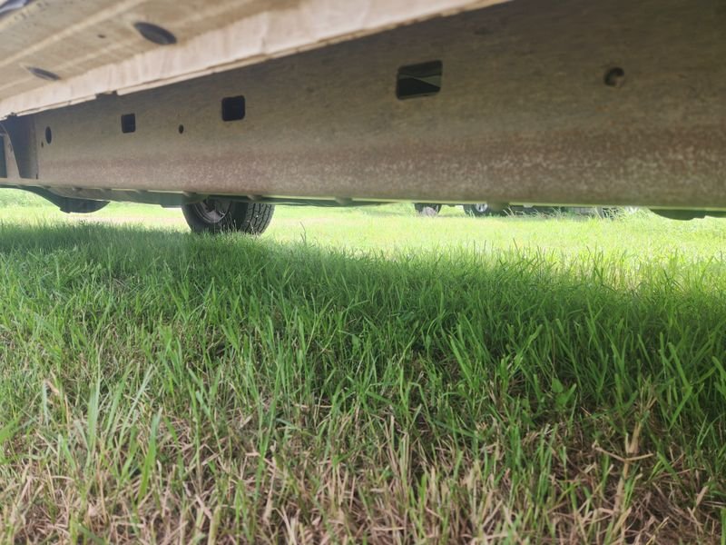

    That’s a lot of miles but provided it has service records and you check the frame for rust I wouldn’t be scared off. I always prefer 4am for resale value if nothing else, even if you don’t need it. That sounds like a pretty good deal provided everything checks out

    Here’s a couple pics from the underside

    Most Auto parts stores will rent out tools like a compression gauge to make sure everything's good there.
