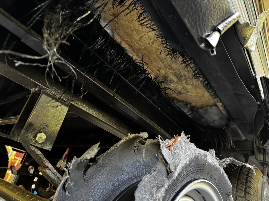

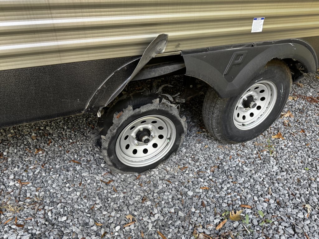

    Suffered a near catastrophic blowout towing our camper today. Somewhere on the route the driver side front tire completely shredded. Did not hear or feel it (still don’t understand how).
    Mostly straight drive and mirrors didn’t pick it up (tow mirrors now on order).
    Went about 20 miles on one axle until finally noticing and swapping out the spare.
    Thank God nothing worse happened. Just some repairs and new tires in the near future.

    4 years old is probably the problem, tread separated, or the tire went low, heated up and blew.
    In my towing thread I've had a few tire separation issues. Make sure you cover the tires when not in use. The rear tire behind the tire that blew will probably go next.

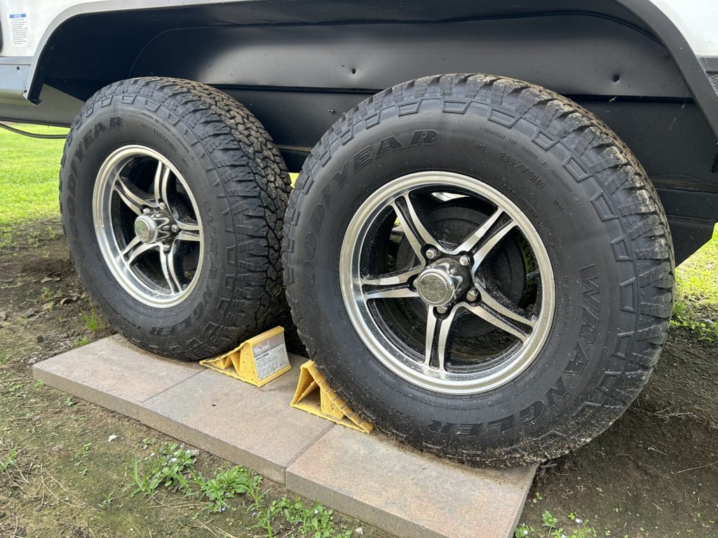

    This is why these Chinese tires are often called China Bombs. The Goodyear Endurance tires aren't immune if the valve stem fails. That's what I had last year. The rubber and brass separated causing a rapid unscheduled disassembly of one of my tires. My TPMS didn't catch it. Probably because I needed a range repeater and didn't have one. My Chinese spare held up until I got to a tire shop that had 4 new Goodyears.
    Take the time to get them balanced and get new valve stems. I was hoping there was a more durable valve stem available but was told there was not. I now have the TPMS repeater and aim my clip on mirrors, like the OP has, to see my trailer tires.

    It is the age of your tires. They say that 4 years is the max on most trailer tires sold today. This is very true on a travel trailer where the tires tend to be loaded to their max.
    Tires start to degrade the day they come out of the plant. The rubber starts to break down. Cheap trailer tires use cheap materials, cheap labor and cheap process control. The cheaper rubber etc. only hurts this life.

    I can't agree more. Trailering is an expensive hobby. Tires do not last!
    Replace all of them every three years. Mileage and visual condition do not tell you what is lurking below the surface.
    I try to put automotive tires on my trailers when I can. However, you will almost always need a significantly bigger tire than the equivalent size trailer tire. Automotive tires are not rated for as much weight..... But they last a whole lot longer.... Parallels here?

    The other issue with campers and tire blowouts is look what is directly above your tires. It's usually the refrigerator (not cheap), outside kitchen, a large slide with all the guides exposed, hot water heater, propane line...etc.
    On long trips, I've started to carry two spares.
