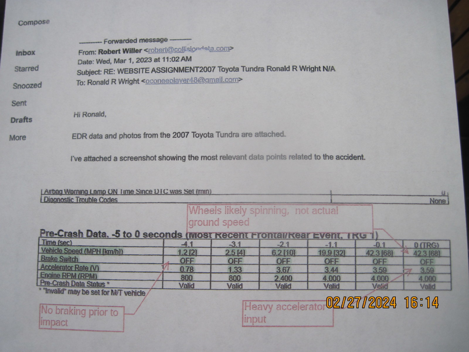

    Where is the precrash data table from the black box? If you paid an engineer to access it he should have given you a pdf report.
    The data will show throttle application %, Engine RPM, Brake On/Off and Vehicle Speed at every 0.50 seconds for 5.0 seconds. If Throttle % is up high, engine rpm is up high and no brake application her foot is most likely on the gas pedal. The throttle value 0-100% is generated directly at the pedal.
    I have seen several times where a throttle application happened instead of a brake. Generally this leads to cars inside of buildings ect. Most common when people are trying to park. It happens more that you would think.

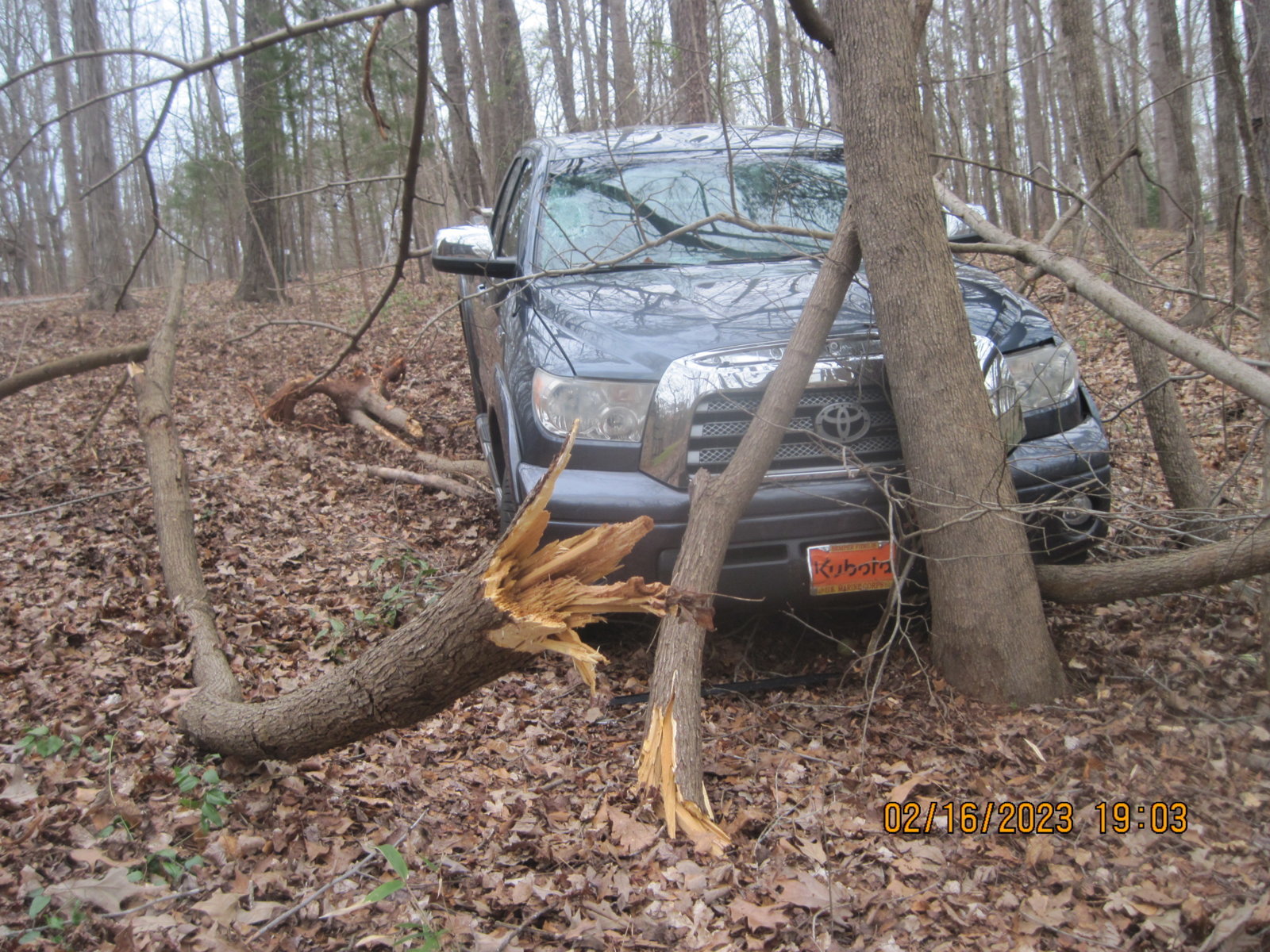

    Honestly the the damage to the front of the truck doesn't quite look like a 42 Mph impact into a tree. You would expect to see more damage/deformation of the front body panels at that speed, the grill doesn't even really look broken.
    1 Mph to 42 Mph in 3 seconds is a pretty good acceleration rate however, like a 0.60 g

    The computer shows the brake was never activated. See the brake switch “off” entries? Saying someone is trying to stop but never hit the brakes doesn’t make any sense. I know it all happened very quickly but the evidence isn’t favorable and the burden of proof falls on the claimant.

    I am in no way defending Toyota nor am I trying to downplay your wifes injuries. I completely agree with you that these kinds of incidents are more personal when it is someone you know or love, part of the family.
    I myself am one of those engineers and I have been investigating accidents for years most of which involve a fatality. I actual know of Collision Data. I have downloaded hundreds of passenger cars of all make and model including many Toyotas. As far as taking on an OEM, as I said that is a hard hill to climb. I know one incident that left a young lady paralyzed due to an alleged airbag fault. Her attorney is worried about trying to take on Toyota. Its expensive with low odds of a favorable outcome. It just a sad reality that ligation against big business is very difficult.
    A few things about your data. Time 0 the last data sample is the time the airbag deployed, there is no data recorded after the impact with the tree. You get 5 seconds of data because that is what is mandated and required by the recorder in all vehicles. This event started 2-3 seconds before the impact with the tree. No brake application at all, heavy accelerator input starts and continues to the end. The voltage signal 0-5V is created by the throttle pedal on the floor. To get a change in reading the pedal has to be depressed. Engine RPM shoots up to 4,000.
    Impact speed is more like 20-25 Mph, your engineer even comments the 42 Mph reading is likely wheel spin, which it is. Wheel speed drives the Speedometer gauges on these trucks, them spinning in the dirt with no traction creates higher reported speed than actual speed. The vehicle can not accelerate from 19.9 Mph to 42.3 Mph in 1.0 second this would be over 1.0 G acceleration rate and not even high end sports cars can pull that off on a dry pavement surface. A truck certainly can not do that on an off-road dirt surface.
    The report will show a longitudinal delta v or instant change in velocity at impact. This should also be 20-25 Mph, meaning when truck hit the tree it was going 20-25 and at the end it was going 0. The change instantly is 20-25 mph. This is measured by the accelerometers in the ecu that was downloaded. I should also add it could be a tree she impacted prior to the one the truck is up against triggered the airbag. If so the truck rolled to a stop up against the a secondary tree in the photo. This scenario would be a lower delta v as the truck doesn't instantly go to 0 mph at impact.
    I am truly sorry your wife had to experience this. As I said I am not here to take any sides, I will however provide some observations on what I see to help give some insight.

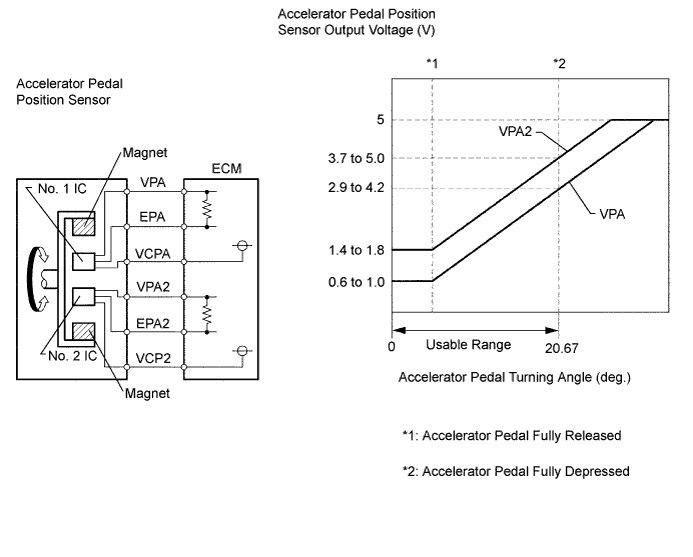

    @Jeff_5_7, is the 5V accelerator ever converted to CAN and then acted upon by other ECUs, or is it straight to ECM where the ADC occurs? In my novice electronic projects I've had data corrupted by bit slip post conversion/during transmission.
    *By no means am I suggesting that happened here.
    Jeff_5_7 likes this.

    Yes it is converted to a digital CAN signal.
    The way I understand it, the accelerator pedal is drive by wire consisting of a two potentiometers operating on a 5V scale. The voltage varies with throttle application and this signal voltage is fed into the ECM, the ECM then takes it and sends voltage controls to the throttle position sensor or butterfly valve in the intake to bring in more air.
    The ECM broadcast throttle position on CAN bus but the one I log reports it on a 0-100% applied scale. I assumed the actual voltage values from the potentiometers can be read as well as this download data is stored in the SRS airbag module. The CAN would be the only way for the voltage value to make it from the ECM into the SRS module. There is an entire 8 Byte data packet related to throttle only broadcast by the ECM on CAN. (Msg ID: 0x2C1)
    I had thought I read once that the Toyota unintended accelerator was a code error "bit that flipped" scenario inside the ECM. Meaning you could remove the voltage signal from the accelerator pedal but the ECM passing the data onto the throttle failed to removed (or inverted) the voltage signal keeping the butterfly valve open in the intake. If this is true the pedal would be near 0v (less than 1v) while engine RPM was still high or climbing.

    That's what I was getting at. A14 is analog to the ECM where digitization occurs. Since D9 is commanded by CAN 0x2C1, a bit flip/rot scenario seems possible for inverted output, but you'd expect accelerator position to then be 5V or 100%; not the shown 3.44-3.67V. That's also why I mentioned bit slip, since a hiccup in clocks can result in varied output. I'm curious to know if the pulled accelerator data is analog or CAN. Given Toyota's stance, it seems like analog is reported, not CAN from the SRS module.

    My interpretation is that D9 is also analog potentiometers controlled by the ECM. In addition to that the 0X2C1 message is sent out to all the other Ecus on CAN.
    All of the data from the "download" is stored in the EEPROM of the SRS (also called airbag control) module. It receives vehicle parameters (Speed, Rpm, Brake, Throttle ect.) via the CAN bus as it has no other direct link to the ECM, ABS or other Ecus. Acceleration data is received from internal accelerometers in the SRS module. The SRS modules decision to deploy the airbag is also the trigger for it to save the CAN "buffer" data into the EEPROM to create a "downloadable event".

    I don't know if full throttle is 5 volts on the tundra. Many low voltage sensors don't peak at 5 volts so i wouldn't make that assumption, but what does interest me is the flucuation in the voltage when the throttle is alleged to have been pinned wide open by a computer flaw. The freeze frame data shows 3.67 volts, then 3.44, then 3.59 (twice). Part of that makes me think it wasn't a glitch, but the 3.59 twice makes me think otherwise. I'd guess that it's more sensitive than that. To be able to have the exact same reading 1 second apart on the throttle as the truck is launching into the treeline. It would be interesting to have the voltage data for the throttle graphed on the truck to try and replicate it.
    Edit: nevermind i just saw the 3.59 numbers are only 0.1 second apart. The flucuation in the throttle input voltage makes me think operator error. 74 year old woman driving an unfamiliar vehicle...uhhh sorry man. That's why all the pharmacies and post offices here in FL have giant bollards in front of the handicap parking spaces. To keep the old people from crashing into the stores.

    For sure, I was oversimplifying. Anything 4.7ishV+ (assuming it is a 5V line) would be "pinned" IMO.
