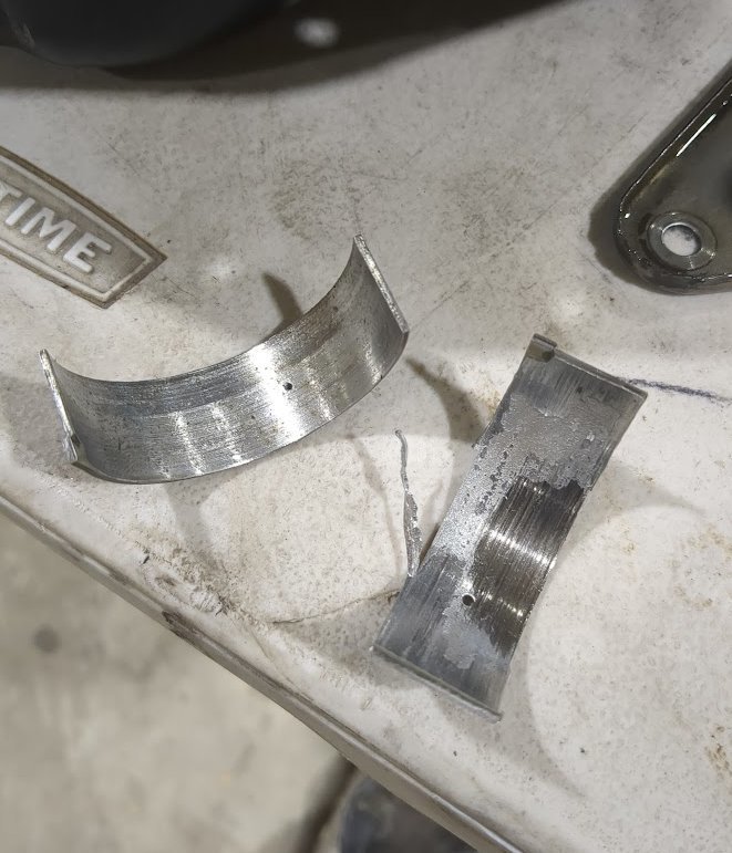

    There's a lot of denial in this thread about bearings going out causing issues. On a completely different powerplant (a Toyota 2JZ engine) I had a few weeks ago a bearing go out. The truck kept running and even drove home, no bad noises or anything, but it started running rough and oil pressure was behaving weird. Initially as I got a mile down the road there was a weird feeling, the truck still had plenty of power but it was like the there was more drag on the truck and it wasnt as effortless to maintain speed as it was before---ever so slight I thought I was insane so ignored it.
    I don't post this to scare OP, but to make a point to that a bearing slowly degrading could certainly have slowly building issues and cause more resistance on the drivetrain. Mine completely catastrophically failed (you can see a sliver of metal hanging out on the right half) and it still ran and drove home, and I didn't know what was wrong or what the issue was until I fully took the engine apart.
    With all of that said, OP it's probably just the winter blend of gas and big tires and a lift. I wouldn't worry about it.
    PS don't reuse your rod bolts because you're lazy/cheap :D
