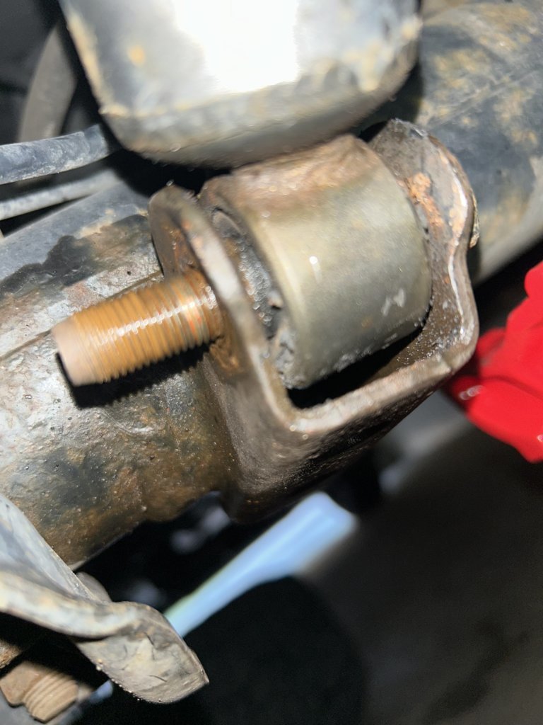

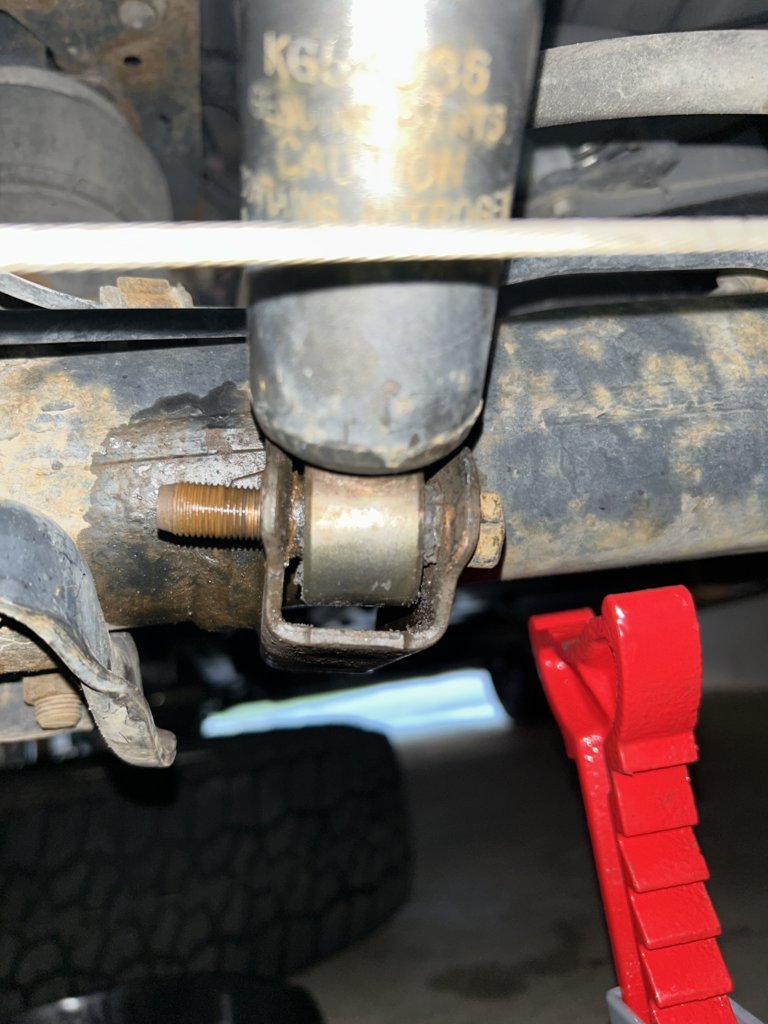

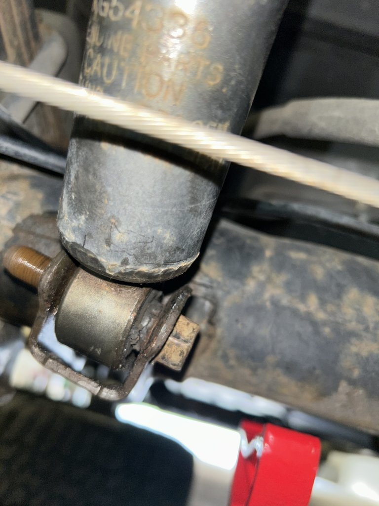

    Just my luck that the ‘easy’ bolt gives me problems. I’m replacing the rears and front with 4600s but currently the lower bolt for the driver side rear shock is stuck. I’ve taken the nut off but the bolt won’t budge out. I’ve tried wedging stuff in there but the bolt just spins along with the spacer/bushing. I have the truck jacked on the diff only. I tried fully removing the top portion of the strut and extending it out. I have not tried a proper smaller pry bar but that might be the next step.
    Any tips?

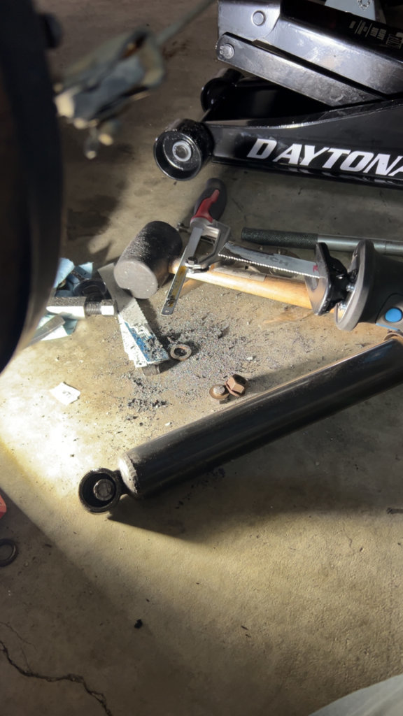

    Wanted to give an update in case someone else runs into this. I removed the saddle for the leaf springs to give myself more room but whacking it did nothing. The spacer was basically fused with the bolt at this point. I think heat might of worked but I ended up just cutting the bolt. Gave me an excuse to buy some more tools at least. Total PITA but I’m glad it’s out.
