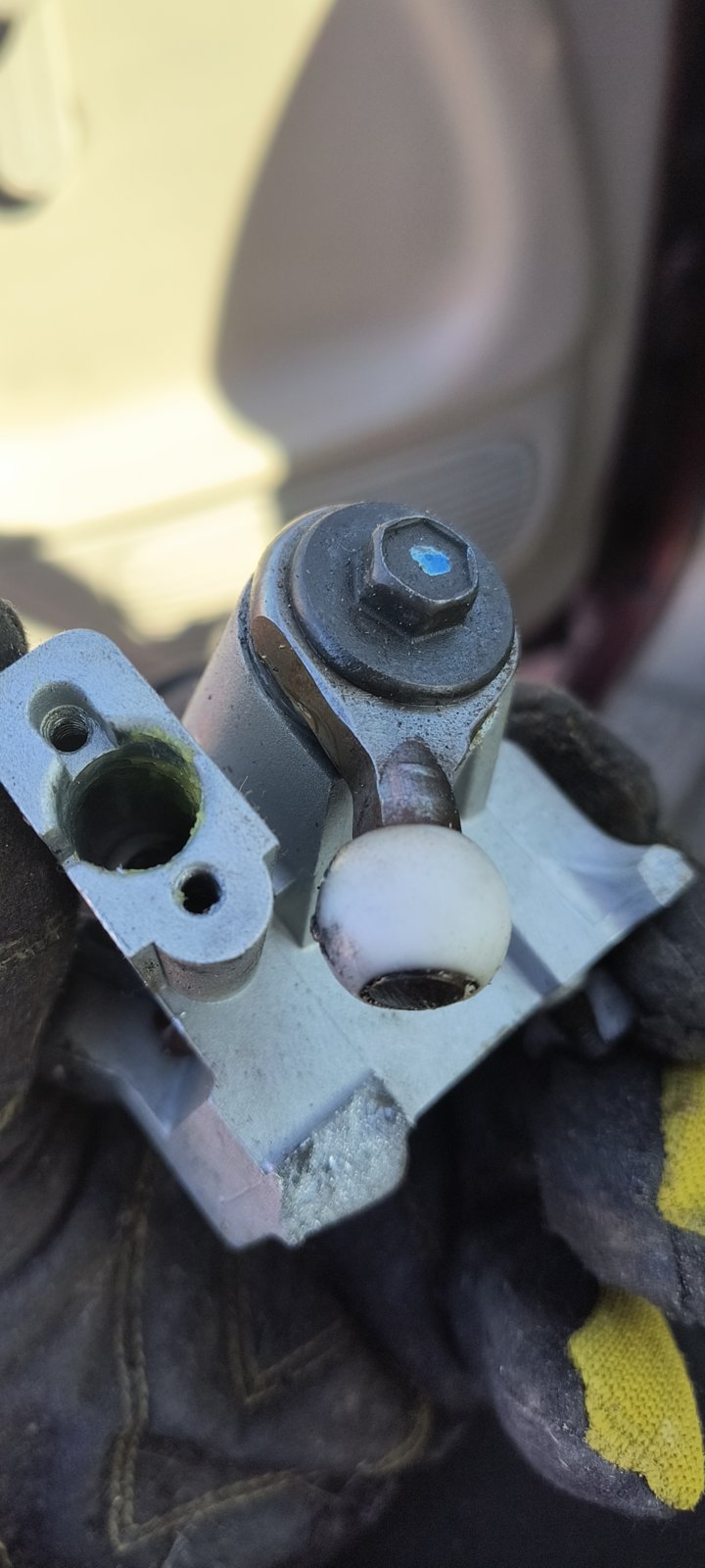

    05 tundra reg cab, 4.7 auto. for past few months been hard to come out of park and when out hard to move to reverse or drive. wont go into 2nd. and hard to go back into park, after drive around a bit everything frees up and works good. was thinking its just the cold weather. truck sat for a week, started up but wouldn't shift from park. put enuff pressure on gear lever that it snap the inside column. repaired it with jb weld. let it setup for 2 days and broke again. new shift column bracket on the way be here next week.
    question is... what would cause this. when i get new column gonna try lube up the shift linkage underneath. would the neutral safety switch cause this, is there one on a auto trans. truck starts fine, hit the brake peddle and it pulls back the pin in the column perfect.
    im at a loss, any advice to point me in the right direction would greatly be appreciated. tks geoff

    That's common for that bracket to break. It broke on me, and I had to pull the whole steering column to fix it on my tailgate.
    My shifter wasn't tight, or hard to shift like yours. I'd guess you'd need a new shift cable or to inspect the lever on the transmission.

    The problem is caused by poor casting on the support bracket, which is discontinued, and the driver slamming the truck into park. Very common failure, I think I linked it in the “MEGATHREAD” (‘So you just bought a 1st Gen tundra…’.
    You'll need a used assembly. Info on how to fix has its own thread on here: https://www.tundras.com/threads/shift-column-broke.80049/
    User Jack McCarthy has a detailed thread on TundraSolutions showing the repair I believe. And I think it’s linked from that thread.
    Stop manhandling your shift lever and make sure the linkage is not rusty (chances are it isn’t)

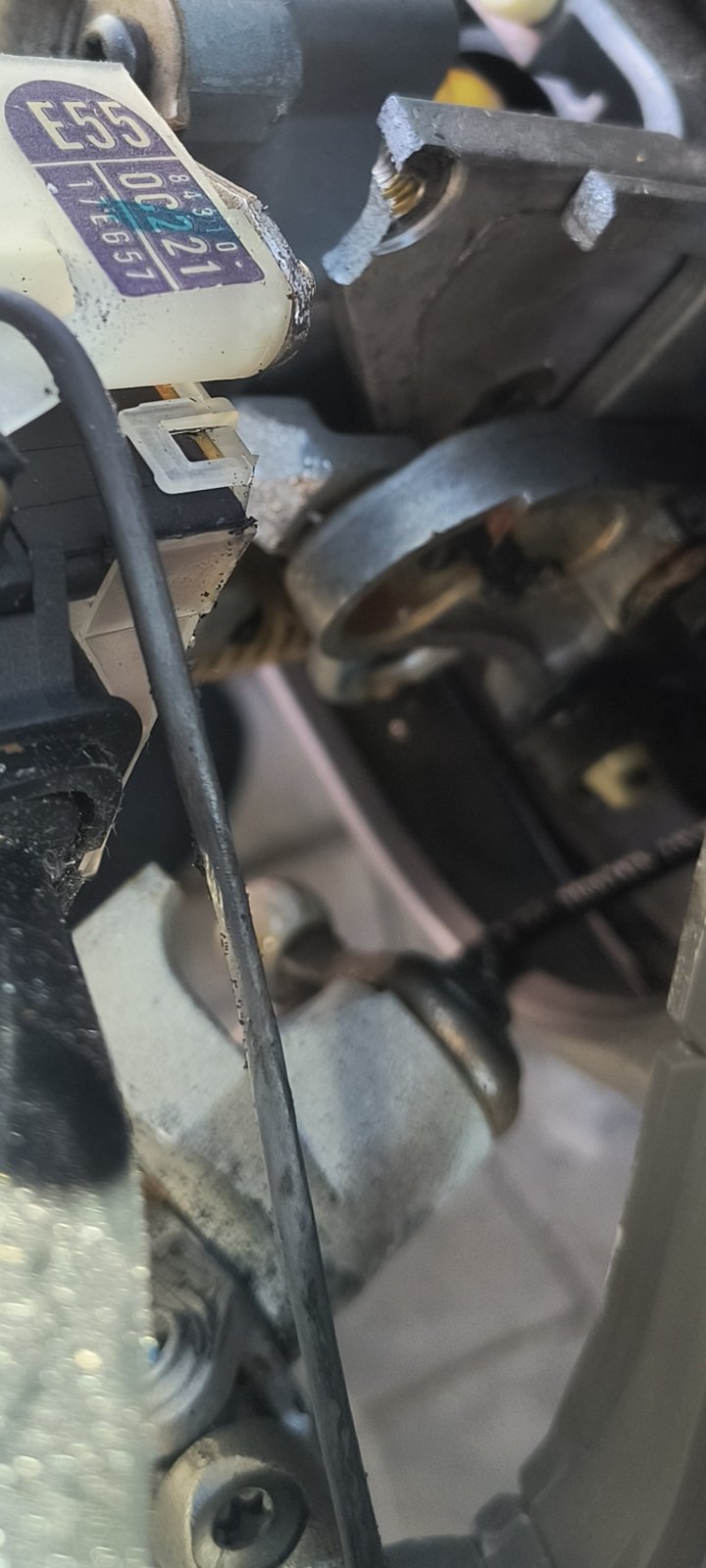

    Ok so I just went out and blasted everything including the neutral safety switch. Unhook the shift cable from the trans and it was free moving with no effort at all. The lever on the trans still wouldn't move. So started giving light taps with hammer, back and forth and it started to move. Got it to point I could move it with my hand. Started the truck and I can shift gears from inside using the broken column piece. Still bit hard to go in park but I can manage it. What's everyone's take on this " neutral safety switch". Have one ordered should be here next week. Tia geoff
