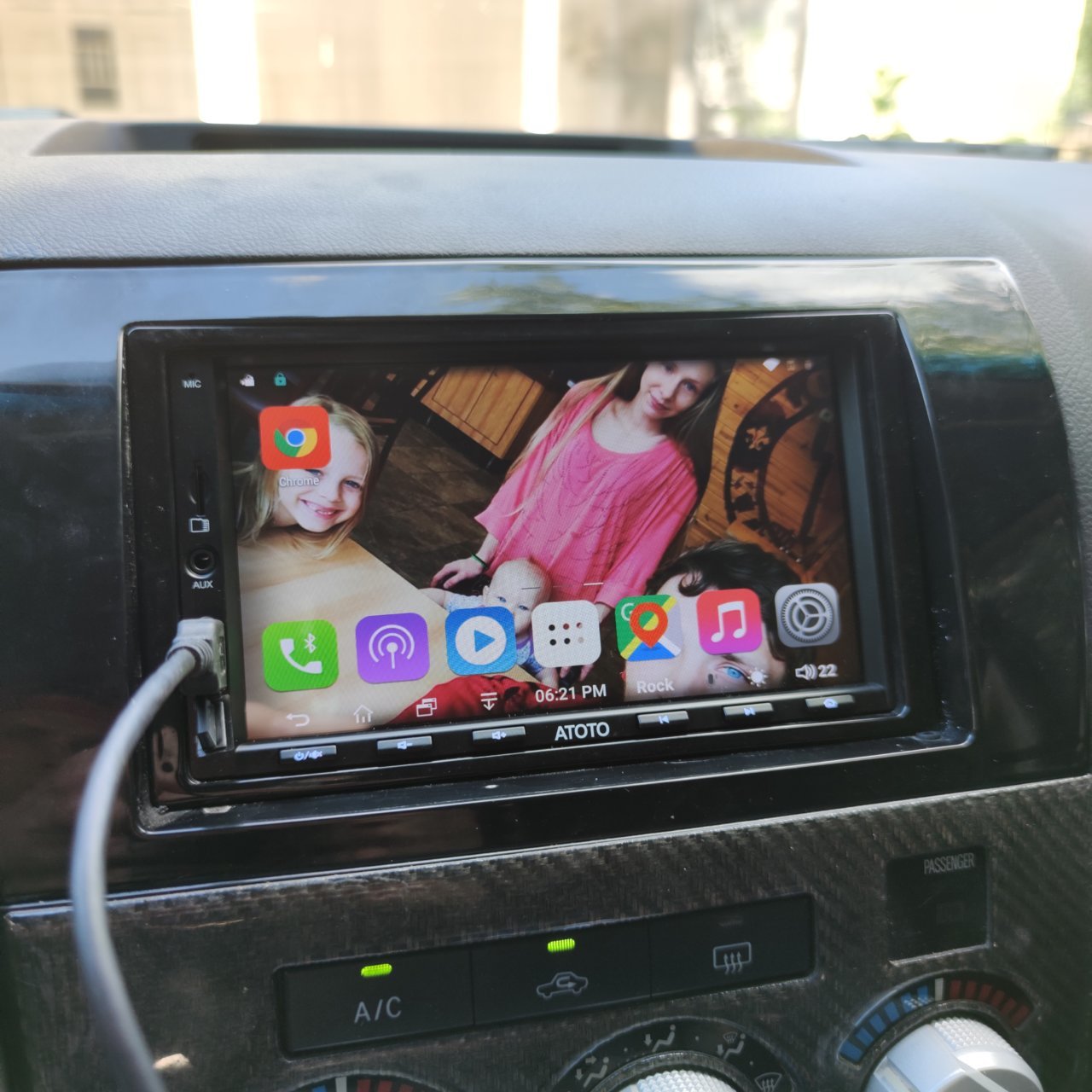

    Oh absolutely! I got my truck back around 2 this afternoon, the head unit is absolutely amazing, and for the price I have nothing but great things to say about it. I talked to Duval at Rollin sound and he said if I ever have questions and buy equipment from them he is willing to help me out, he said Toyotas can be specifically tough because there's a lot of extra wires that you might not need when converting to a different head unit, like the new head unit only needed one harness, gps antenna and wifi/USB outputs versus the four gps antennas from pioneers almost decade old Tom Tom system.
    All in all, today was a good day. I was given the choice to use a new modern axxess adapter, and because I bought the adapter Duval knocked forty bucks off labor, he specifically recommended this because the old axxess box was chopped, and with a new box it limits possibilities of a connector coming lose, and it'll make it easier for me to do soft upgrades in the future myself.
    A picture of the head unit, and the wife before she wanted to kill me for chopping up Tidra :rofl:
    I think mechanically in this situation I'll be a little better off until I learn some techniques and more complex wiring on newer model vehicles like Dr_Al said, I won't get intimidated and give up, but I was definitely knowledge checked by Tidra, and got very lucky to make friends with some very professional and understanding individuals at Rollin Sound!
