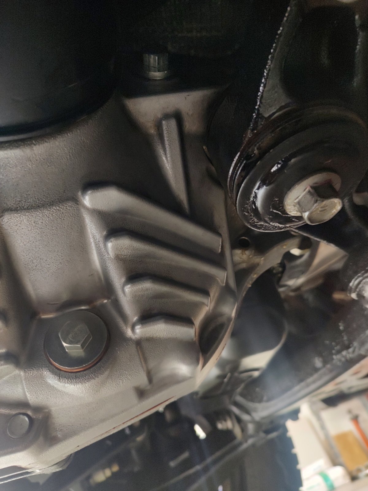

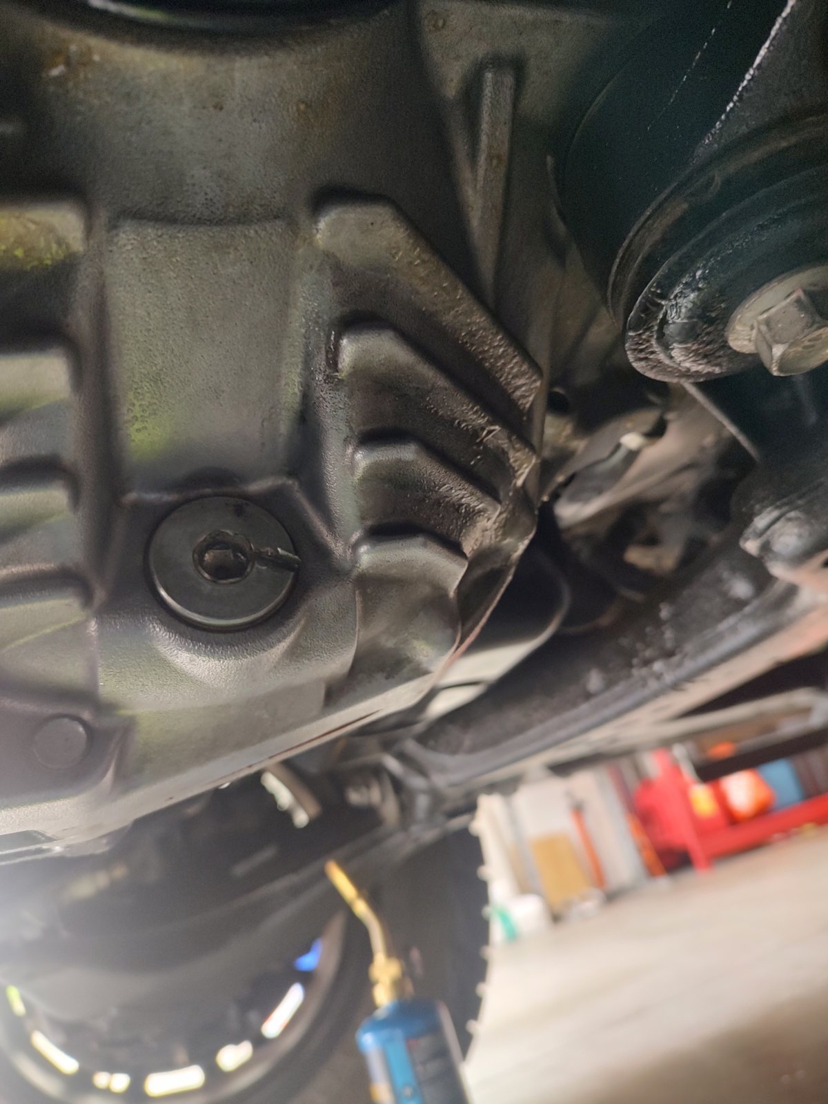

    I've tried breaker bars, hitting ratchet with 4lb sledge, heat, hammer and chisel, etc.
    What's my best next step?
    Take it to shop and ask them to weld a nut on?
    Try my air hammer w/ chisel after some more heat? (This one scares me a bit, don't want to slip and nick my diff case).
    Any advice is appreciated. I have Lexus plugs with the hex head ready to go in, whenever I get this pesky sucker out.
    *Ignore the fluid film residue in the vicinity*

    Insert the hex socket and give it a few good whacks to basically jam it into the hole and slowly wrench it out. Probably ruin the socket but thats easily replaced
    Otherwise welding the nut on would be your best chance at this point.

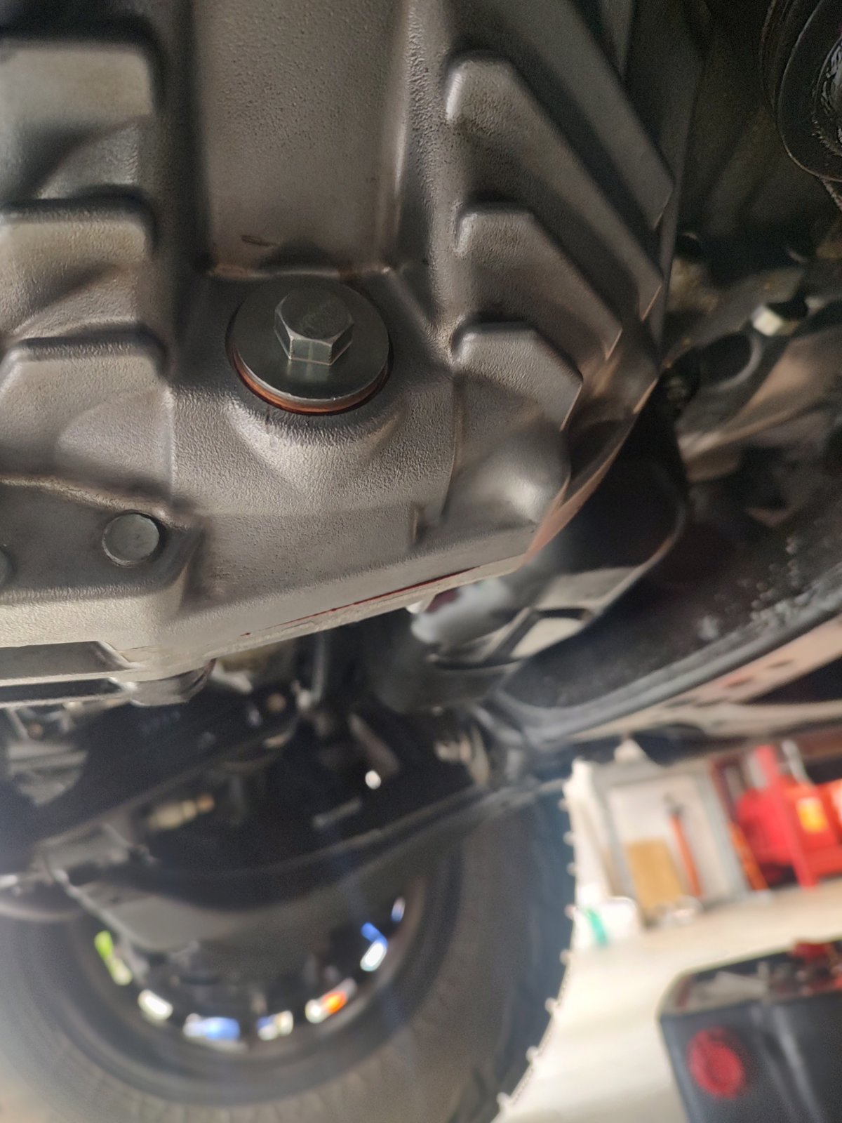

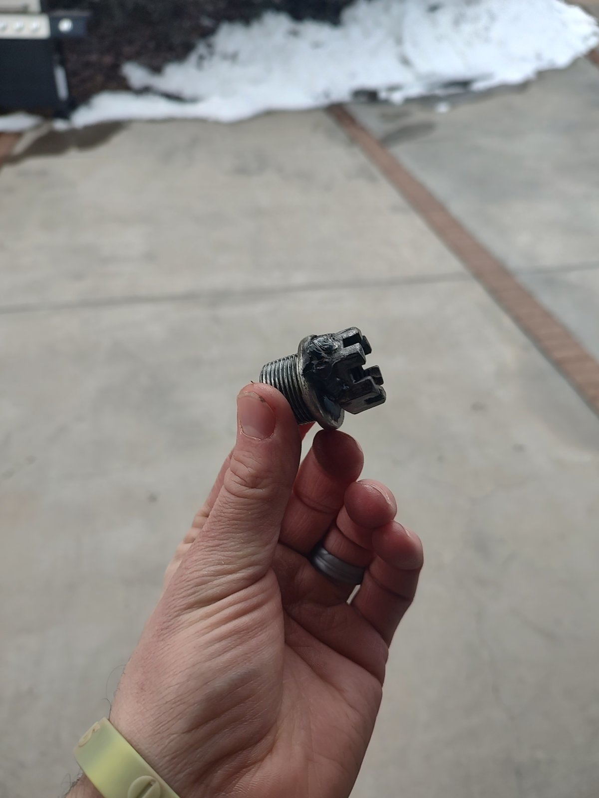

    Ok, so I got her off. Decided to just put the fill plug back on and drive to a local welding shop. Guy charged me $20 to weld an old castle nut I had lying around onto the drain plug.
    Now it looks like this with the Lexus replacement plugs:
    Why on Earth is Toyota still using these Allen head plugs?
