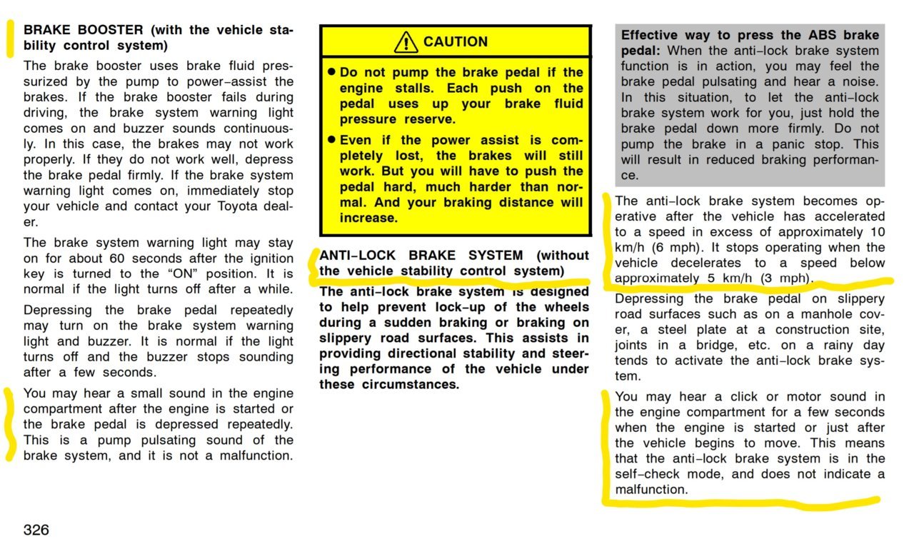

    Not sure if you have VSC or not, but they both make noise, which is normal. From the 2004 Toyota Tundra Owners Manual:
    Toyoda Tundra[OP] likes this.

    Awesome! I was able to find it on my manual last night! That could be it, I just have never heard it before and I don’t remember ever hearing it till recently. I wonder if there’s something going on with my steering rack, I will continue to inspect and come back if see something weird.
    dinosaur[QUOTED] likes this.
