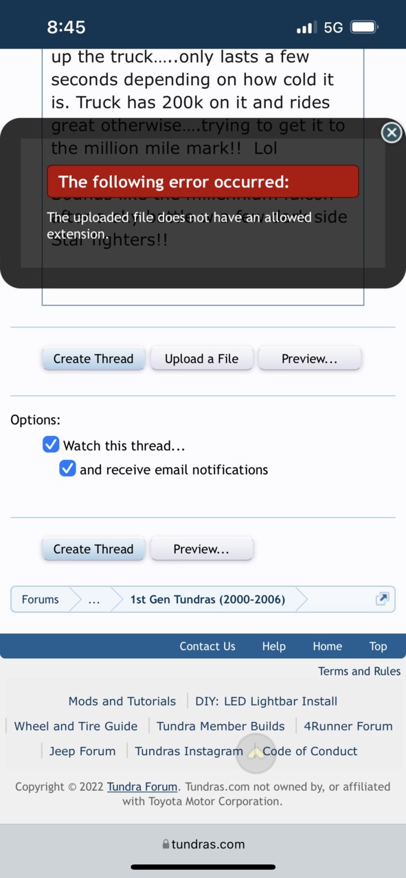

    I tried loading a short video (about 3 seconds long…after longer videos would not load and I got a pop up it couldn’t do it). Sound goes something like an air compression system loading up.
    Also….anyone know how to load a video…I think it said there is a 20 Mb limit?? 3 second video shud not be more than that.
