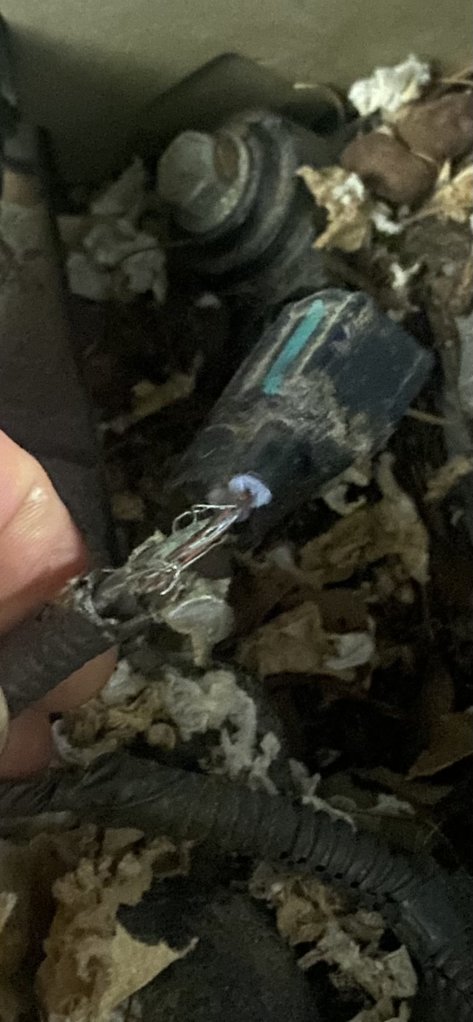

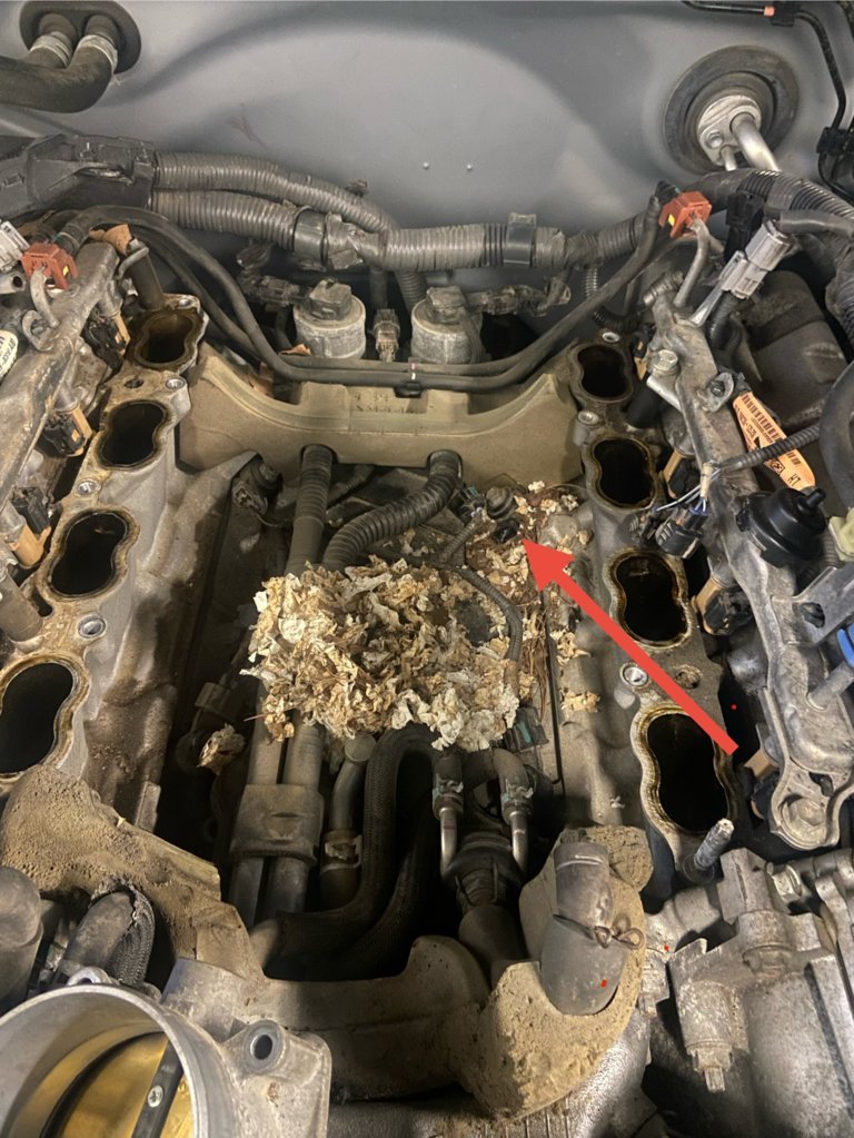

  4. Jan 6, 2025 at 4:02 PM
    Buckwalleye
    Buckwalleye [OP] New Member
    Oct 22, 2018
    #20822
    49
    2018 TRD double cab
    I know this post didn’t get much traction. But for anyone curious, there was a nest under the intake manifold and the knock sensor wire was chewed. Dirty b@$tard$. Here’s some photos for reference of where this is located. Is was a real bugger to get the manifold off. The harness closest to the firewall was quadruple taped, and zip tied, and clipped from the interior side of the firewall. That needed to come off to remove the manifold. IMG_1361.jpg IMG_1365.jpg
