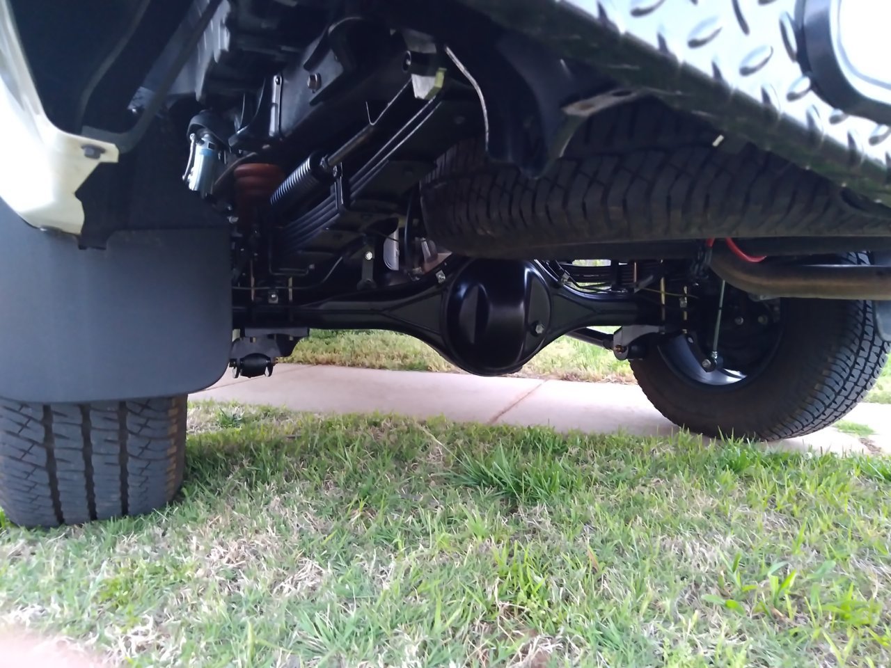

    46 gallon tank Super springs 1600lb Tow mirrors Interior/Exterior LED lights
    I tow a Flagstaff 29 BHS, it's about 9800lbs dry and approx 900lb hitch weight.
    I run a Curt 17500 weight distribution hitch and I added 1600lb Super Springs to my suspension.
    Trailer and truck are level and the truck pulls like a dream.
    Bigboitundra and aukaiiki[OP] like this.

    2020 CrewMax TRD Off Road
    That’s like 300 pounds of extra payload weight down there lol. Nice setup though

    Dan
    Key is down there, reduced center gravity is a good thing. Not to mention traction when empty. Also nice to keep headlights in focus.
