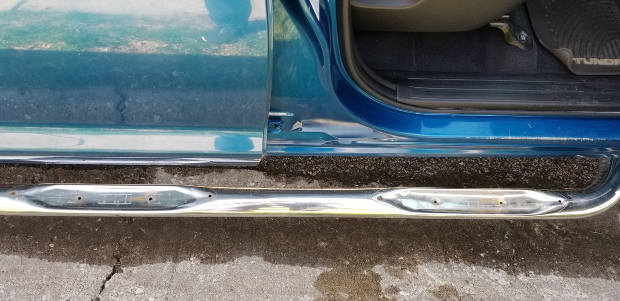

    I ordered some step pads on eBay that looked like they were going to fit my step bars and they are about 2 or 3 mm too short for the holes to line up. So in other words they are garbage. Is there a reliable source for new step pads because Amazon has thousands and I just don't trust ordering online anymore. Maybe do I have to go to the dealer?

    I don't know. They came with the vehicle and I don't see a brand anywhere on them. There's only one pad left on it and it says "Big Country"

    Well, I would do one of 2 things if I was trying to fix this this on the cheap. Best way is to install rivnuts into the existing holes, drill corresponding holes in the new plastic pads you bought, and screw them down. Of course you need a rivnut tool for the first method. The easiest way is to tape the new pads in place temporarily, drill through them and through the bars, and install with long enough screws, and flat washers and lock nuts on the under side.

    When I looked for replacement pads for the bars on mine, Aries step bars, the replacement pads almost as much as just buying new bars, like 2/3rds. So I just bedlined the bars, pads and all and it has been fine.
