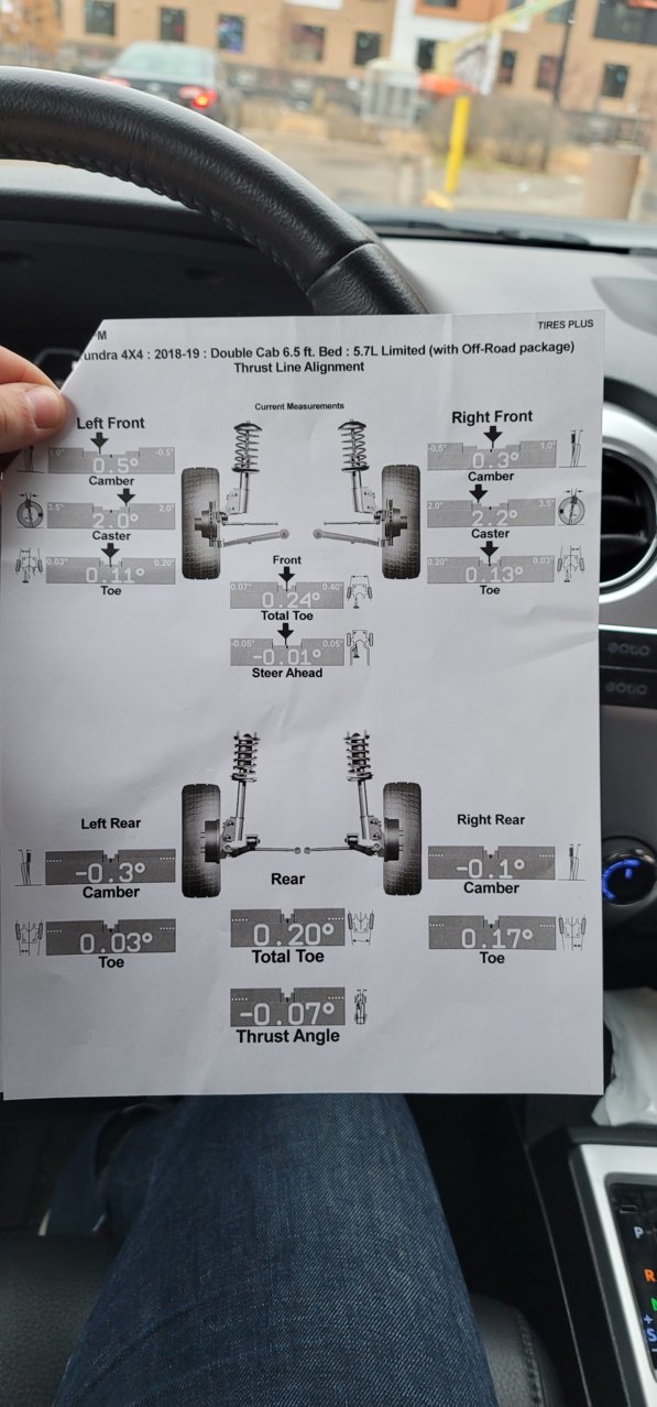

    Hey everyone, Since I've bought my truck, the steering wheel has been at an angle. I've had the truck aligned, tires rebalanced with no luck. No matter what I do, when I put the wheel perfectly straight, the truck goes slightly left. Has anyone else had this issue or are tundra's naturally like that? It drives me nuts and I'm looking for a solution.

    Thank you, I've spoken with the dealer and they told me the toe in the rear cant be changed.

    Dumb question here, are all those angles supposed to be zeroed out?

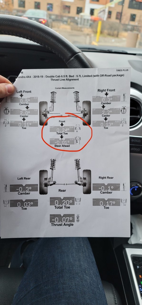

    The toe I'm talking about is on the front axle.
    That would be the thrust angle, and I can be changed if severe enough. Most of the time it isn't a factor.

    24 total toe is in the front though.

    So basically from my alignment sheet, the trucks technically aligned, but the steering wheel is crooked?

    The Total Toe of 0.24* is perfect. The Total Toe is the sum of both left and right individual toe readings. You front readings are set up perfectly. The rear is not adjustable. The tech did not test drive the truck after doing the alignment to verify the truck tracks straight and that the steering wheel was straight. I would have taken it back and have them fix it.
    The answer to the other question, the truck was aligned to the spec. and the spec is displayed on the bar graph, so adjusting to zero will put it out of spec.
